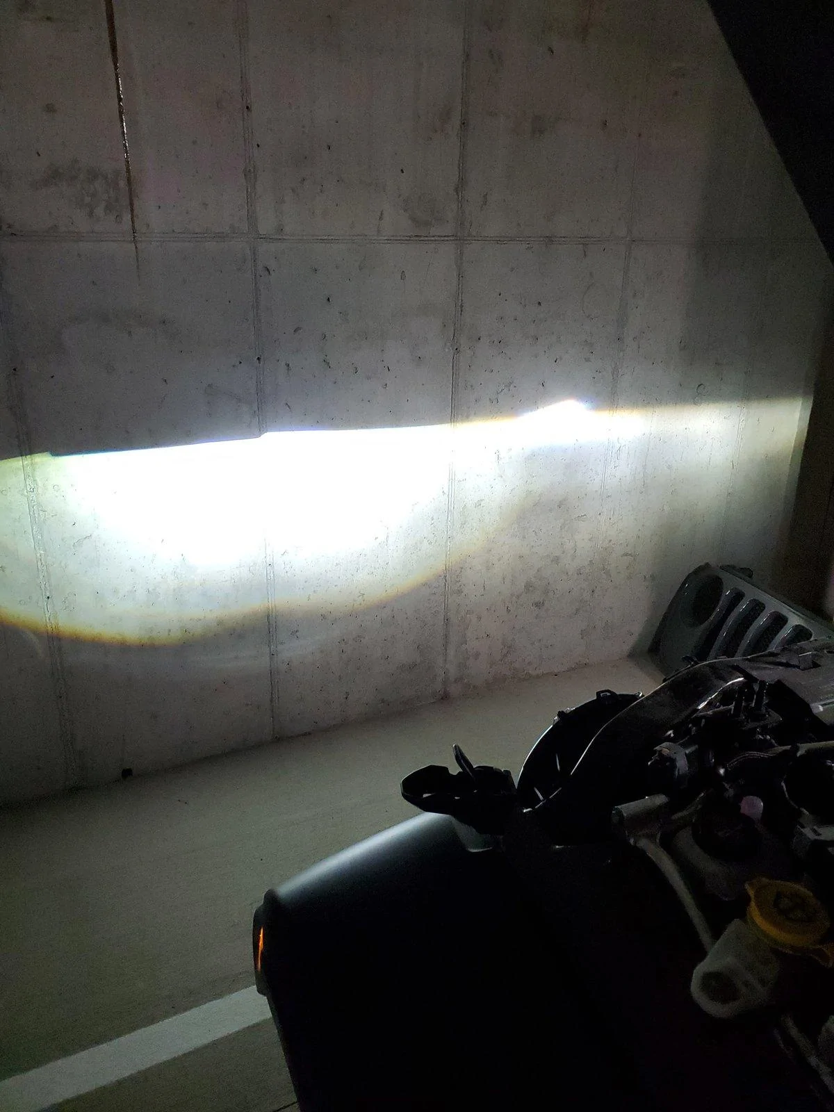

For reference, on the right is the Quadratec LED option (I believe done by JW Speaker and rebranded) which is about the same lumens as the stock halogen but much more white in color, on the left is the Oracle Oculus 9". Pretty clear which is the better option.

can we see more pics of your headlights? very interested in getting the oracle headlights
