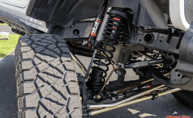

Was in rush and stuck the resi’s here after installing the bumper they didn’t work in original config. Fittings and shorter hose thought about making them pb
I know this is old but in case you’re still active… did you leave it this way or did you do something else?
