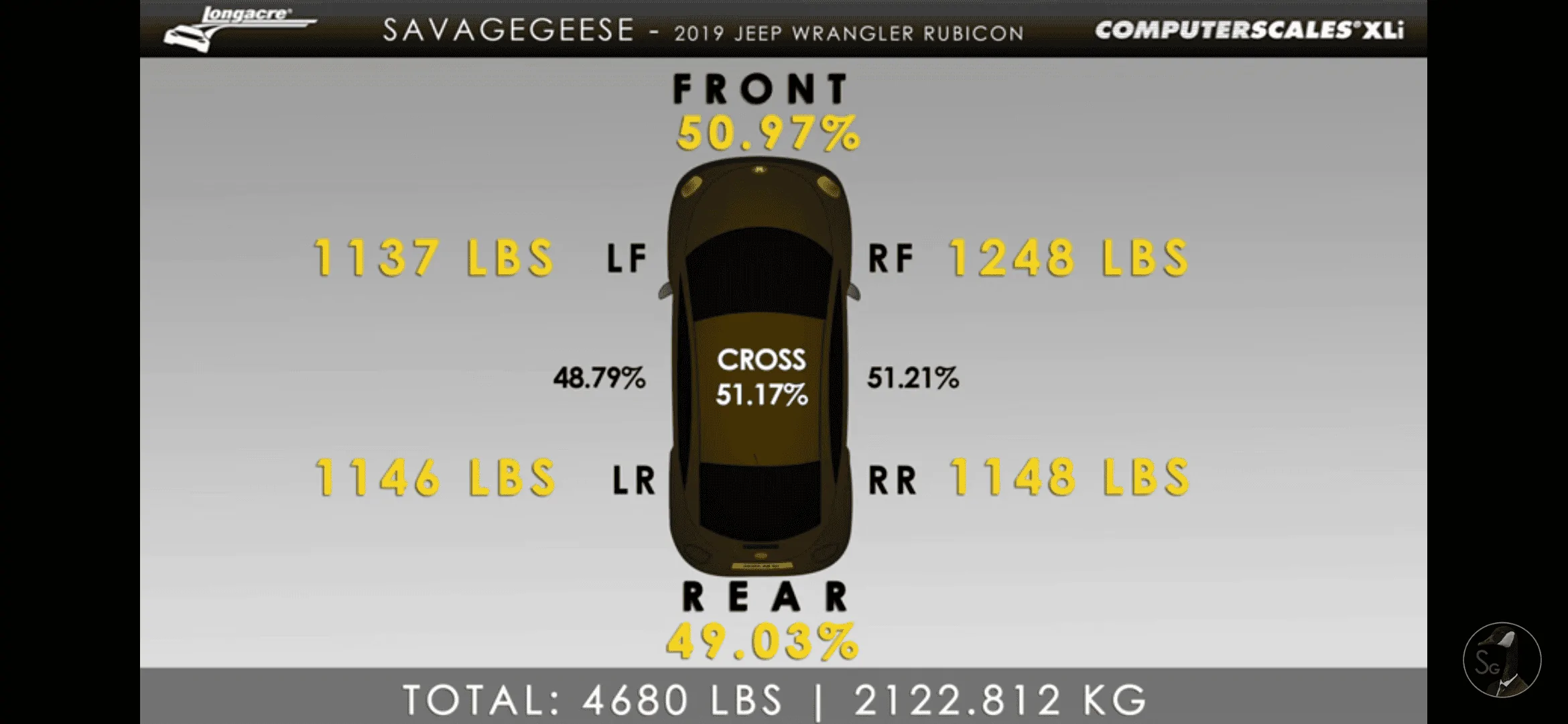

By the way, this is a snapshot of a 2019 JLU Rubicon 3.6 8AT weight distribution.
Not so typical, huh?

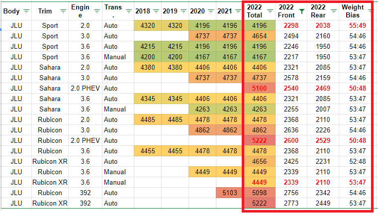

Before anyone gets on me: I don't disagree that the front shock valving needs to be different than the rear. There are also likely some benefits to having the option to mount a rear shock BODY on the front, assuming it's valved correctly for the situation.
Dang... that's pretty close to 50:50. Was this stock or with aftermarket wheels? The heavier spare would make the rear heavier.
The official specs (which don't account for hardtop/options/accessories) show a JLUR 3.8 auto at 53:47 weight bias.

*Inconsistent Stellantis information
