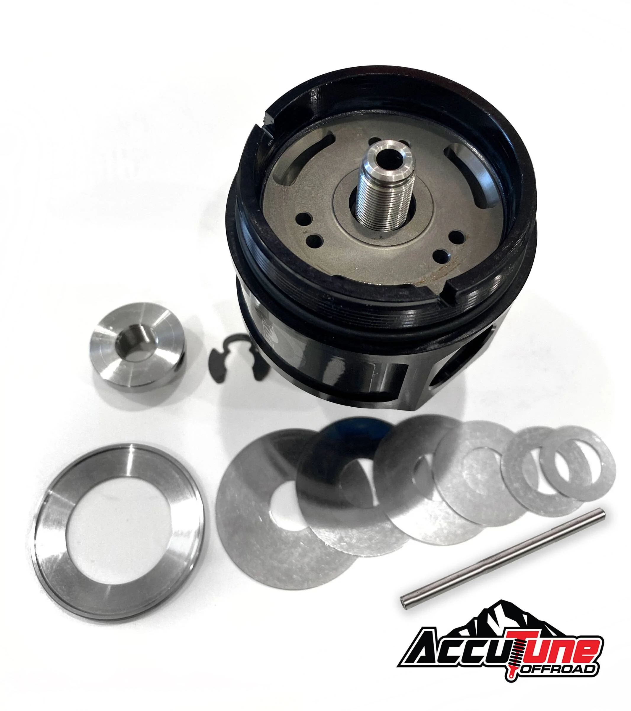

We open the shocks and revalve the main piston prior to going out. We do not make adjustments to the DSC knob, thats actually very very in depth to do. We've had rare cases where the c-clip holding things together has either broke or was not seated properly and has come undone. Hard to catch since it's so far inside the shock. Unfortunately for us, this is not a simple fix at all, and requires the entire reservoir to be taken apart. We wont know exactly the issue until we open it up.
For those interested, I put together a very detailed article showing how these DSC internals go together. If you look closely you can see this clip I am referring to:
https://accutuneoffroad.com/fox-dsc-adjuster-assembly/
That's a great photo, I have mine apart and I just added a .15mm X 1.1OD today.
