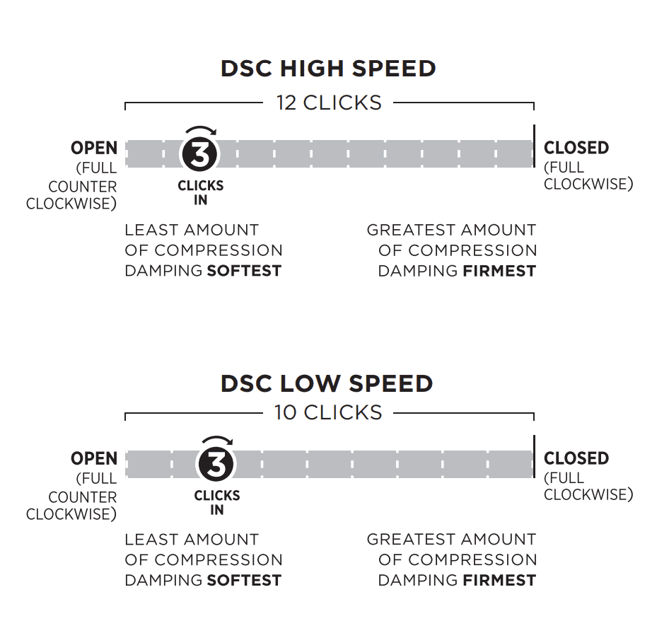

I have a a couple questions about the DSC adjusters. The instructions say to turn the knobs counter clockwise all the way until they stop. Then 3 clicks clockwise is the softest setting for both high and low speed adjusters. But if you look at the diagram it's really just 2 clicks clockwise to the softest setting.
Based on the diagram, all the way counter clockwise is the first click. So the softest setting is really just two clicks clockwise from all the way open to the softest setting, at least if you go by the diagram. Does anyone know which is correct? Also what happens if you don't go all the way to the third click? Simple logic would say that the further clockwise you go, the softer it should be. But is this true? Is there any reason you shouldn't go less than the three clicks in from all the way open?

I open mine up all the way ( counter clockwise) then turn it clockwise to the first click, I consider that to be 0. To me that’s the softest setting… I can feel it firmer 3 clicks in…. Mine are almost 5 years old so they may be different now…. When mine are all the way open ( counterclockwise) they’re not in an indent I have to turn them a little to get into a notch… Right or wrong I’m not sure but this is how mine work….

The 3 clicks in their diagram is the setting they claim they are shipped as. Weather or not thats accurate is up to you to see. That is not the softest setting.
The softest and firmest description there is just to tell you whats going on with knobs, not related to the specific setting they have shown. All the way counter clockwise is the softest setting. The adjuster is all the way open, allowing for the least amount of oil restriction. Firming up the compression restrict oil flow into the reservoir making the compression firmer.
We would suggest starting at the softest setting, then firm up from there.
I would agree, that Fox should explain a little more on when & why to make changes. Our video below will help with some of those questions:

Yeah three clicks in is just their recommended setting.
I definitely run mine softer than click 3 for high speed and low speed while on the street.
Also, idk how new yours are but when they are brand spankin new they can be quite stiff. They absolutely soften up over time. I remember when I first got mine I was like “maaaaaan this is the softest setting?” lol. After one solid desert trip they were noticeably softer. At this point they are super soft when set to 0.
Anyway, just a heads up in case you’re like “oh no, what did i buy”

The way the instructions read it seems like you need open them all the way, and then turn them clockwise 3 clicks to the softest setting. This seems very counter intuitve. And of course I interpreted the instructions incorrectly.
I got the shocks from Accutune (thanks Mike!!) in early January. They were an immediate improvement over what I had (BDS Nitro NX2). I got a MC lift the first week of Nov and I wanted the DSCs and to do some of the work myself so the shop recommended the BDSs as a cheap temporary solution. It felt like you could feel every electron on ever molecule of every pebble that makes up a hard surface road. Ok, a bit of exaggeration. I'll just say it did not ride well.
So needless to say that the DSCs were an enormous improvement, even at 3 clicks in. But then my Jeep was at the Dealer for warranty work for the better part of the last month. Now that I have it back it seems much more stiff than stock; I think I got used to driving my wife's Sahara 4xe and a Cherokee loaner, both MUCH softer. I'm going to go adjust them now. I wonder what they'll feel like on my commute in the morning.

Sorry if I gave the wrong impression. I am very happy with the 2.5 DSCs. All I was saying was that after driving something with a much softer ride, the 2024 Jeep Cherokee especially, going back to my Rubicon the shocks seemed quite firm. But they're far from bad.
I did adjust them to the softest settings last night and they were noticeably softer today. Still firm, but not uncomfortable or harsh by any stretch. I was very happy with them they were 3 clicks in. I'm even more happy now that they are on the actual softest setting.
