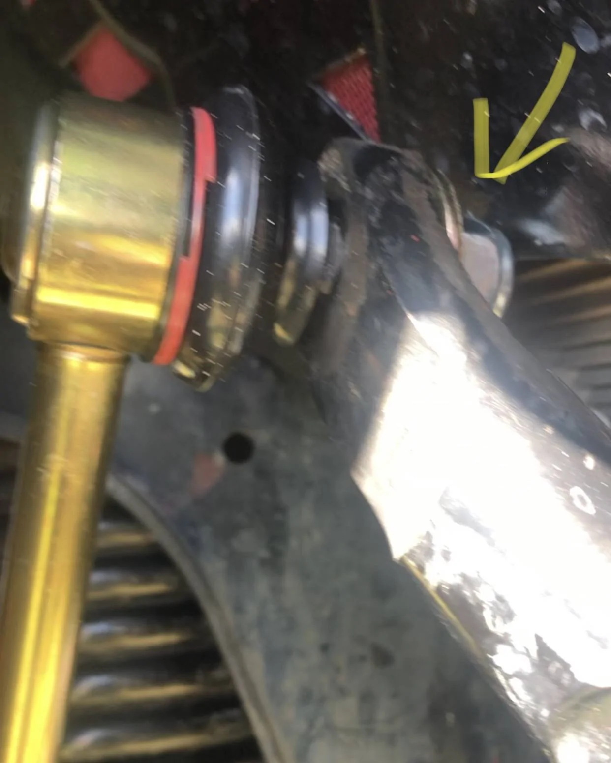

I'm surprised the sway bar link was the big hiccup. Nothing against your setup, but this can be overcome without needing to use rear shocks up front. Just wanted to chime in on that note so no one should be second guessing buying the standard front Fox 2.5 DSC shocks. We've installed a few of these now without any issues using our adjustable sway bar links.

You're right, could have gone with a shorter / adjustable link and we considered it, but I think that equates to limiting down travel and making use of the MC coils. No? Considered that the adjustable valving mitigates largely whatever valving difference exists (front remote vs rear piggy). And I considered that if the valving were just god-awful, well shops like your exist and I suspect can dial in a valve regardless of remote vs piggy. It just didn't seem like a painful trade-off, and we indeed started with the front remote resi and the shop spent some time test-fitting and considering options and trade-offs.

The suspension would need to be cycled properly to confirm what length is needed for the sway bar end links. Since there are a variety of lift heights, we make ours adjustable to make them just right. Yes you don't want them too short for a few reasons. Most of the time, the sway bar will sit pretty level at ride height if they are setup properly. See below (392, MC kit except for springs).

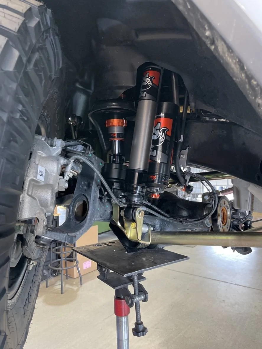

Some test fittings pics with dsc rears up-front. You can see here that more bump pucks are needed.
And flexing it out …
mt zion did lots for me here. The MC lift and fox shocks, fox front hydro bumps, MC steering and track bars, Woods front and rear shafts, RCV front axle shaft (rear is stock). 4.88 gearing. LOD signature rails. Control arm and shock skids, diff cover and skids.
Just a great shop to work with. Pics and texts and calls throughout everything. I live in Virginia with 5 or 6 shops in proximity, but I drive the 100 miles to Mt Zion and will continue.
I daily drive this and weekend trail it. Need a bellypan before I take it to Rausch Creek probably, but there are trails in the area that I can have fun on without risking my oil pan. I’m 99% sure im going with Artec kit, just saving my nickels.

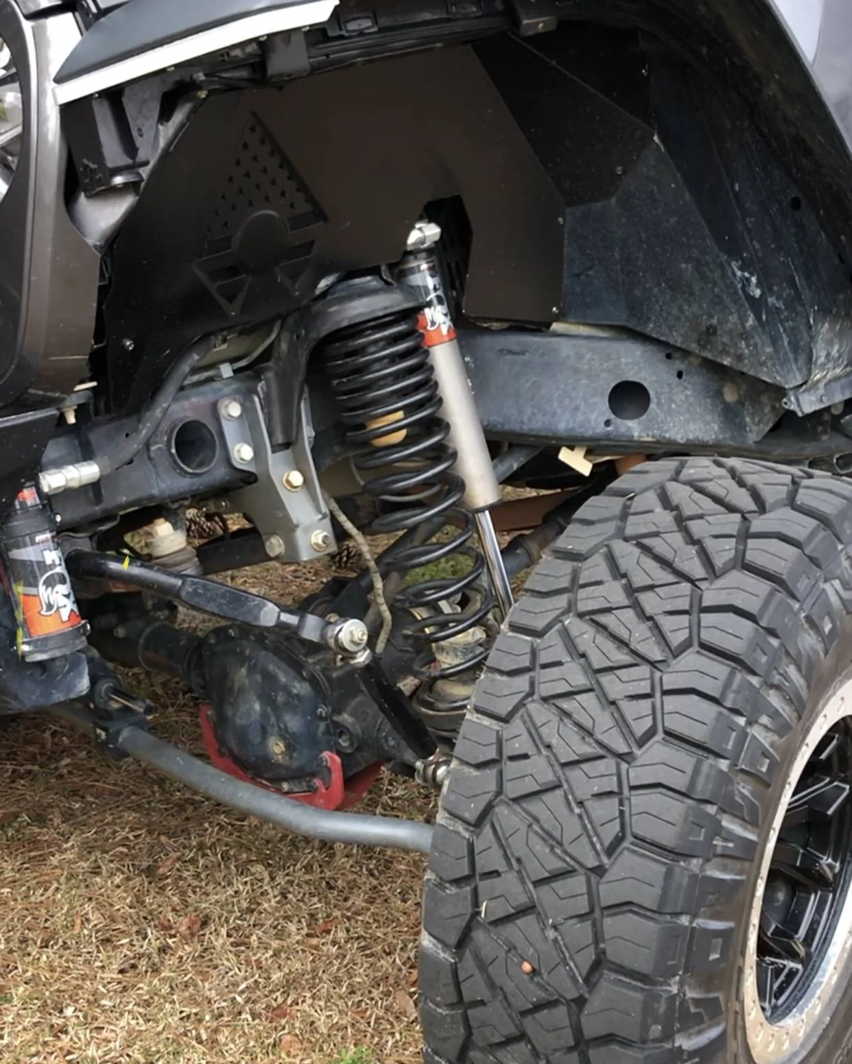

Nice job on your rig….. I’m still trying to wrap my head around why not just move the resi hose out of harms way…… I’ve got long travel shocks and I’m currently testing MC sway links, and they do not hit my resi hose
Jeep Wrangler JL Fox DSC rears in front? C96A4060-6E04-4255-A5E6-29052E1DE307
….here’s how my hose is routed….
Jeep Wrangler JL Fox DSC rears in front? C489D566-88B5-4301-984F-488472DB3B9F
But hey, more than one way to skin a cat…… Nice work……
