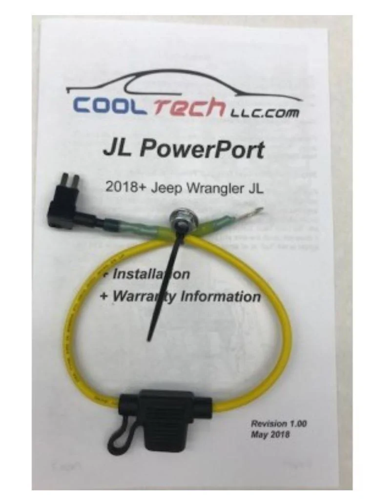

Can someone please reiterate how to keep a JLU in ACC mode when flat towing? Mine keeps timing out after 20-30 minutes, thus turning off 12v power to the RVI brake.
We use a Brake Buddy for flat towing and I just purchased a 12V extension cord so I can connect in to the rear 12V plug as it is constant power. AND it was cheaper than the cooltech thing.

Bringing this one back from the dead. Just upgraded from the RVi2 to the RVi3. Seems to move around a bit on the floor board so I am going to buy their phantom bracket. My question is on the 12v outlet. They are saying not to use the rear port as it is not consistent enough power. Has anyone had a problem with using one of the factory 12v ports? Not sure I really want to wire something else through the fire wall if I don't need to.
You want to hardwire in a new power port. I leave mine coiled up in the glove box. You need enough wire gauge to handle the power requirement of the compressor in the RVi brake. Those factory sockets are lightly wired. The front ports are not hot with the ignition/accessory switched off.
Also, you need to wire in power from the tow vehicle for extended towing. I learned the hard way that the RVi brake will suck juice like a 50lb toddler leaving your jeep battery dead in short order and giving you weird brake phantom issues as it dies.
I found a thicker gauge direct wire socket on Amazon for $17 and ended up installing it. Prior to that I was getting the "low voltage" warning with the extended socket running from the rear outlet. After installing it, that warning immediately went away. So, for my rig it did make a difference using the hardwire kit.
