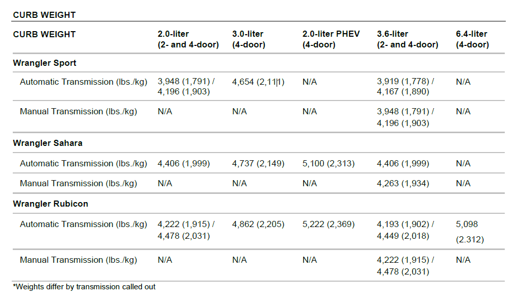

Just a note. While most of the time you can determine curb by subtracting payload from GWR, doesn't appear to be the case with Wrangler door stickers. All 2 doors have one payload, and all 4 doors have another, which obviously isn't accurate.
Best data I've found is Product Info Sheets from Stellantis, I don't see a 23, but here's the 22 one I normally look at. Even these appear to have errors, though.
Jeep Wrangler JL Flat towing Weight 1682368200278

Those are dry weights without any options or gas. I believe they are with soft top as well. My JLUR weighs in at nearly 6,000 pounds with skids, bumpers, and 37's.
