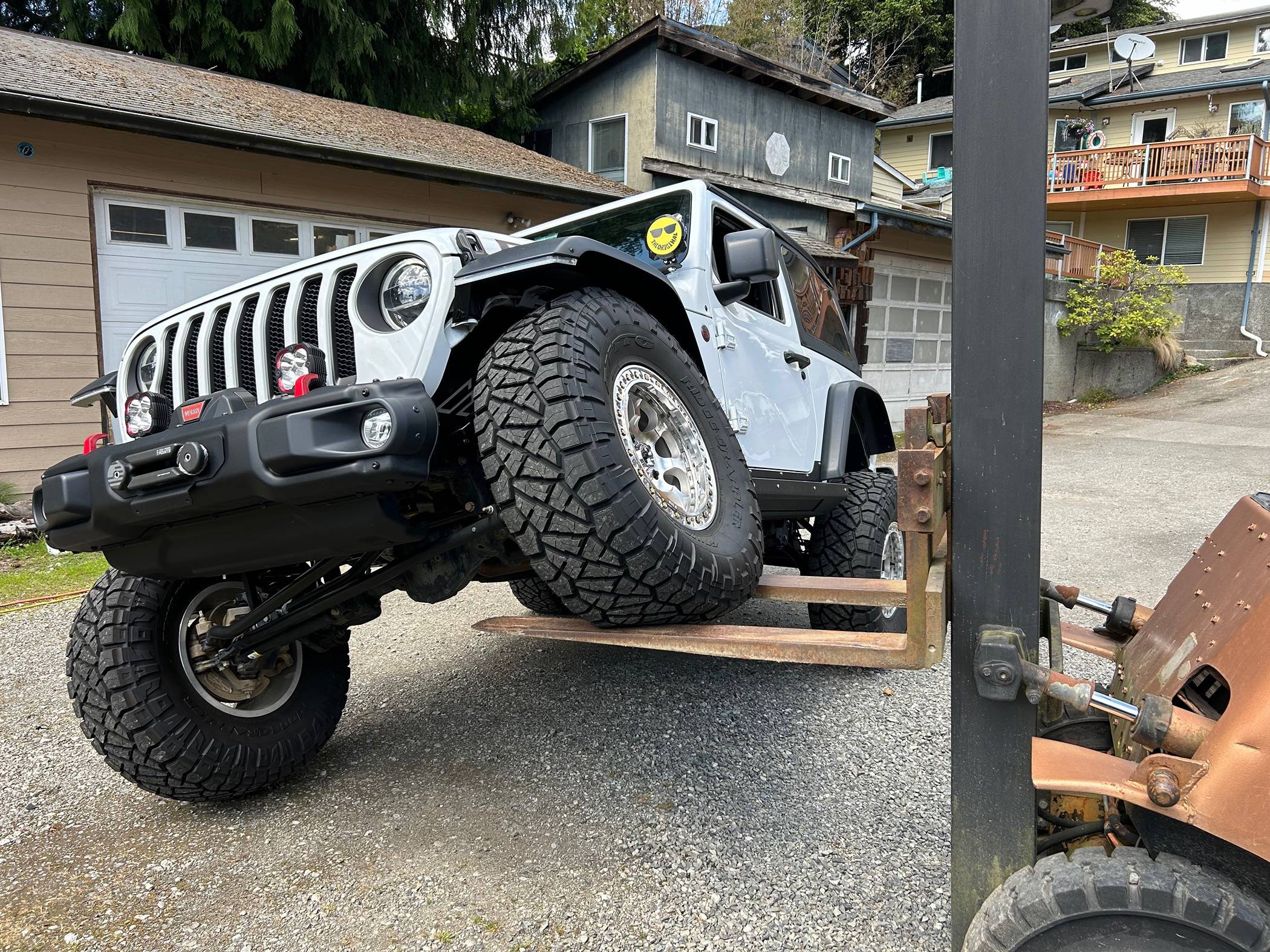

Yeah, that looks like normal amount of bumps for that kit and the RRD shocks, my guess is that it reconnected on you….
This makes sense. Well looks like I got to see how much flex I get with sway bars connected!

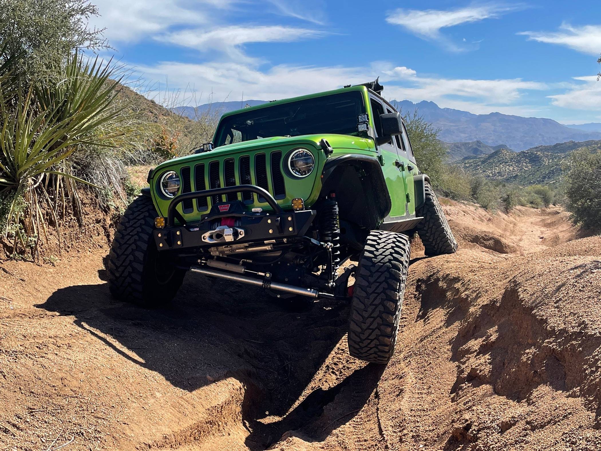

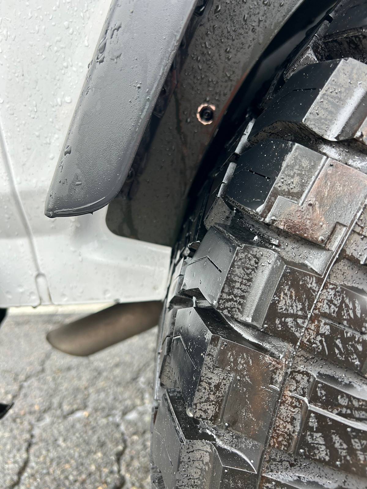

Yeah, make sure the front is moving. The RK setup flexes a ton, even with extra front bumpstop pads. I’m running 2 pads, any less and I’d really mash the front tire into the GenRight fenders. Tires already rub the fenders.

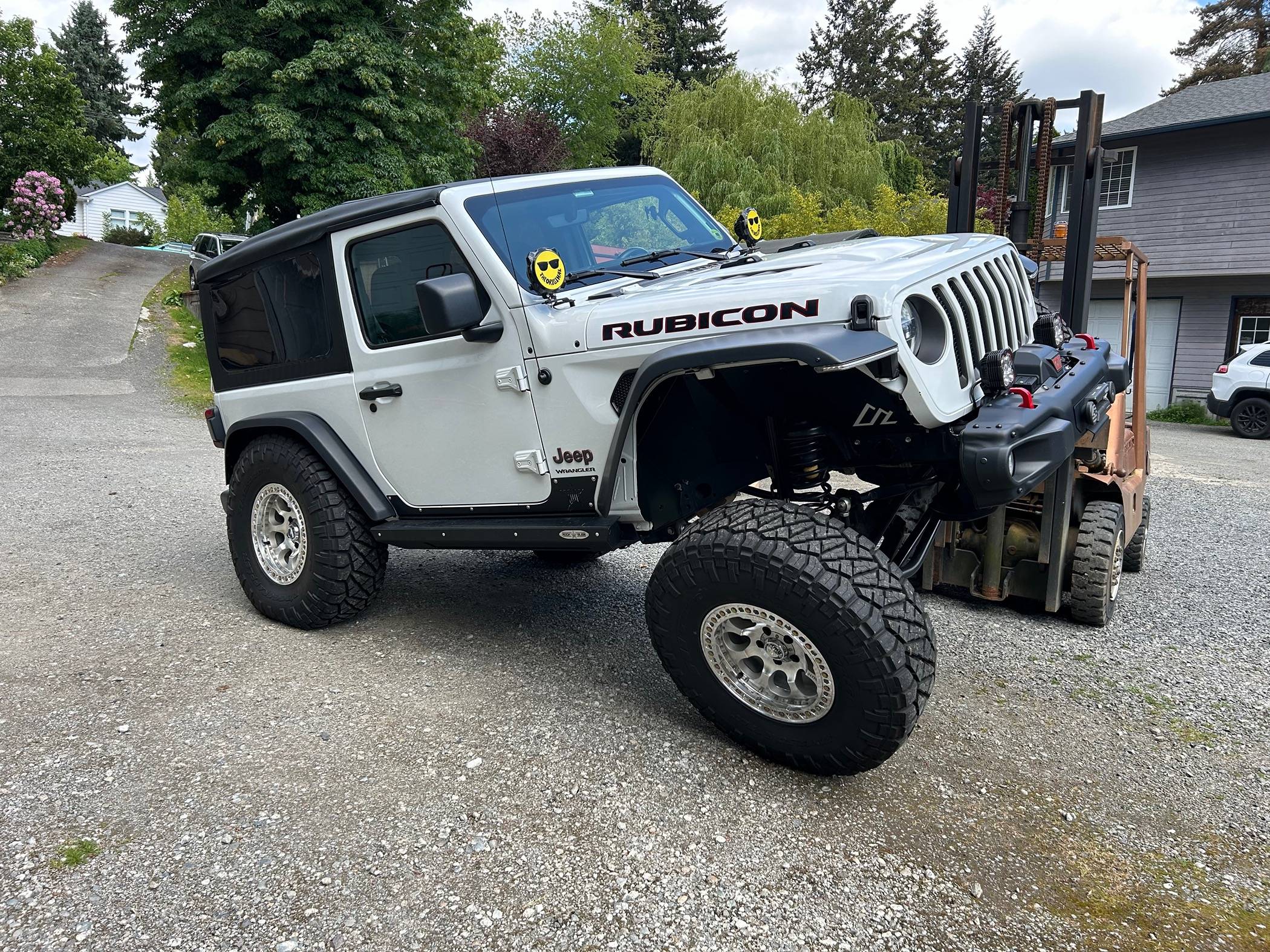

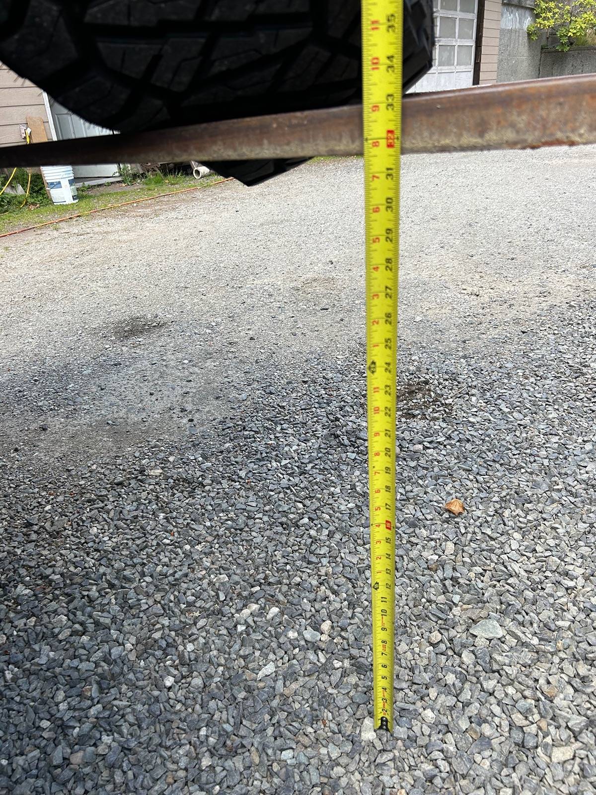

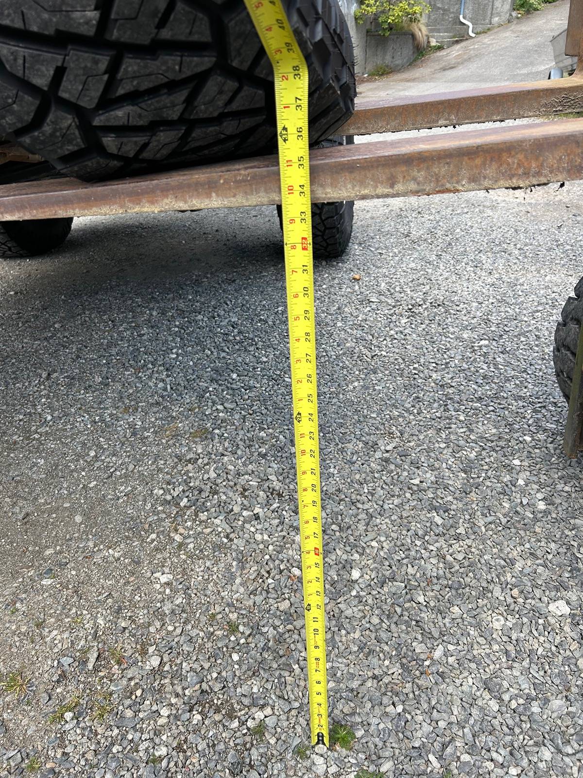

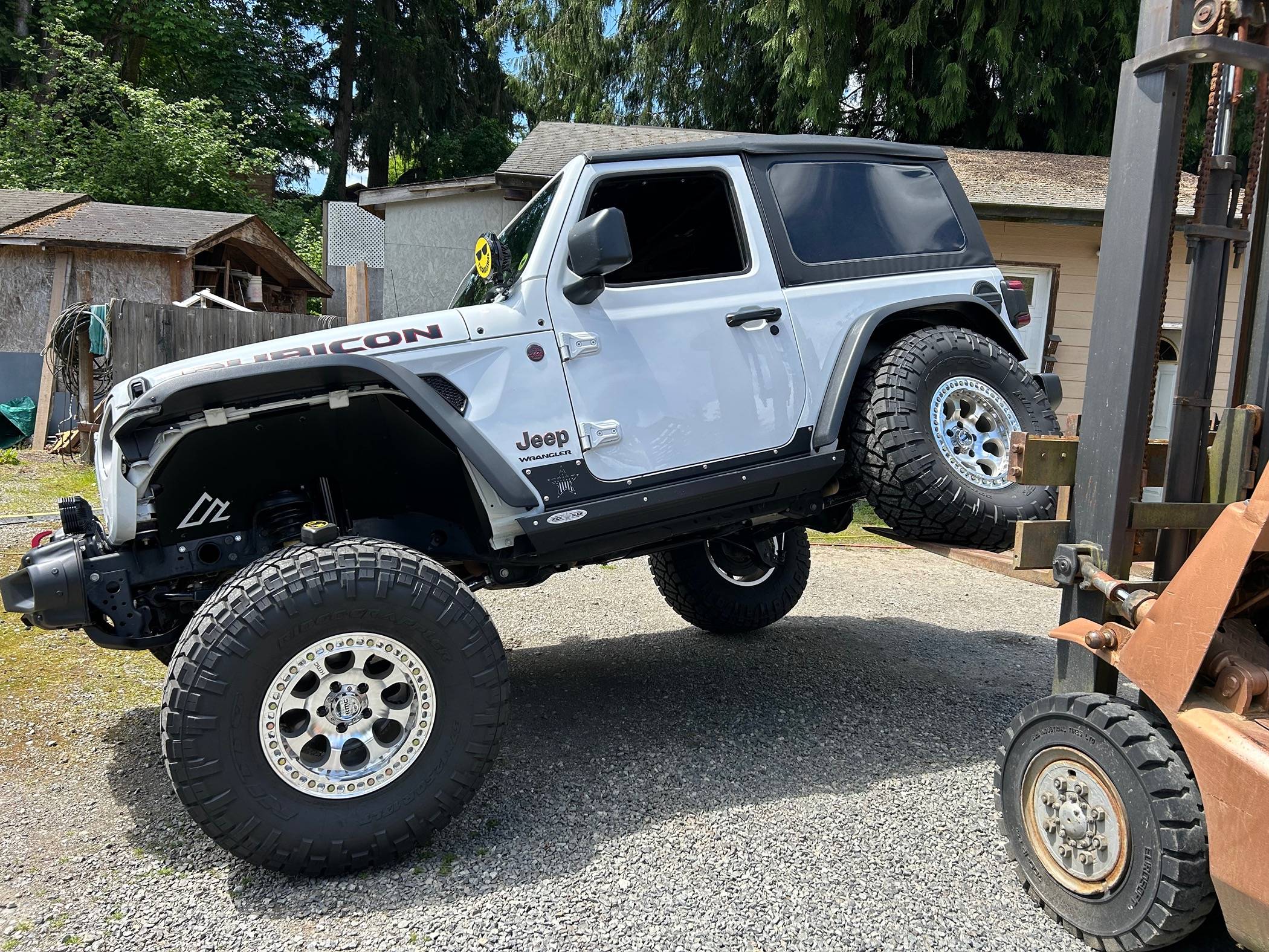

I flexed out the jeep again with the sway bar disconnected - for sure - left the engine running. (Even in 4lo, it reconnected with engine off!?) Anyways the results were much better.
Front 33.5” to bottom of fork
Rear 31.5” to bottom of fork
Jeep Wrangler JL Finally flexed it out with a forklift IMG_3797
Jeep Wrangler JL Finally flexed it out with a forklift IMG_3799
Jeep Wrangler JL Finally flexed it out with a forklift IMG_3798
Jeep Wrangler JL Finally flexed it out with a forklift IMG_3816
Jeep Wrangler JL Finally flexed it out with a forklift IMG_3815
Jeep Wrangler JL Finally flexed it out with a forklift IMG_3806
And thanks to @rocky and @Gorilla57 for the assistance the other day.

I have read that even though it’s disconnected, there could be some binding. Not sure if this is true. The RK links are pretty flexible though…
Those pictures make me think it’s actually not disconnected. You should have way more flex than that.

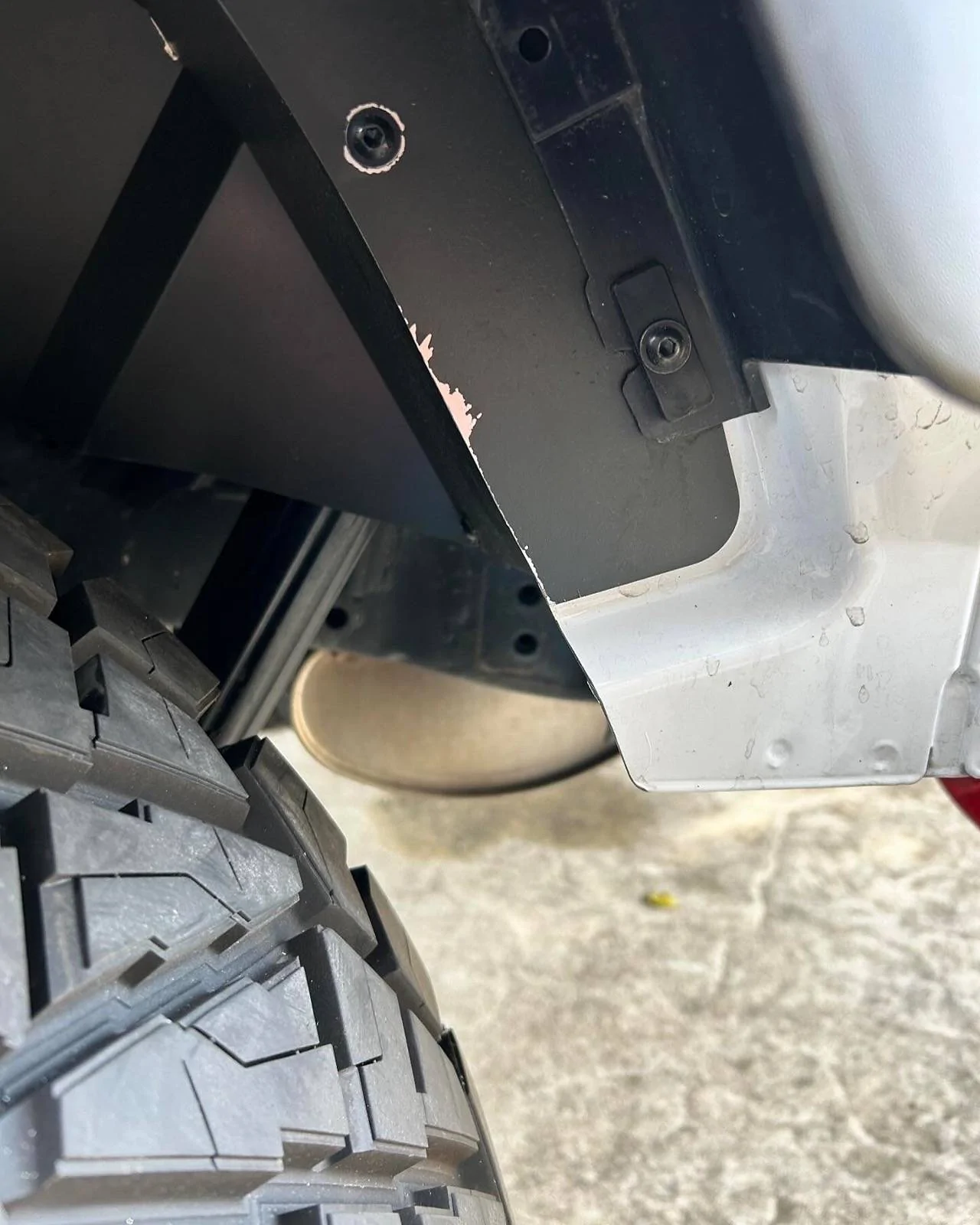

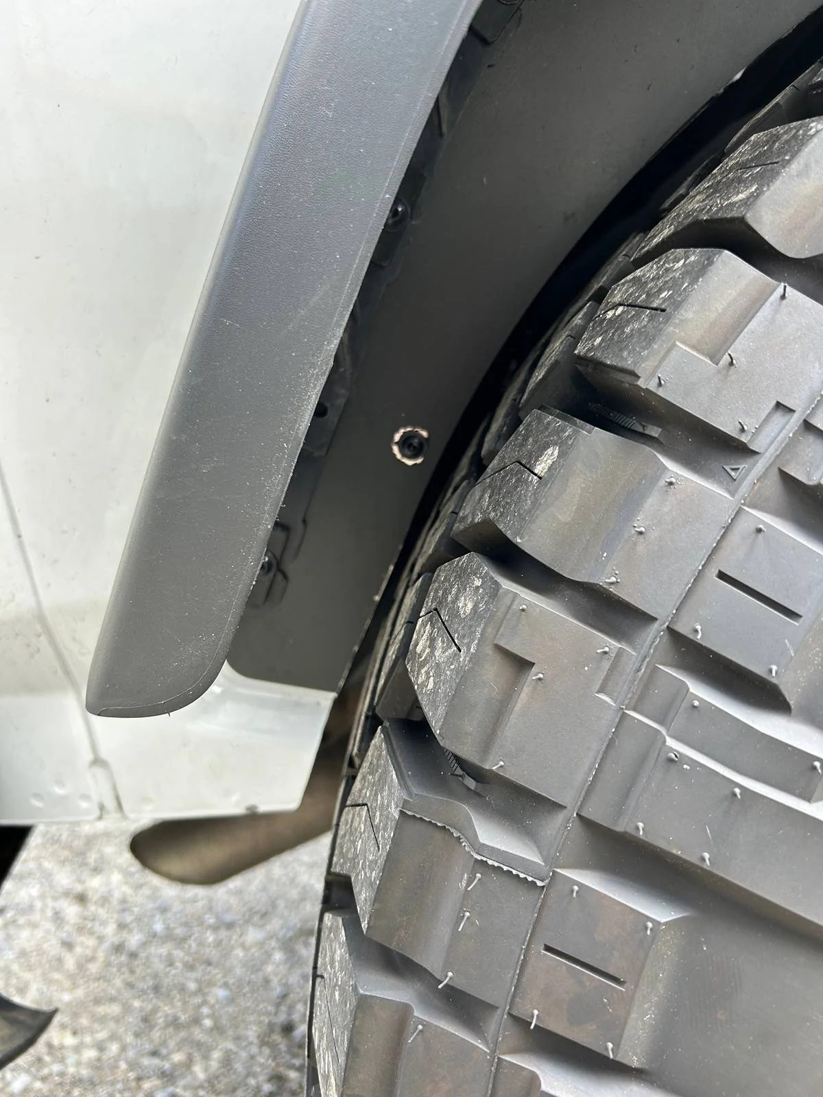

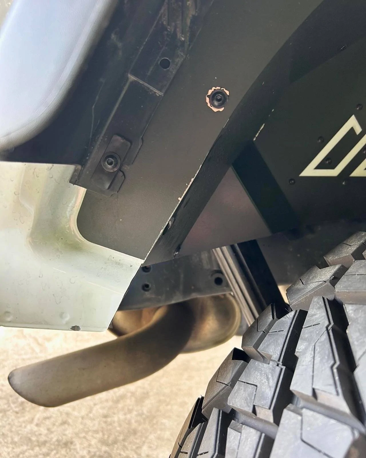

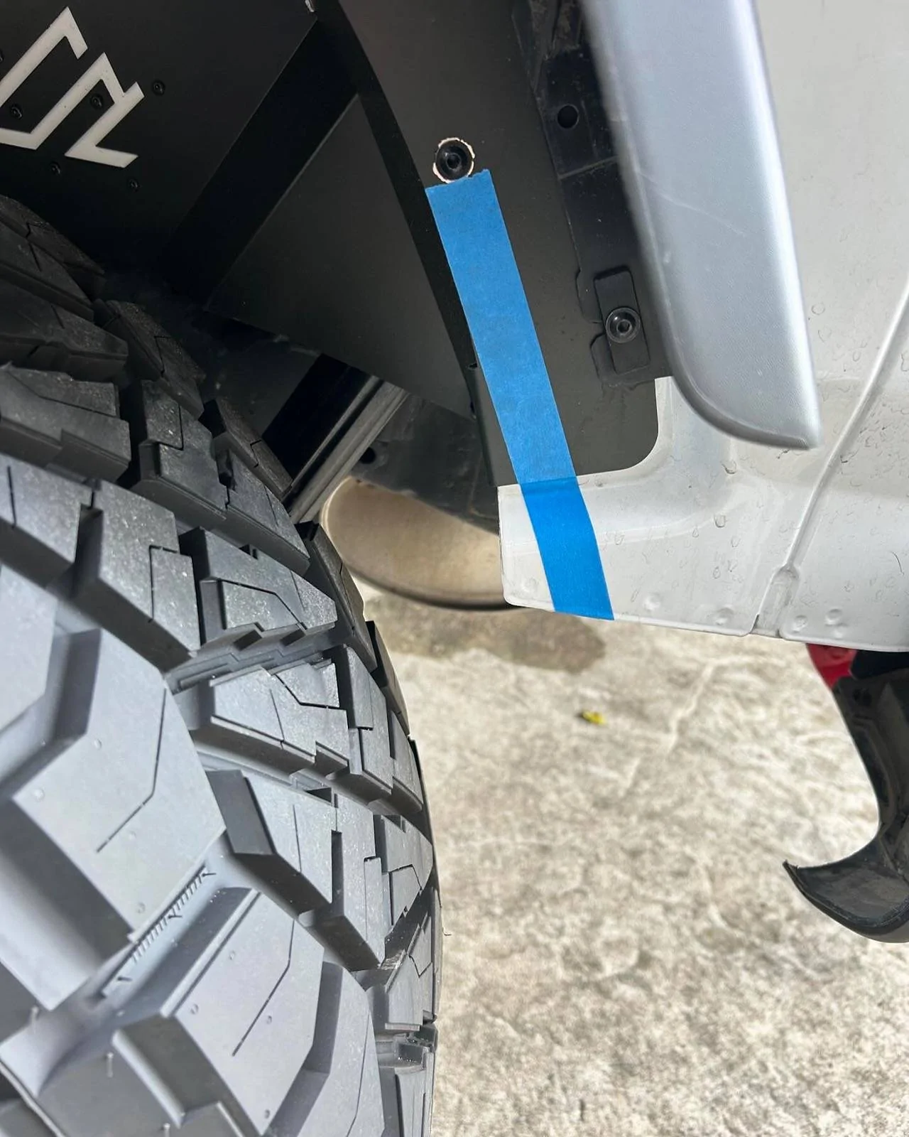

I also trimmed the rear wheel well rear pinch seam - including cutting off the AAL lower liner bracket. At full bump, I just clear it now.
Before trimming:
Jeep Wrangler JL Finally flexed it out with a forklift IMG_3758
After:
Jeep Wrangler JL Finally flexed it out with a forklift DED2CB09-E24C-416D-85EB-65E42A1CDD25
Jeep Wrangler JL Finally flexed it out with a forklift B8146492-9F27-414B-8980-88C6CD622F38
Jeep Wrangler JL Finally flexed it out with a forklift 932AC7D8-13BB-4165-8A55-DF54E137489C
Jeep Wrangler JL Finally flexed it out with a forklift IMG_3802
Yep. It was definitely not disconnected on Saturday. Today, I left the engine running & achieved full stuff to the bump stops. See post 23
