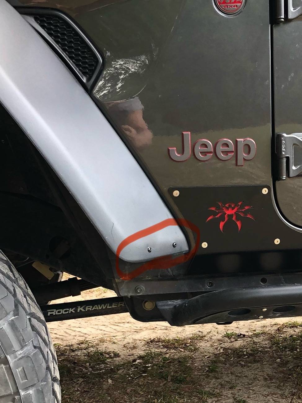

I didn’t like how much the bottom of the front fenders flopped in the wind at highway speeds…. So I modified and reused the honeycomb brace that was there before the split……they’re rock solid now.. I have 2 small button head bolts in the fender but there’s a button head at the front of the fender with the AAL light kit……so it kinda balances it out…..
I really like the way oem fenders look and wanted to keep the same running light look. I think it’s the JLs signature….I like the chopped thinner light look even better….
I still don't understand how you have he bracket at the bottom attached to the fenders >

I don't understand how the bracket is attached to the fenders ?
Hi Jeff, here’s a better picture with the two bolts circled……I originally had it glued with JB weld, but that only lasted about a year….. I have it bolted now with two button head bolts that match the one in the AAL light bracket……been rock solid ever since….

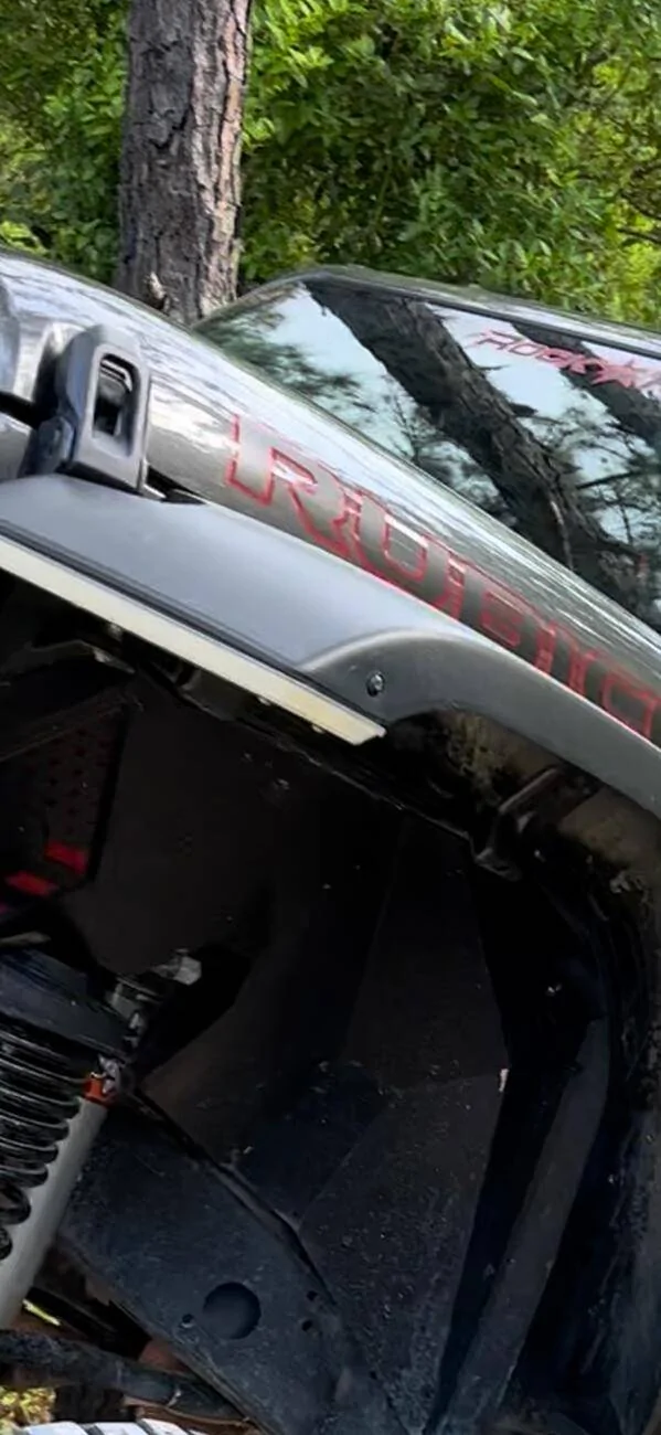

Love the gutted fender look, any updates on the flashing dash light problems? Is Quake front light/bracket plastic or metal like AAV and MetalCloaks?

Thanks was kinda hard to tell from pics.
Anyone do fender gut and use the stock LED turn signals? They're already there, they work, paid for and definitely zero weird warning lights on the dash from them LOL.
The partial gut with keeping the outer wrap over edge piece is interesting but seems like it would get in the way? Adds some rigidity for freeway flappiness resistance though.

Sorry, I can’t answer that, the edge piece can be cut to keep the rest with slimlines though. Check out slimline install videos to perhaps answer your question.

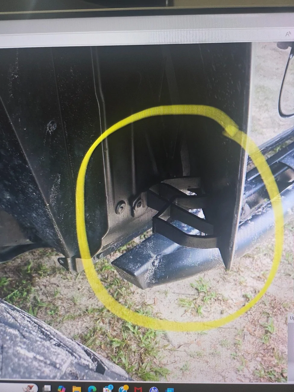

Roky I have a quick question. On that one screw on the bottom holding the bracket to the Jeep how long was it and did it go into the medal of the Jeep at all ? And I see that you bought I think you did or someone else had it the American venture inner fenders. Are they easy to pop out like they say like if I have to get to my small battery auxiliary battery is easier to pull that inner fender to get to the battery isn't it just pretty easy I don't have to disassemble it to get to it stop stop crying stop
