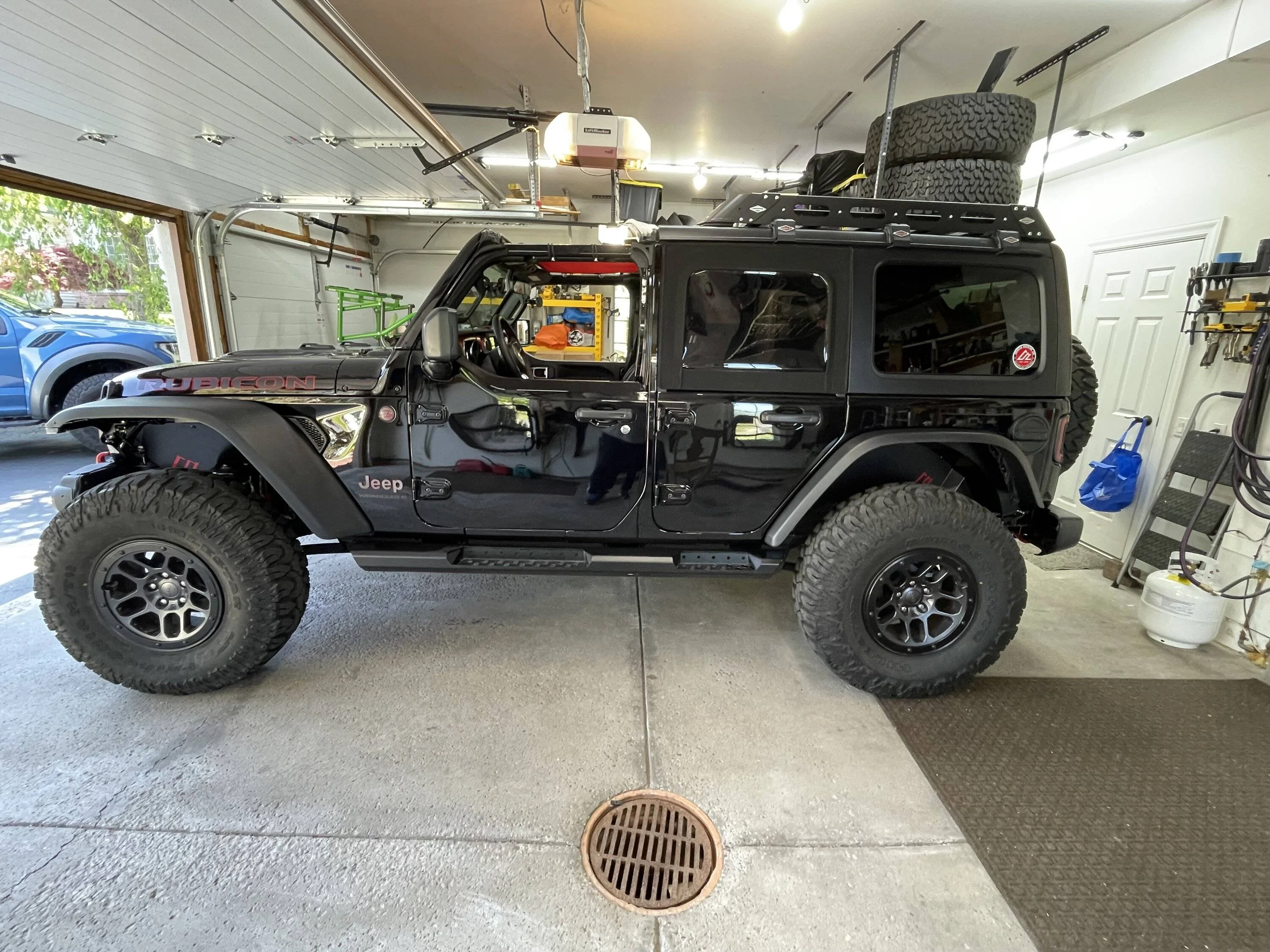

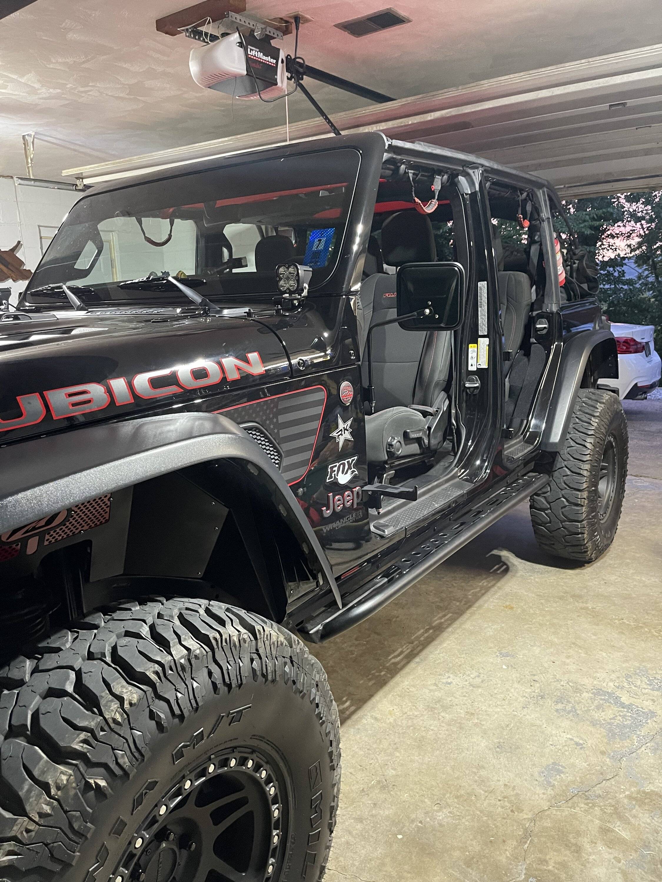

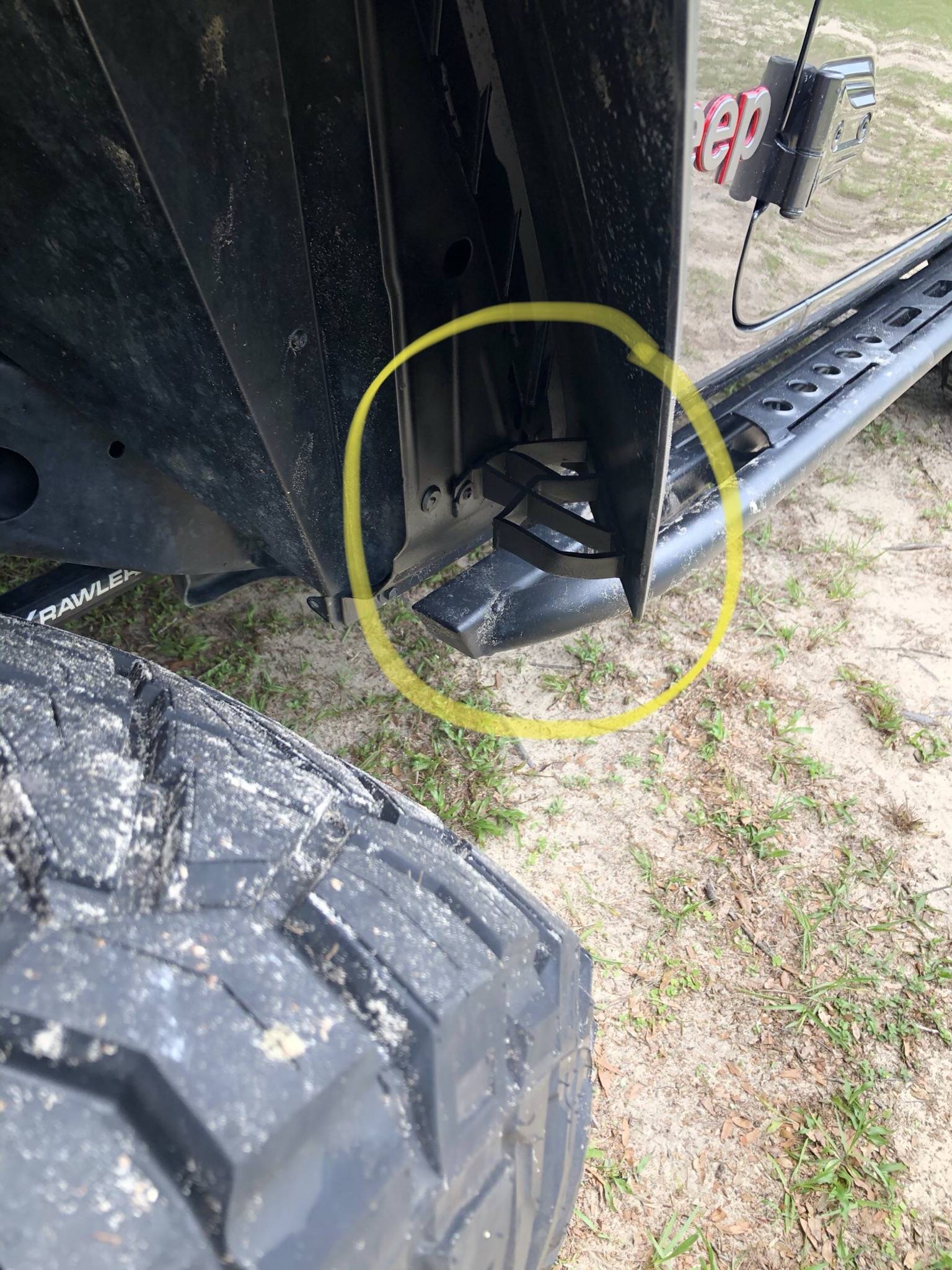

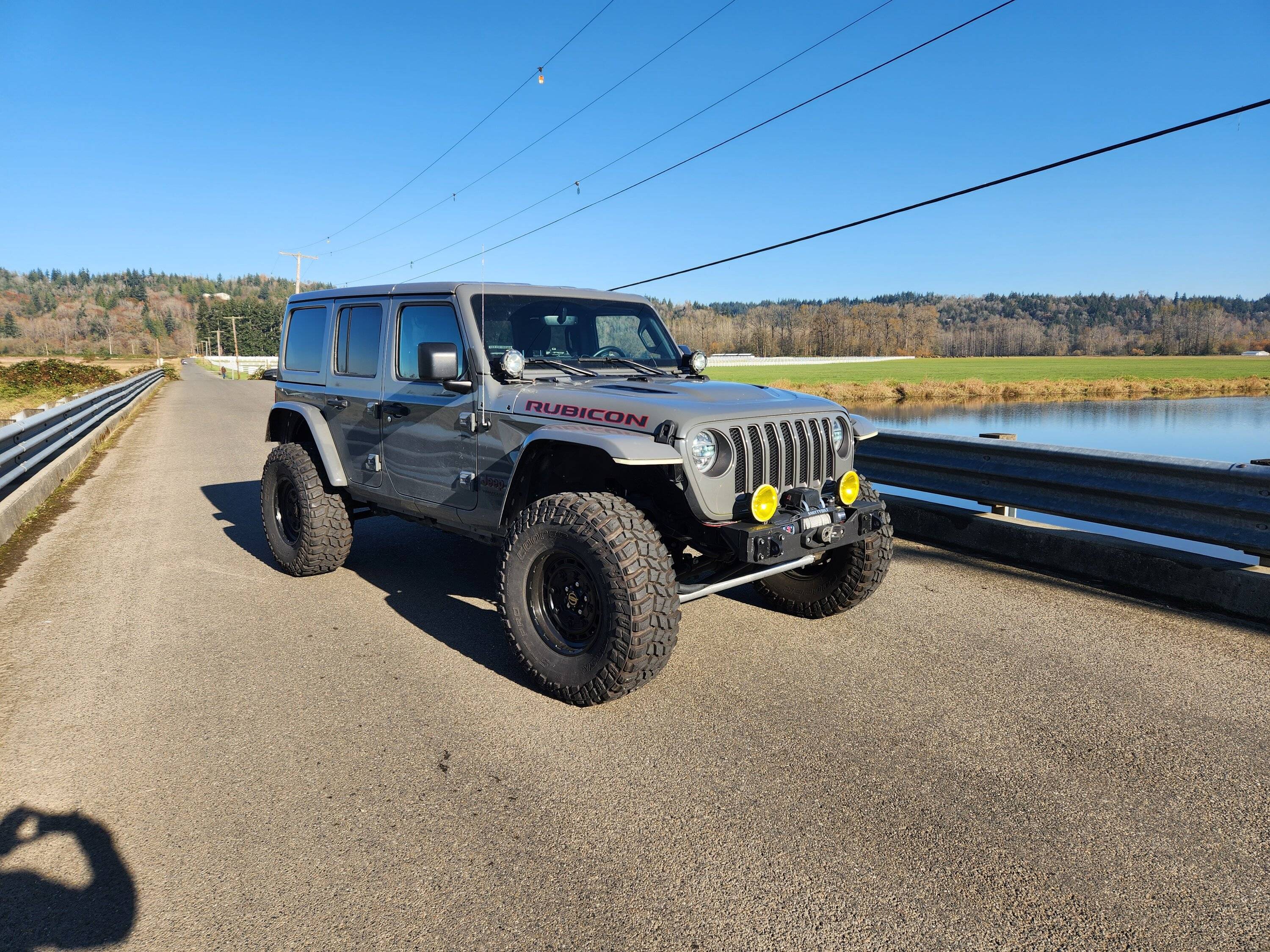

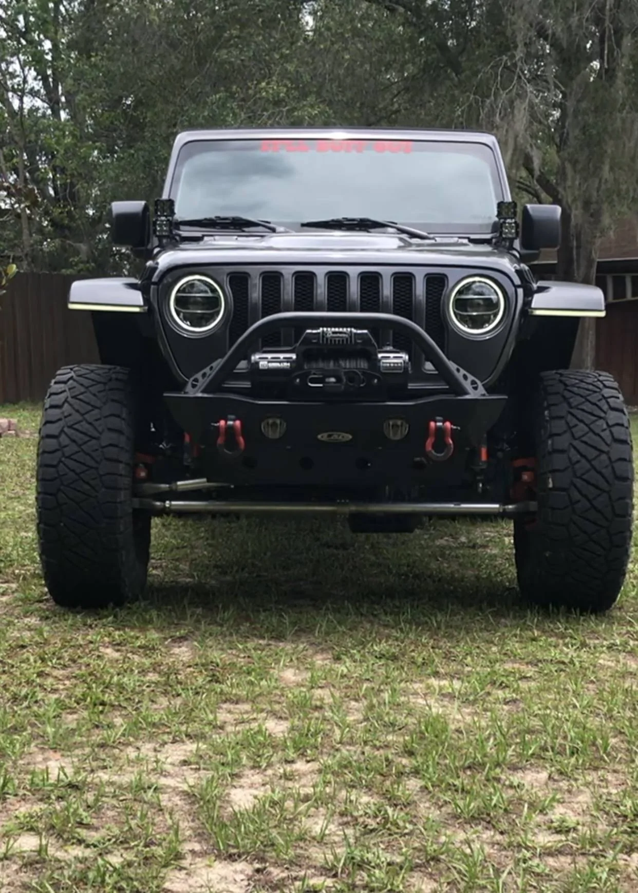

I didn’t like how much the bottom of the front fenders flopped in the wind at highway speeds…. So I modified and reused the honeycomb brace that was there before the split……they’re rock solid now.. I have 2 small button head bolts in the fender but there’s a button head at the front of the fender with the AAL light kit……so it kinda balances it out…..
Jeep Wrangler JL Fender Chop/split Worth it or a Mess? F76923EF-3637-47A3-B06E-08D49F075530
Jeep Wrangler JL Fender Chop/split Worth it or a Mess? 4A4659F5-58D7-4653-9650-22EC0FE4CC12
Jeep Wrangler JL Fender Chop/split Worth it or a Mess? F70DAE25-1392-48BC-9812-3AF4FCE0C746
I really like the way oem fenders look and wanted to keep the same running light look. I think it’s the JLs signature….I like the chopped thinner light look even better….

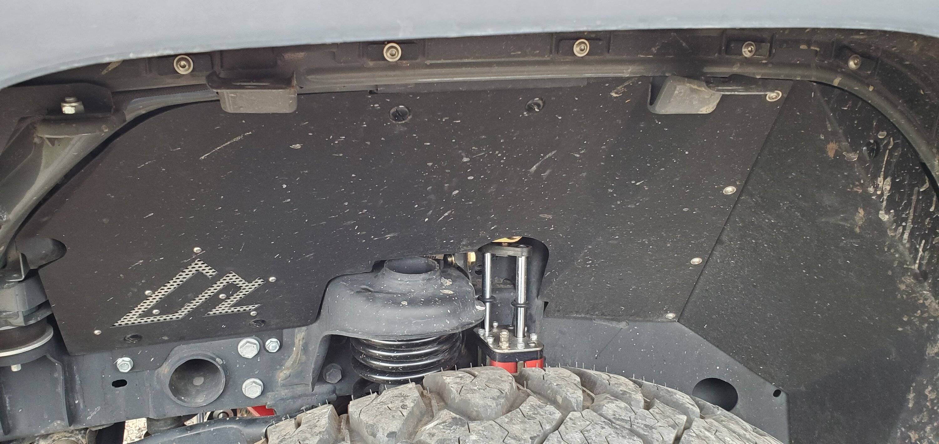

I love the look of mine after removing the cheap black plastic fender liners. Got the AAL lights and some Barricade metal fender liners and looks bad ass! So much more room. I have a Mopar 2” lift and 37’s.

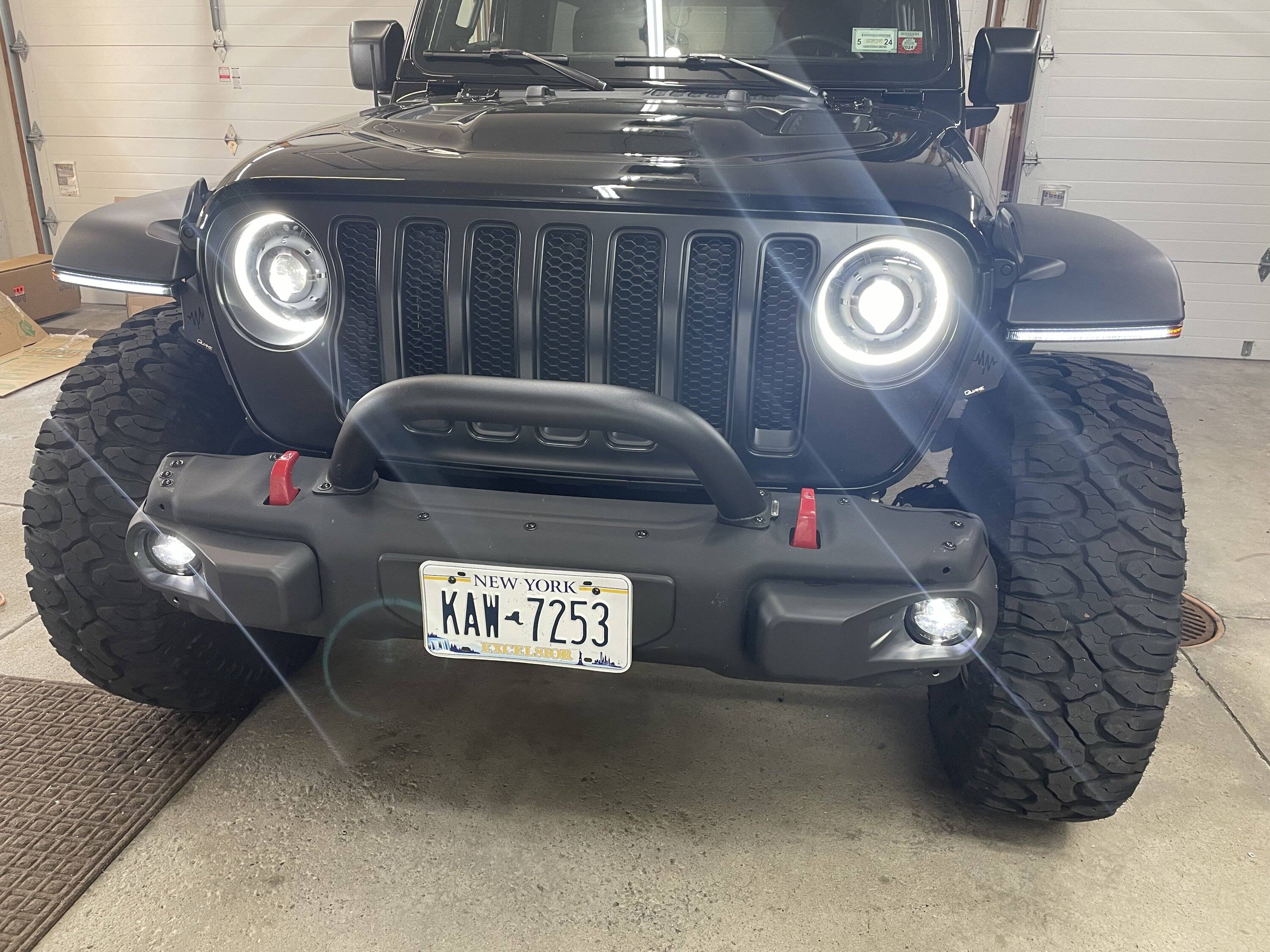

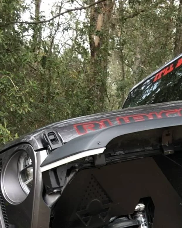

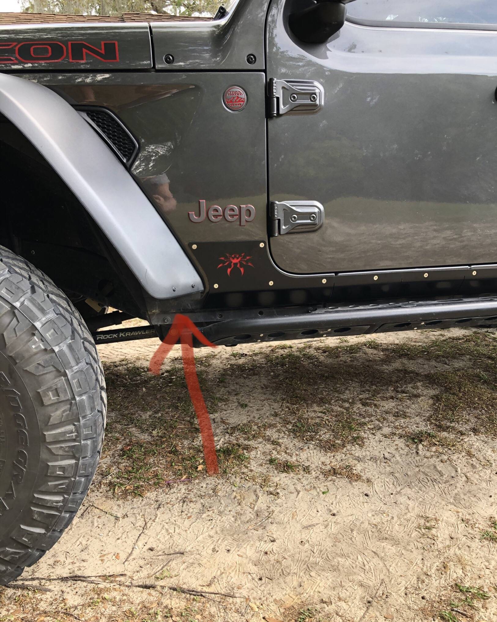

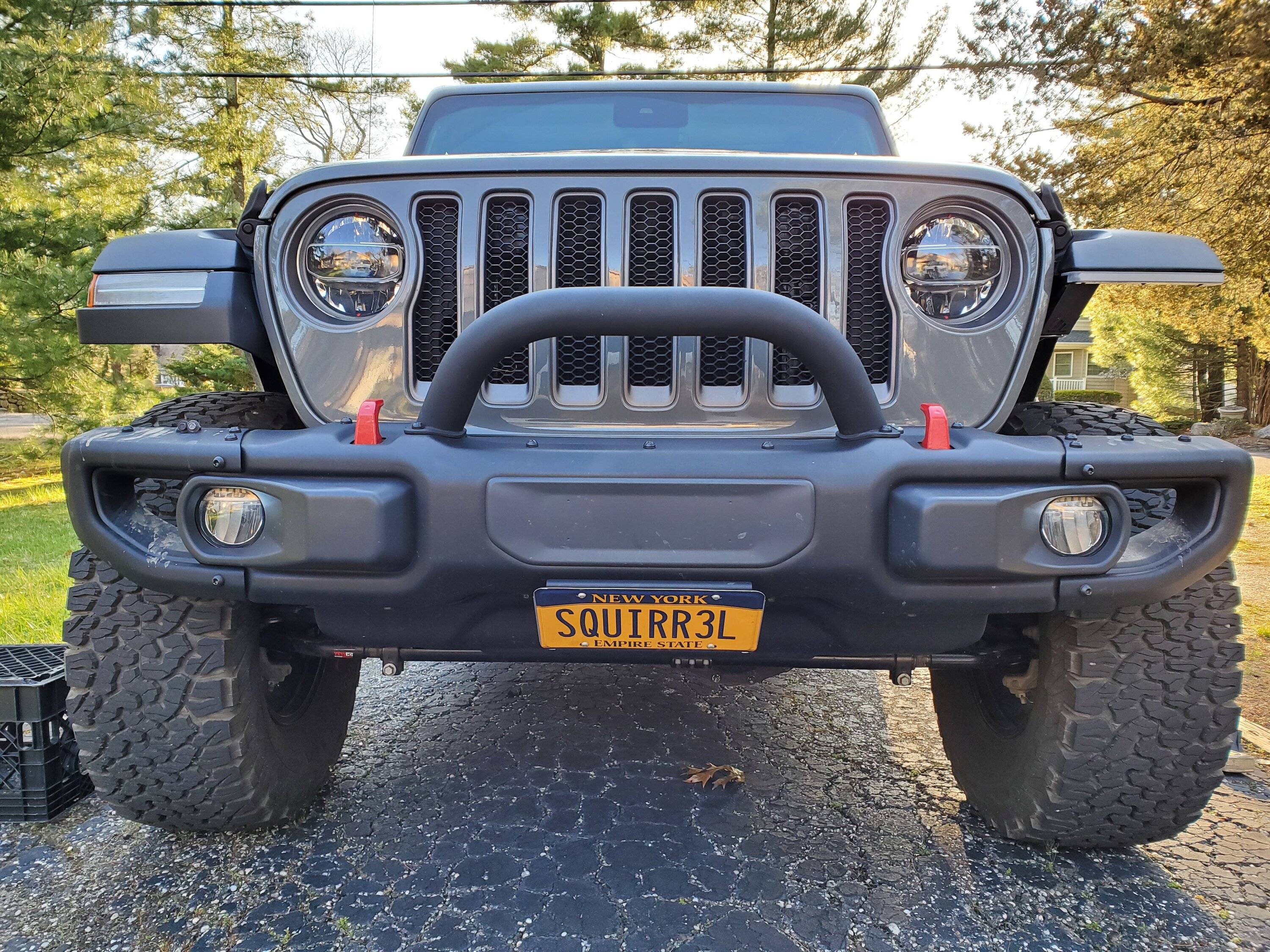

Chopping the factory fenders was one of the best modifications I made to my JLUR. It gained 3.5" of tire clearance up front and 2-2.5" out back.
I used the AAL highline lights, liners, and fender retention hardware kits. I also copied a page from Roky's book, and recycled a small section of the factory inner fender structure for the rear lowest end of the chopped fender. Between that and the retention hardware, which replaces the factory white clips, the fenders are rigid enough to not move at highway speeds.

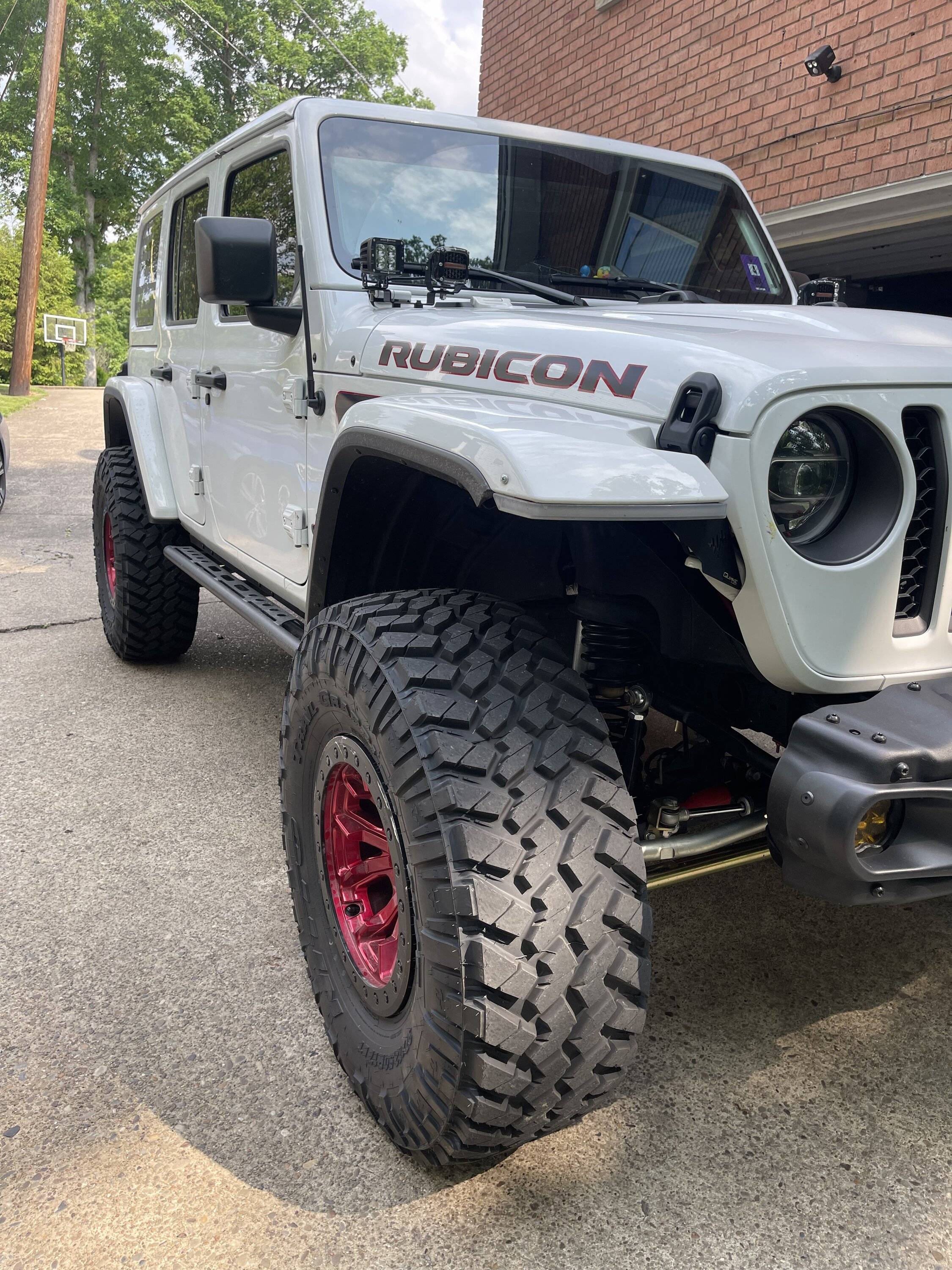

I did it on my last JL and wasn’t a big fan of it, always had the bulb out light and the fenders were super flimsy, although that is fixable. Now on my current JL I did the quake chop light and didn’t completely split the fender. They gave me the bulb out harness and I’ve had these installed for a year with no issues
