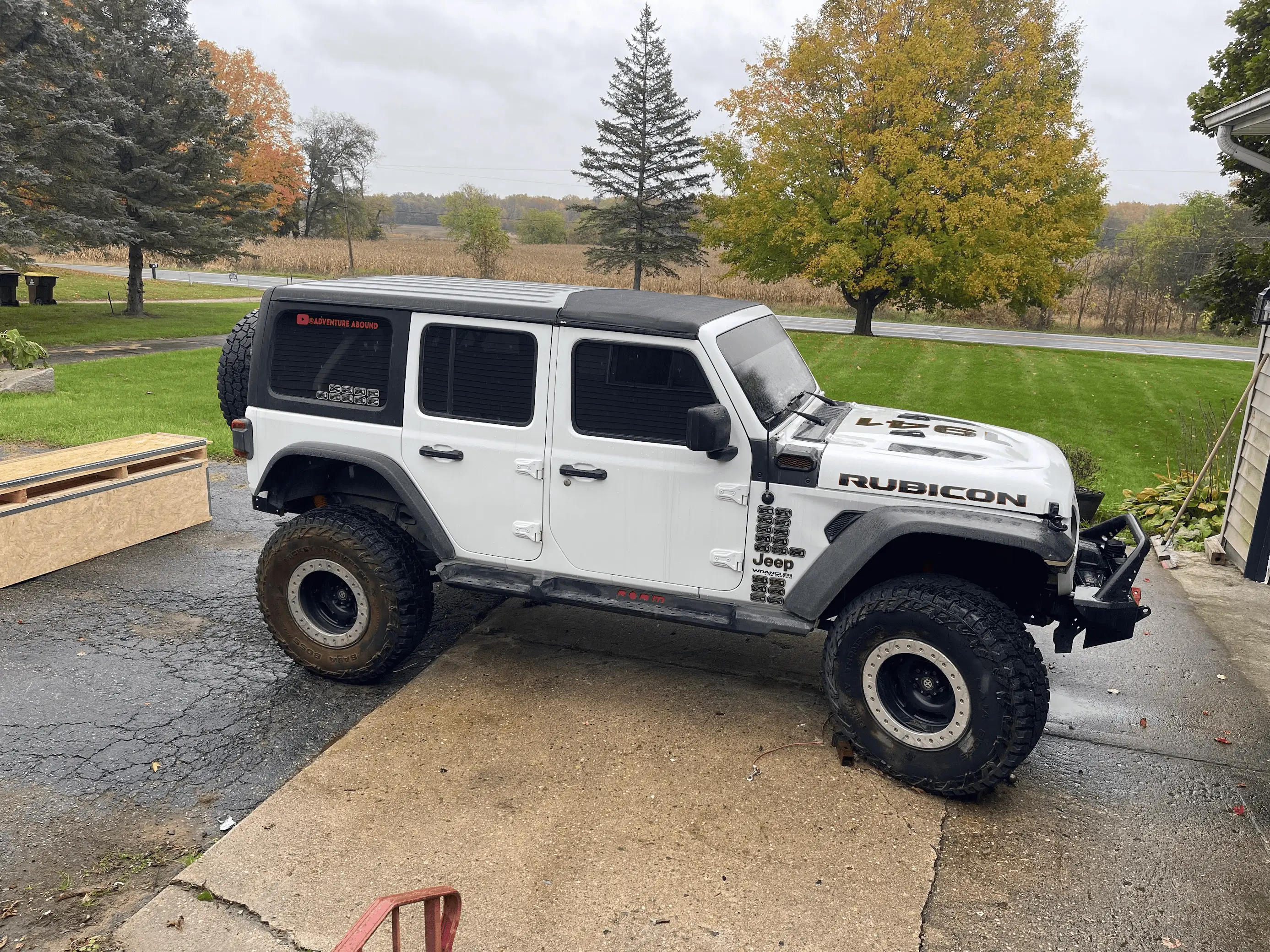

I did this a few years ago. If I remember right it is about three inches.
this is what my Jeep looks like with a 2in lift on 37s with chopped fenders.

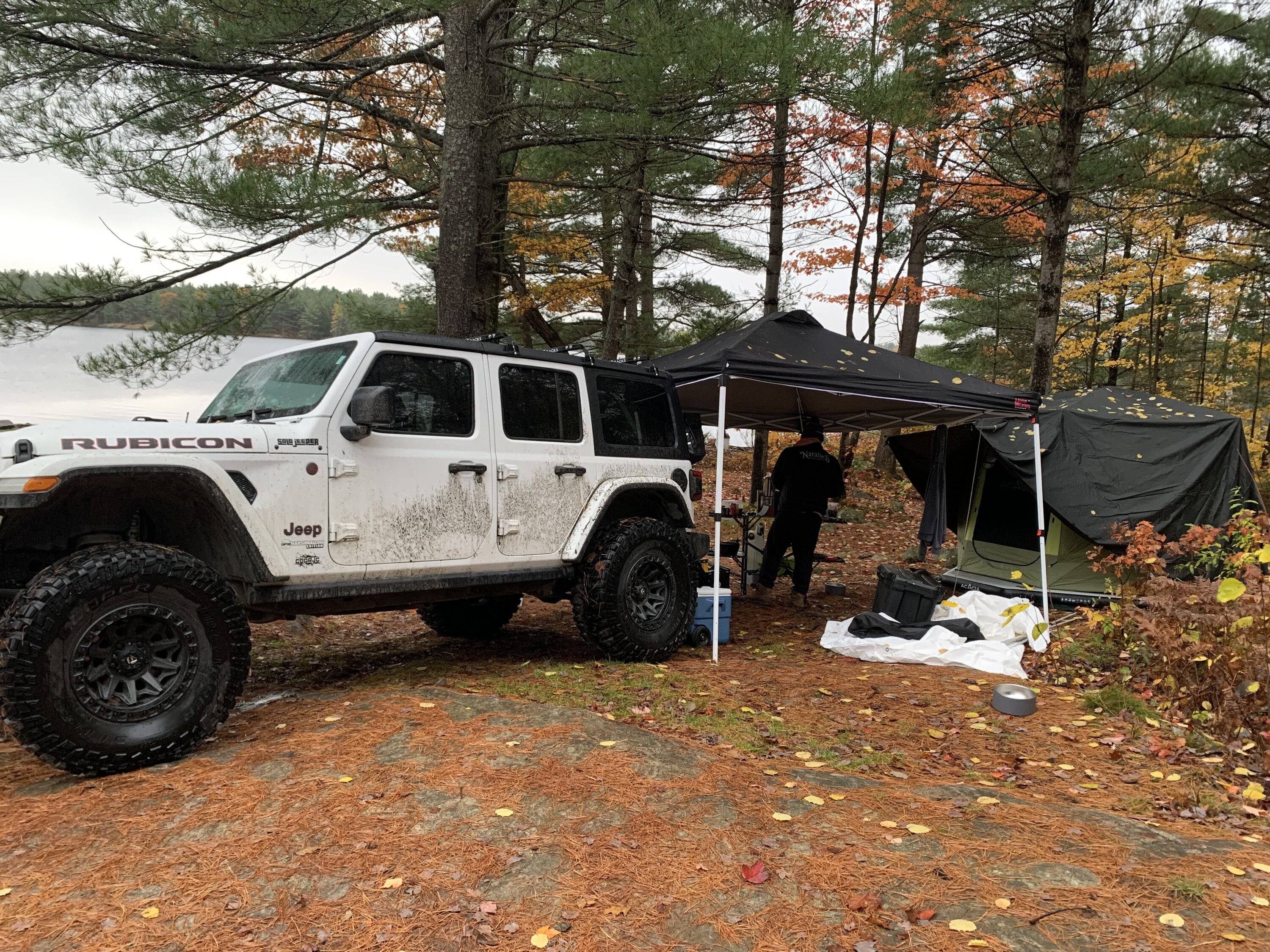

I changed to aftermarket inner fenders and the Jeep does not rub at full flex.

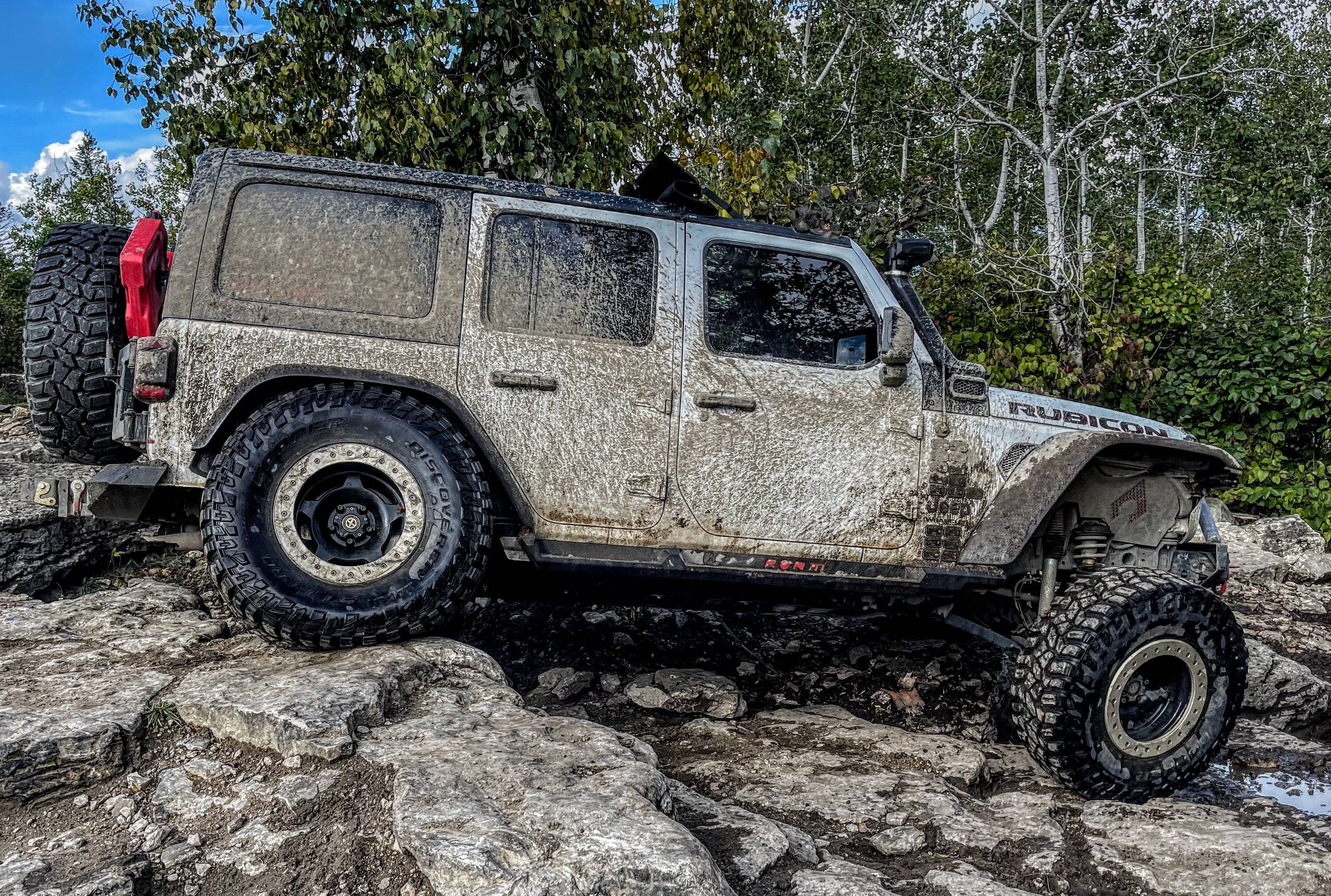

That looks pretty close though. I don’t really rub with no weight. 3 inches in the back would help a lot with 350lbs extra weight in the back.
It is all about having the correct bump stops in place.
