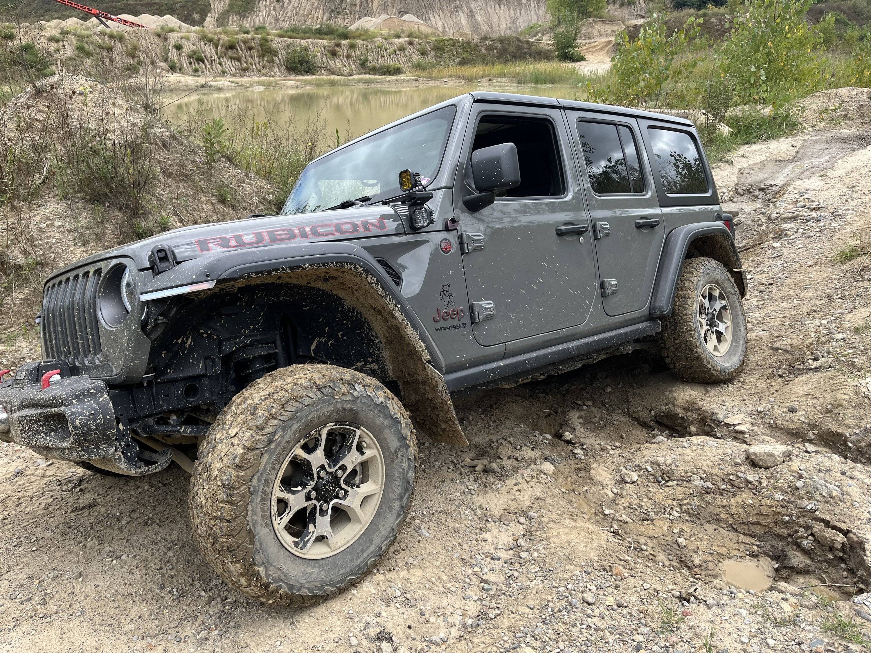

When I did the chop I accepted that I may have to buy all new fenders of it didn’t go the way I had planned. Thankfully the chop worked out for me.
Jeep Wrangler JL Fender Chop - Replacement Fender Trim Options? IMG_2657

Chop looks good. What process / tools did you use for a clean cut?
Grayhound
Dan
Jul 30, 2022
65
1,370
1,992
Michigan
Jlurd

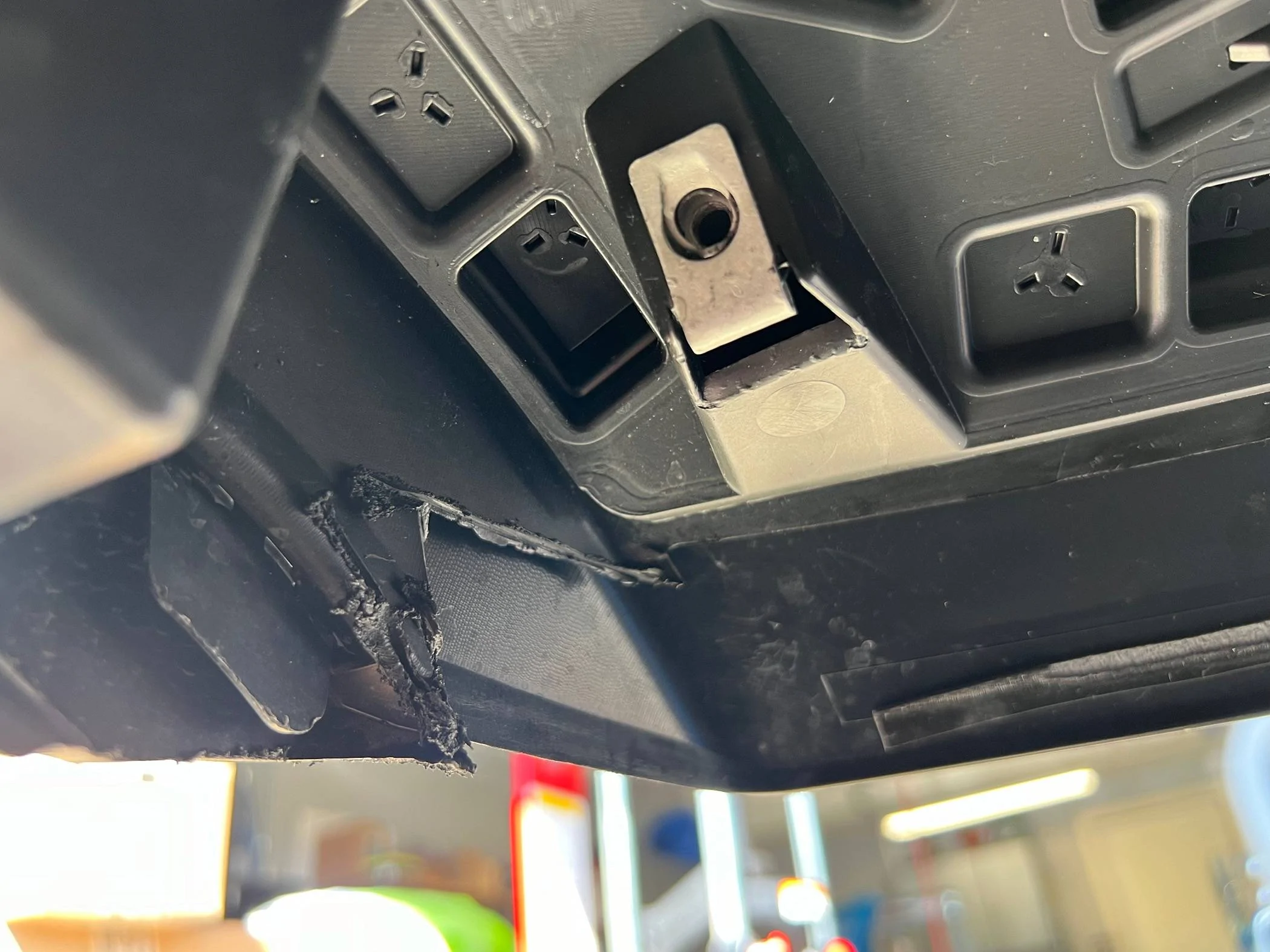

I used simple hand tools. A little rotary took did the cutting for me.
I started on the passenger side as I had damaged that fender, I removed that side when I did the chop. It went well.
for drivers side I left the fender in and the chop was a lot faster.
i kept my inner liners. So if you can see in the pic I had to figure out a cut that looks okay. I decided to use the bottom of the light as my liner to cut.
all in all I really like it. I was running halogen headlights and didn’t like the temp mismatch of color afterwards so I went to oculus projector headlights for the color match.

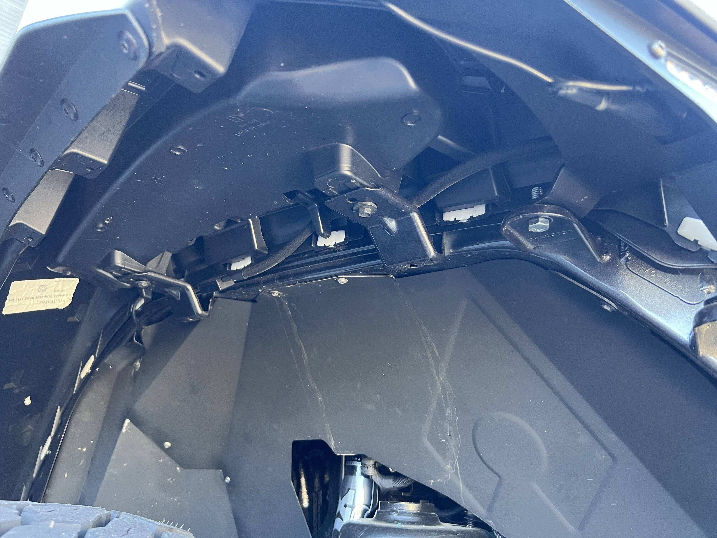

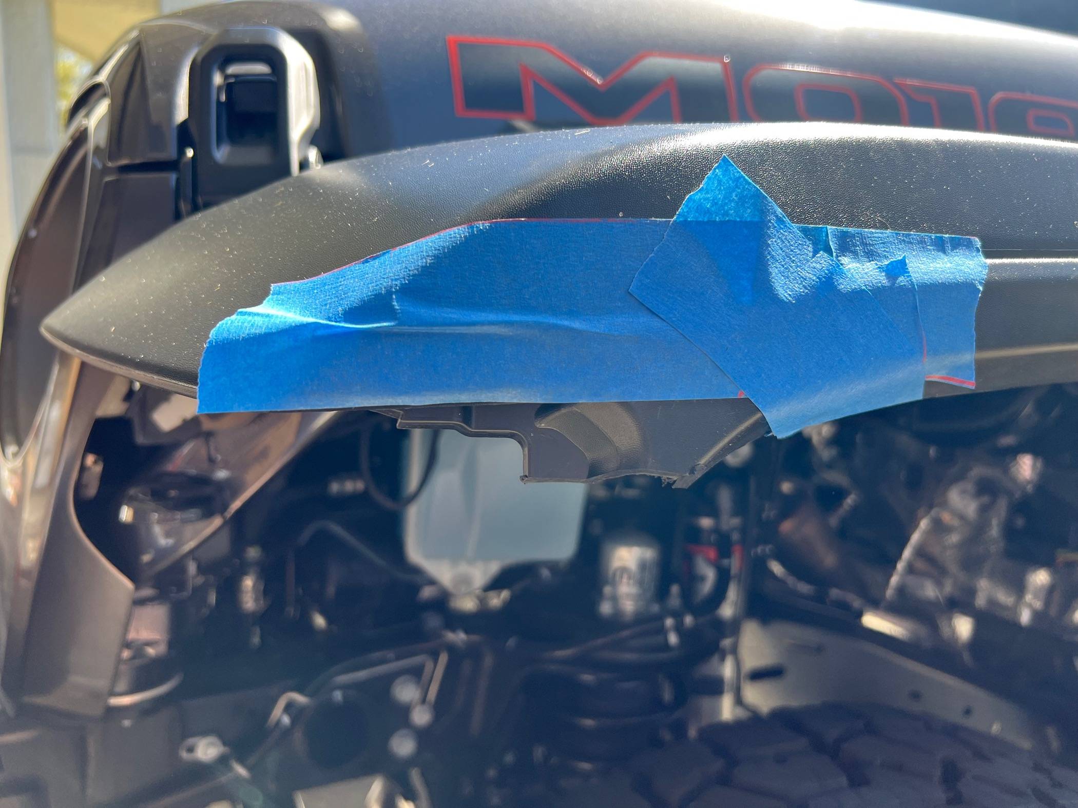

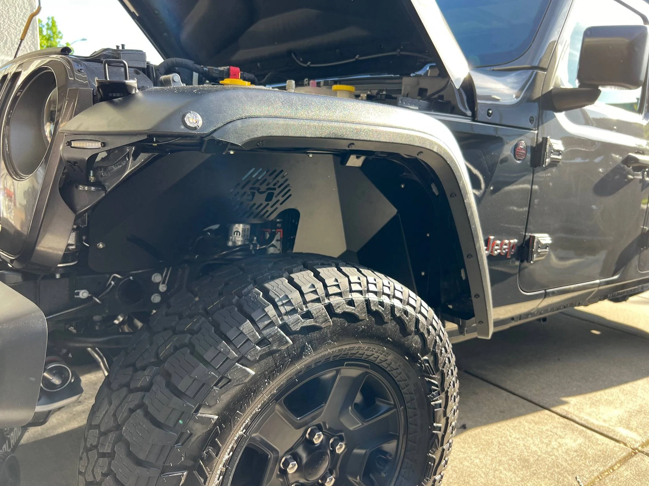

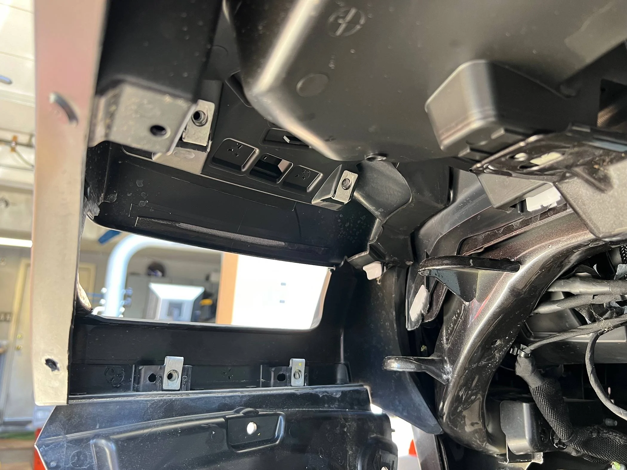

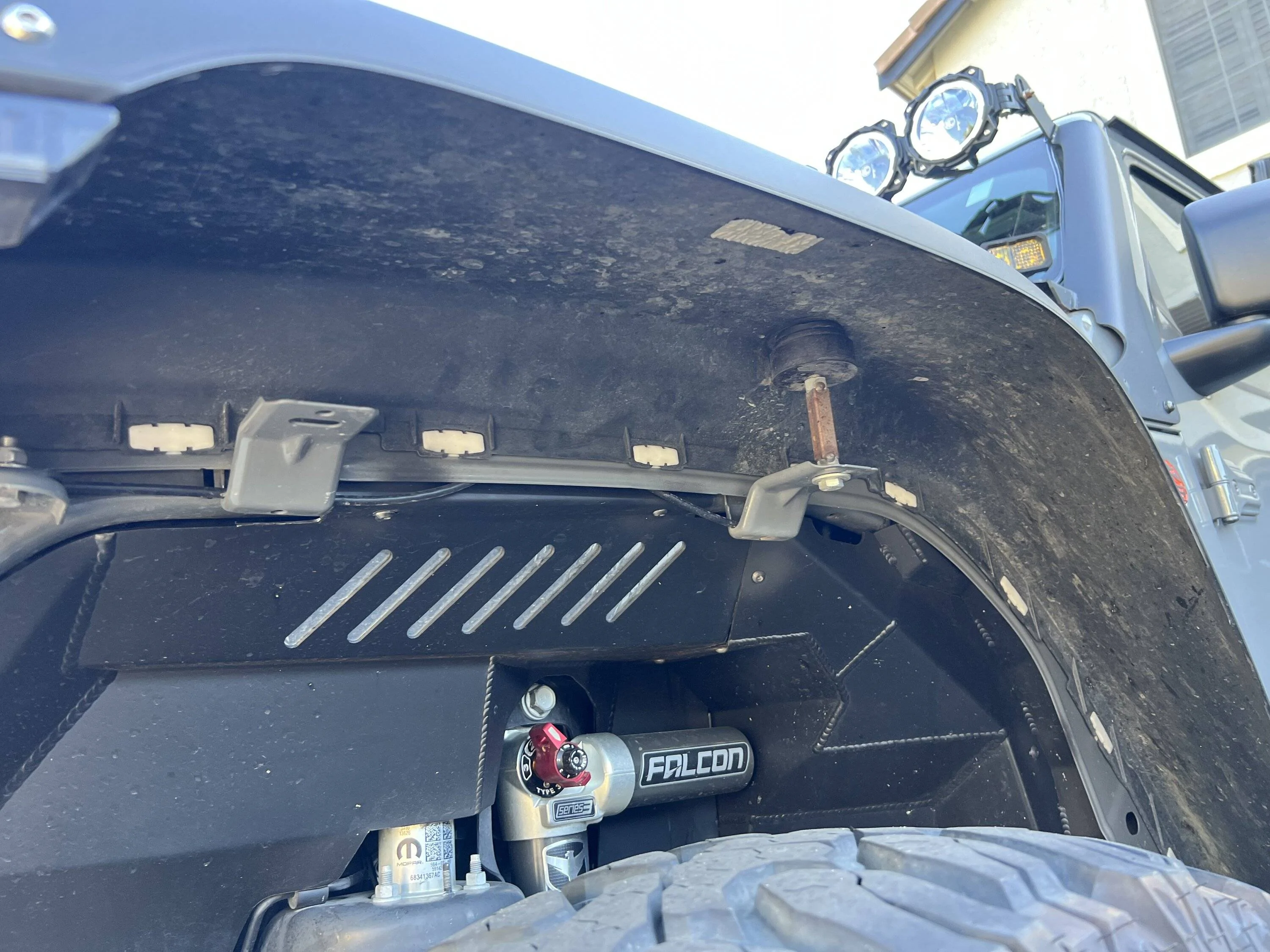

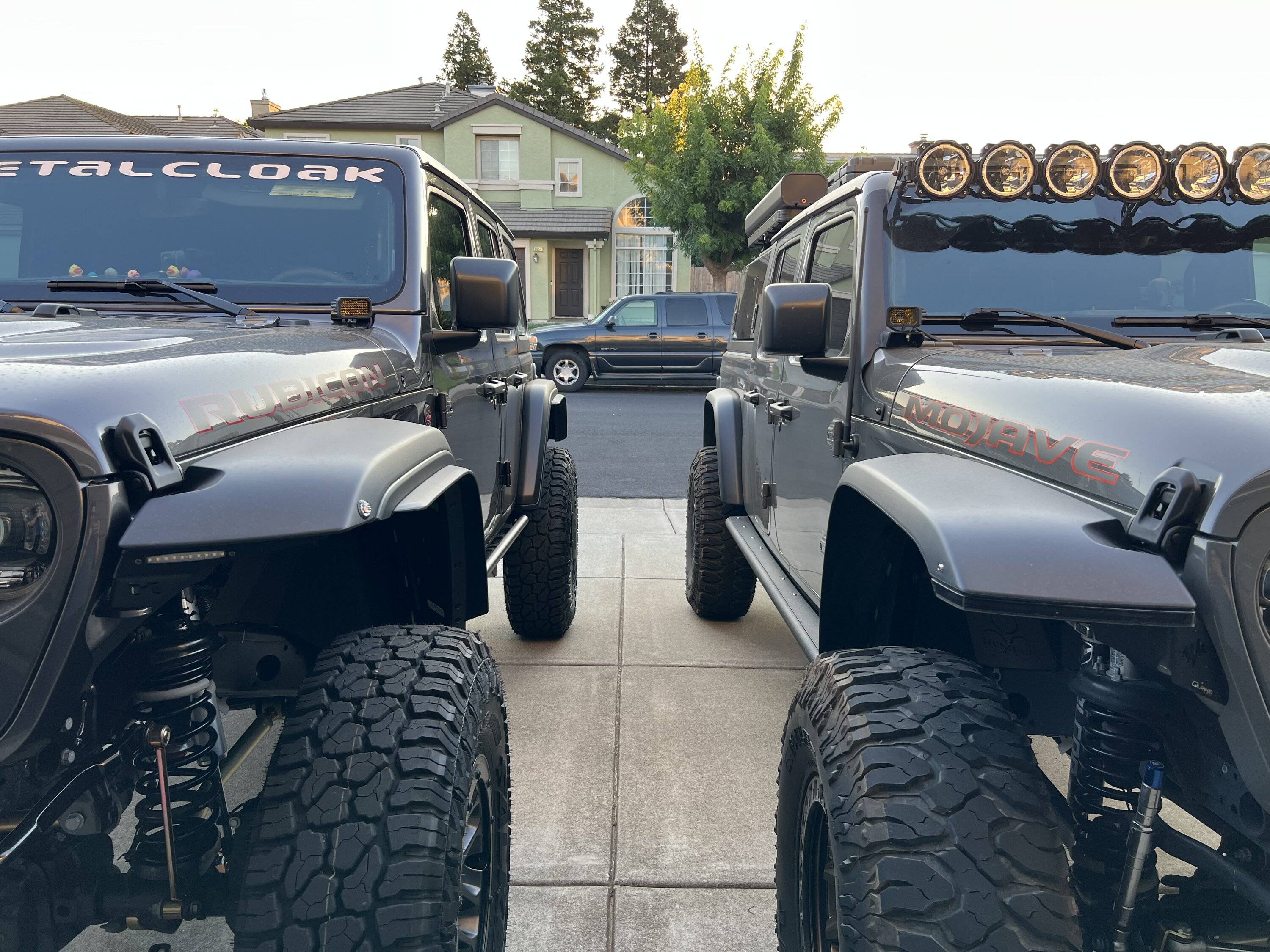

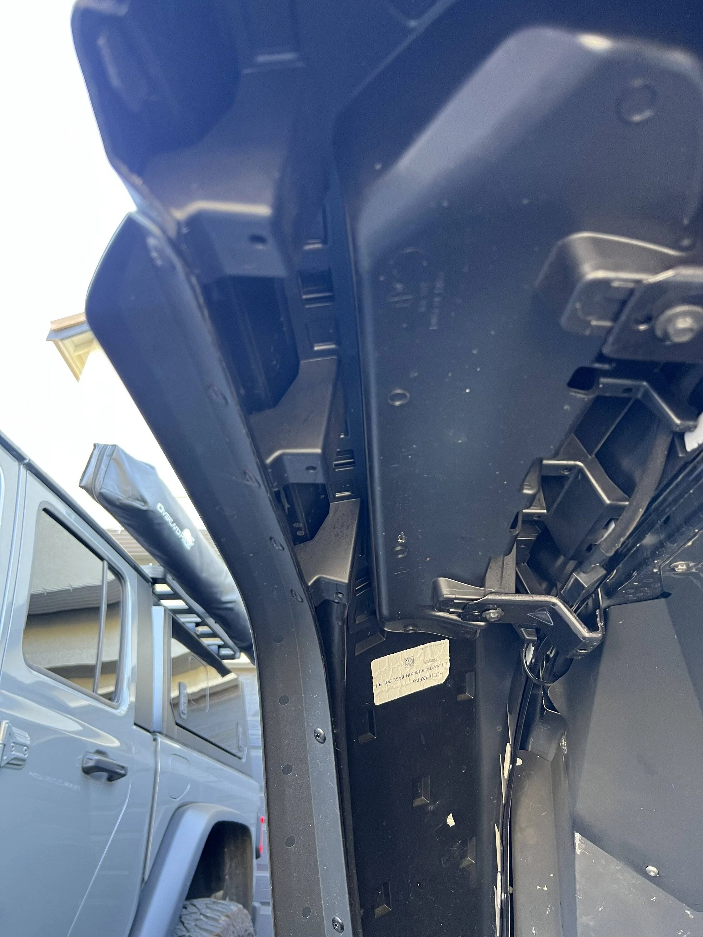

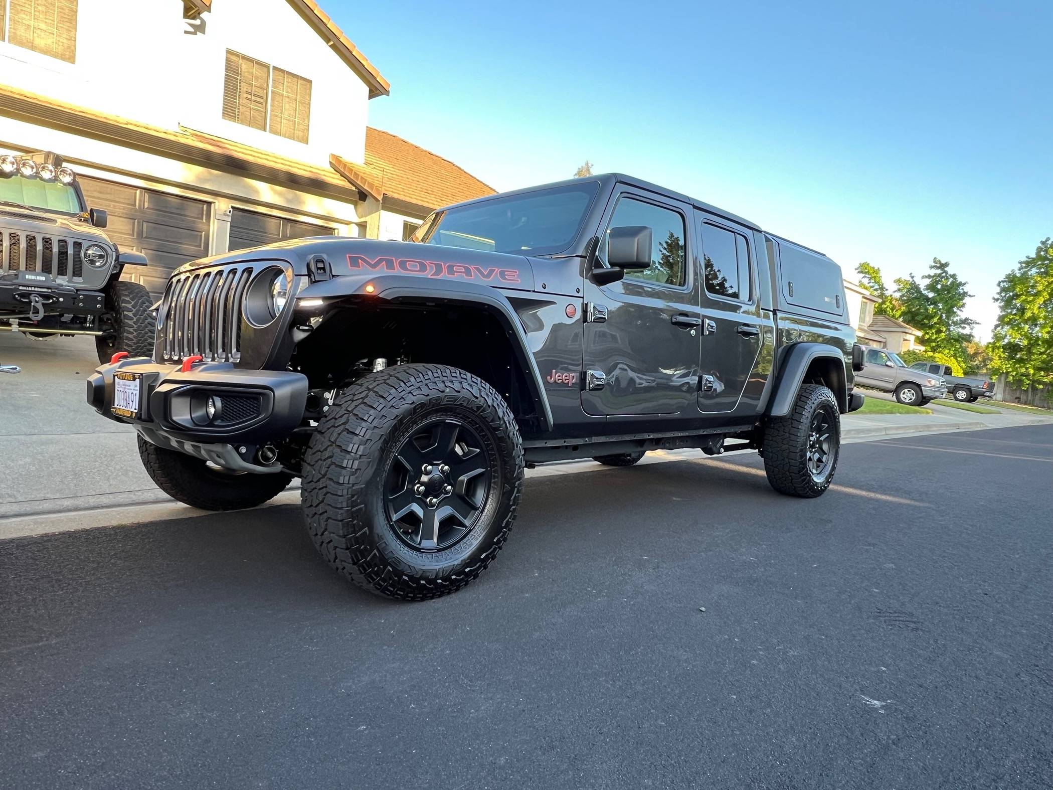

Fully gutted my JT the JL I just removed liner and trimmed for the chop.
Made my own stand-off support for the fully gutted and separated JT flares.
@svc707 When you did this on your JL do you gain much clearance for up travel? Or was it just for the look?
I am looking to gain a bit more up travel as my tires rub the upper inner fender liners but not sure I want to go full gut on the fenders. Was thinking of just adding inner fender liners and doing what you did here. I kinda like the stock fender look but looking for some more clearance.
Thanks!
You do gain because you’re removing the plastic which still has some hollow gap to it.

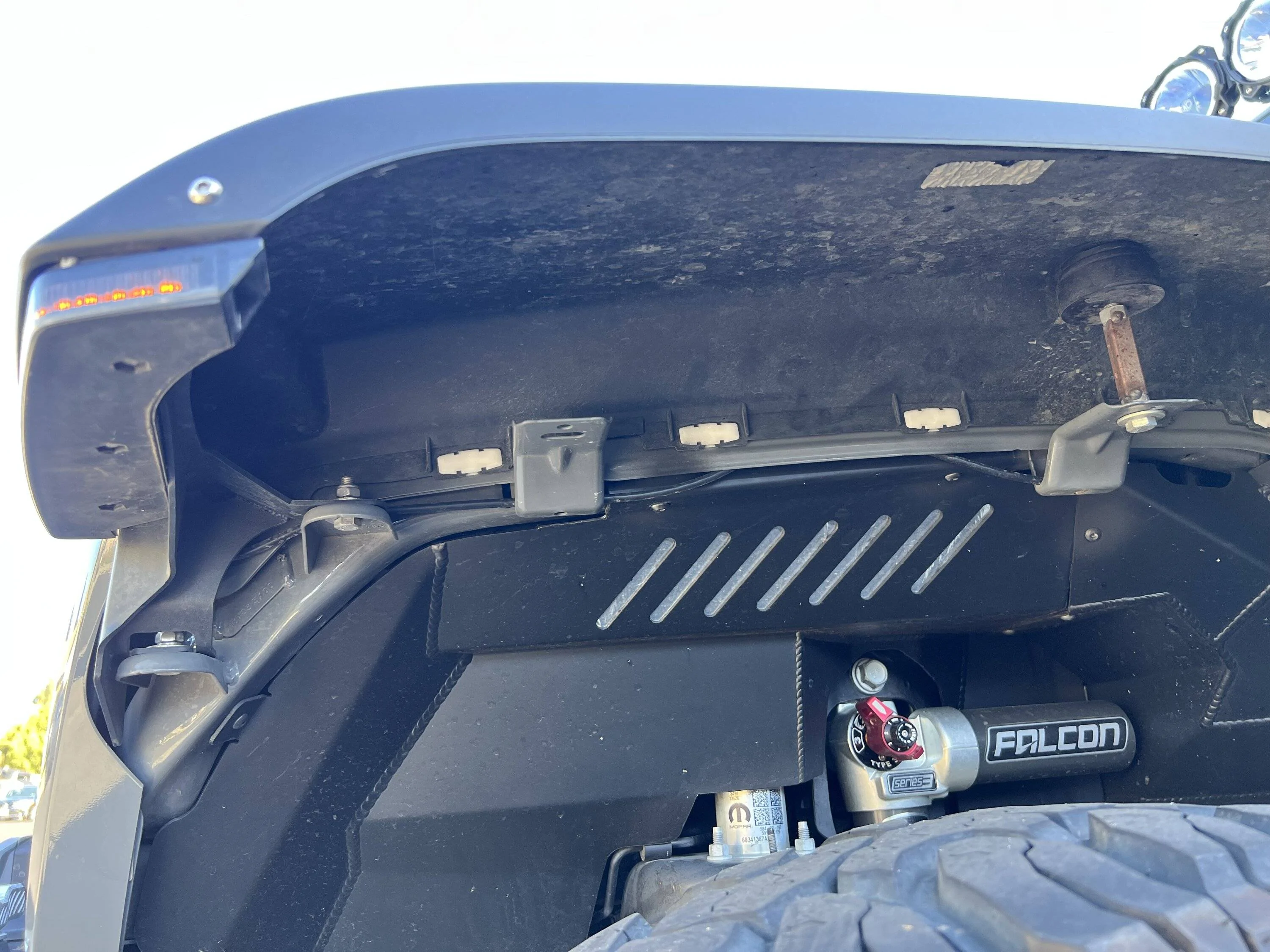

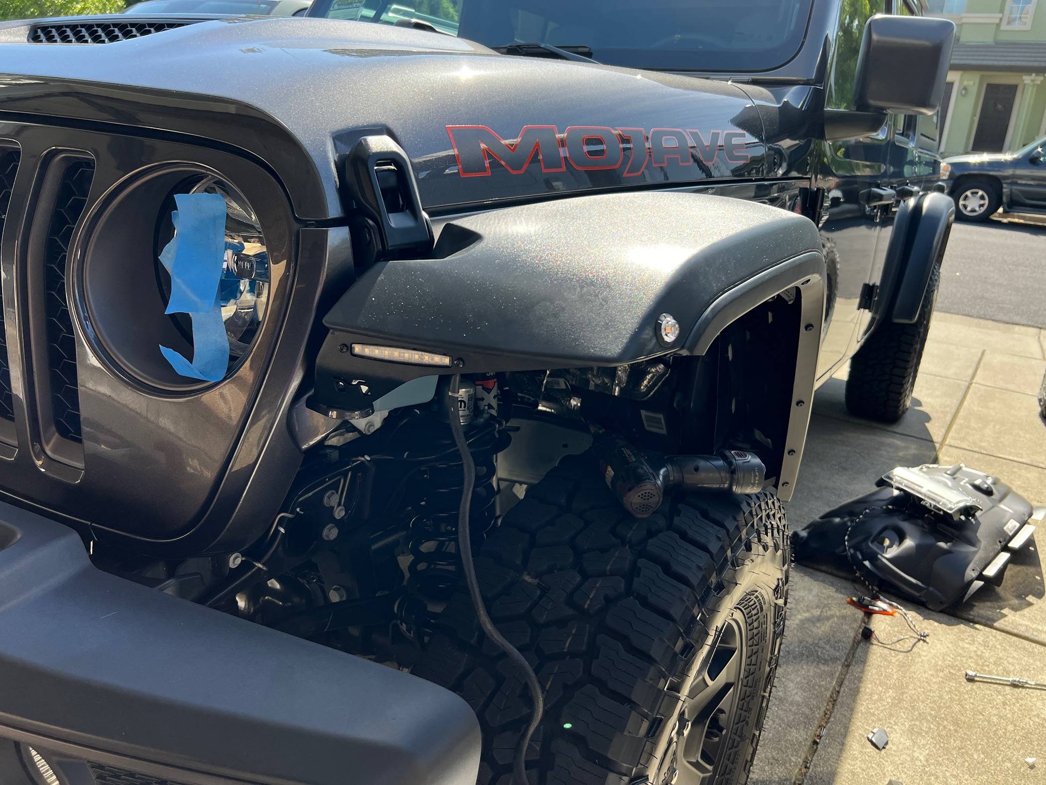

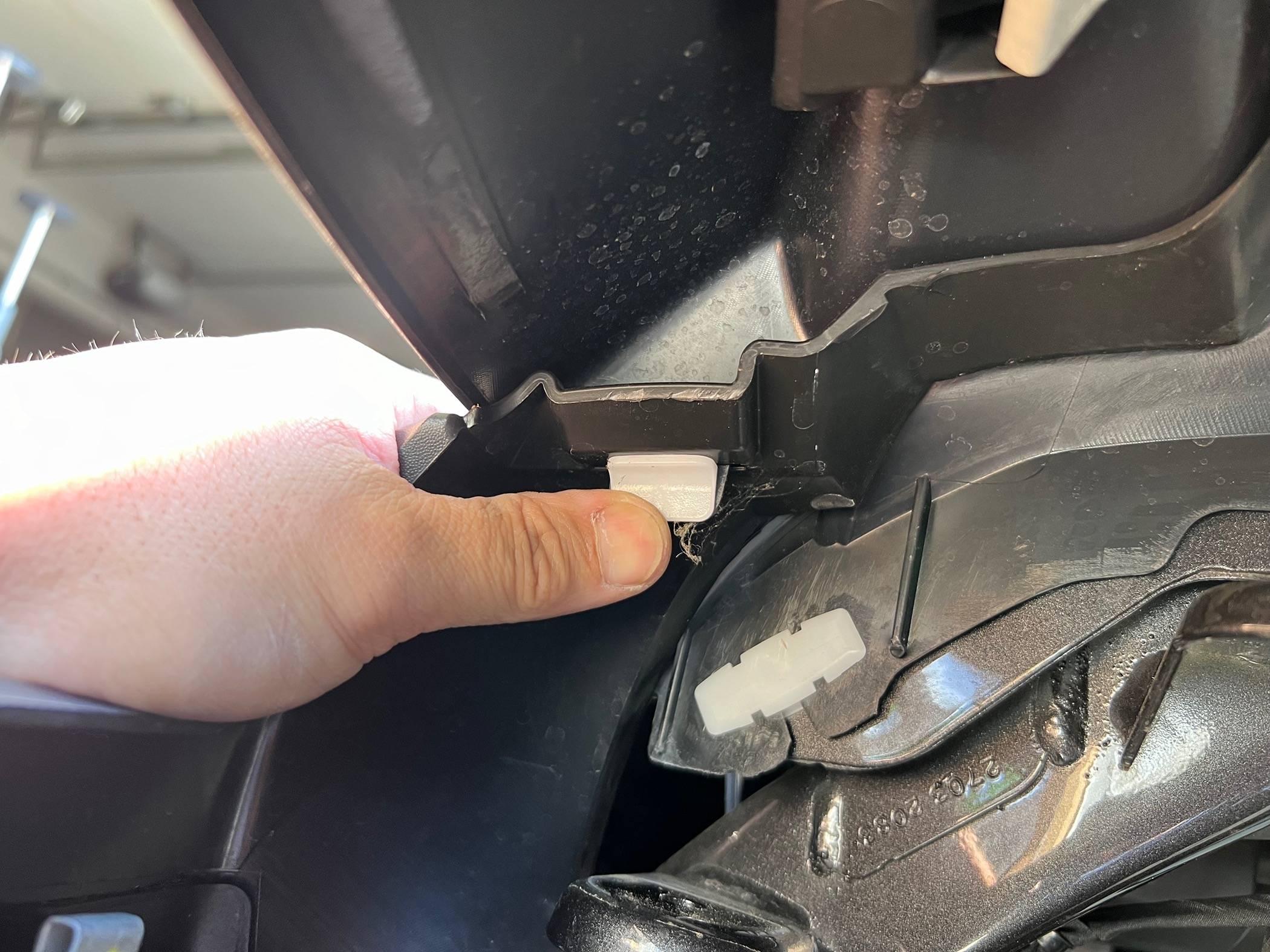

I just did another Gladiator today with the Metalcloak Gutz delete
I also installed the Metalcloak inner liners
