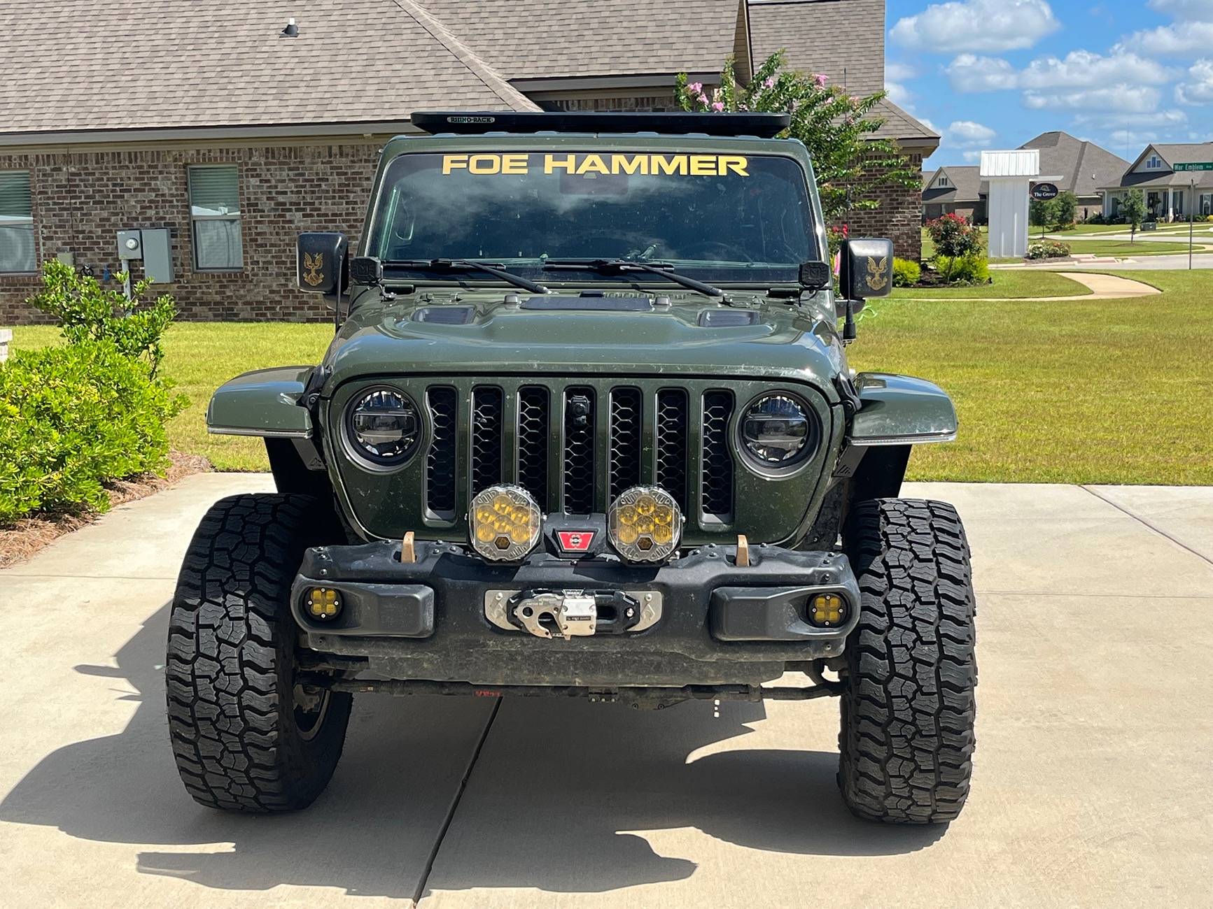

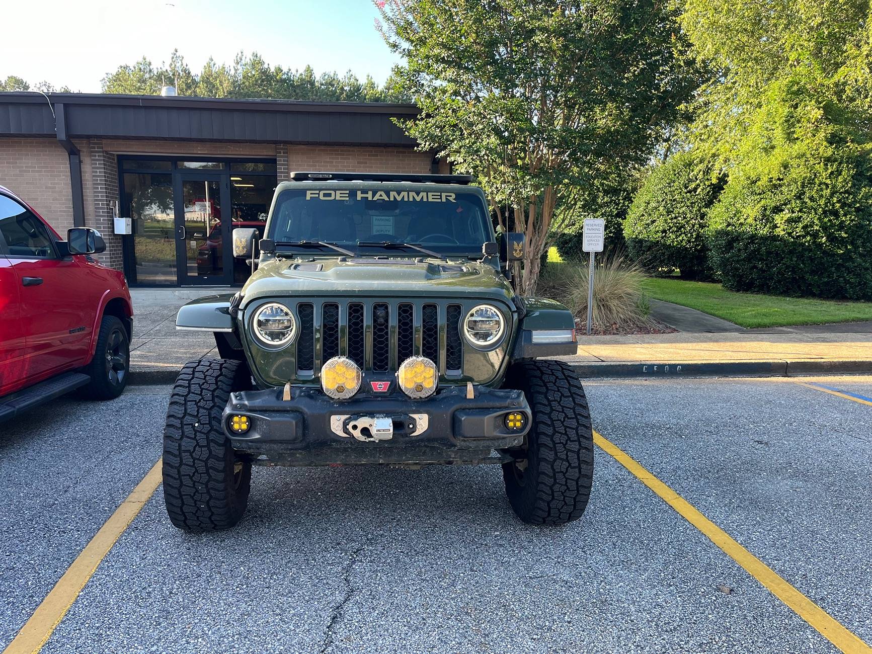

AAL bracket and light for my front fender chop- I don’t plan on doing the rear anytime
Soon- the rear plastics pieces are coming off anyway with my (soon to be hear I hope) next venture aluminum rear bumper. The fronts though- I went with dv8 inner liners a long time ago, helps with ventilation too. The install video helped guide me along, and I love the look afterwards. Def helps with my 37s and 2.5 Clayton lift. While I have noticed the real lower part flop a little on the highway at 65+, the fenders aren’t going anywhere- I used the AAL fender hardware with the bolts and nuts sets. That puppy ain’t coming off. I might think about trying fabricate some sort of support for the button if it really starts bugging me. So far, no complaints. One image has the oem and the chopped look side by side. (I did mine one at a time over a weekend…ran out of time)

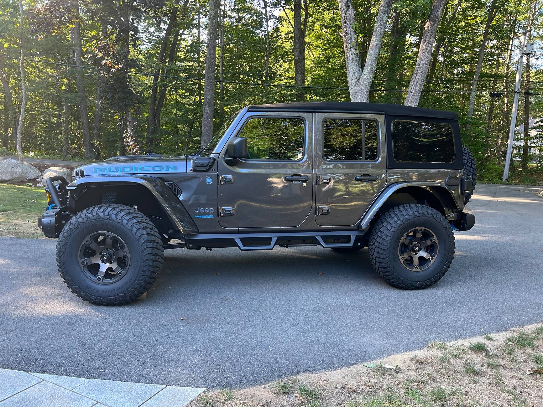

I love the look of mine after removing the cheap black plastic fender liners. Got the AAL lights and some Barricade metal fender liners and looks bad ass! So much more room. I have a Mopar 2” lift and 37’s.

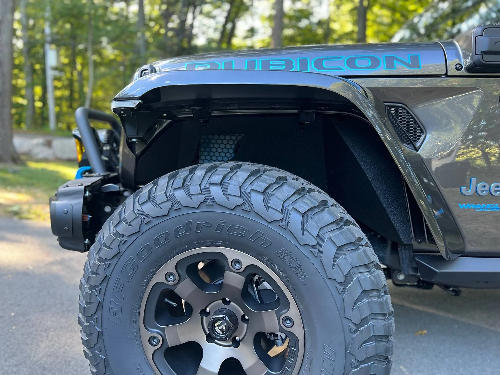

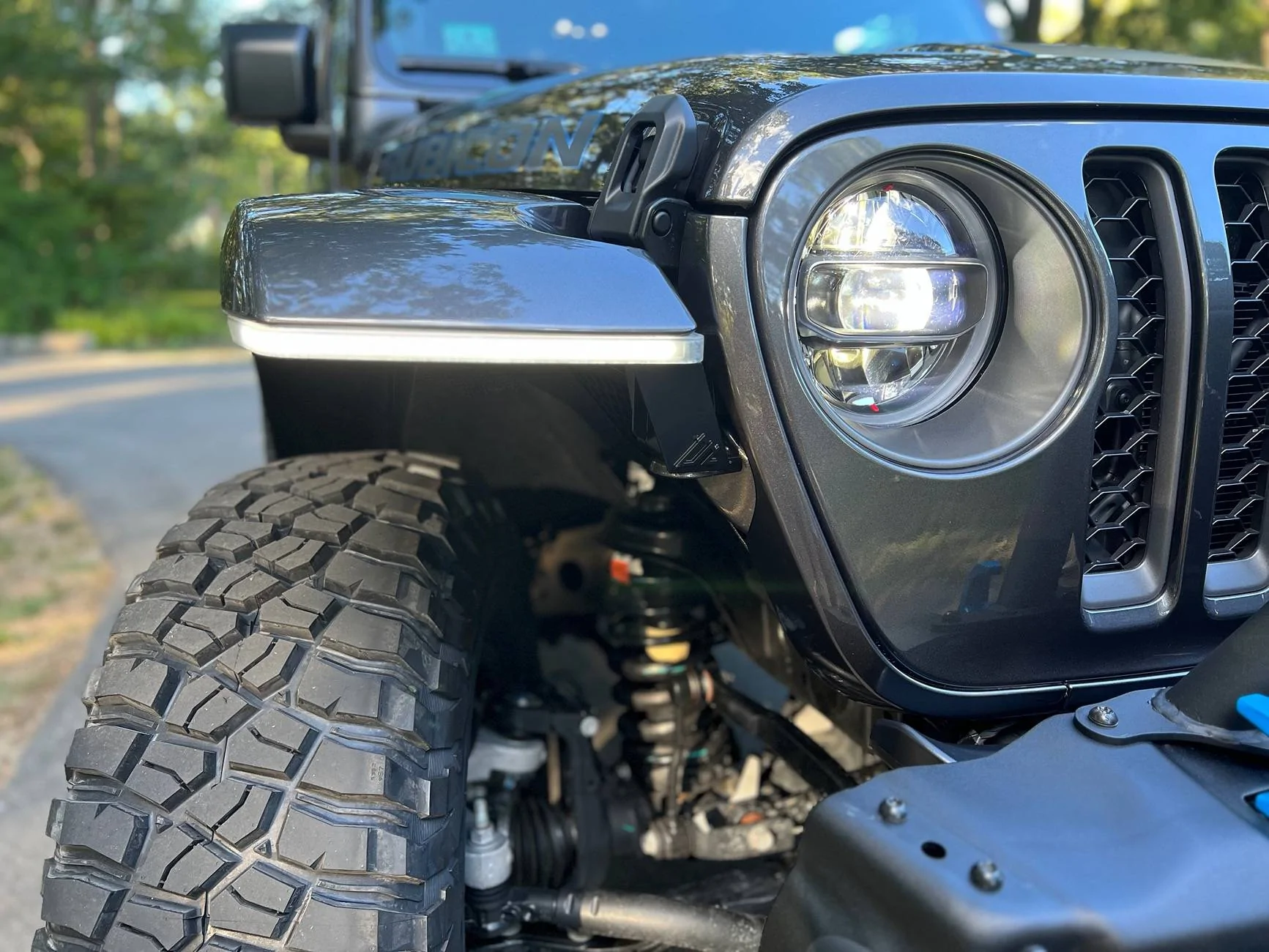

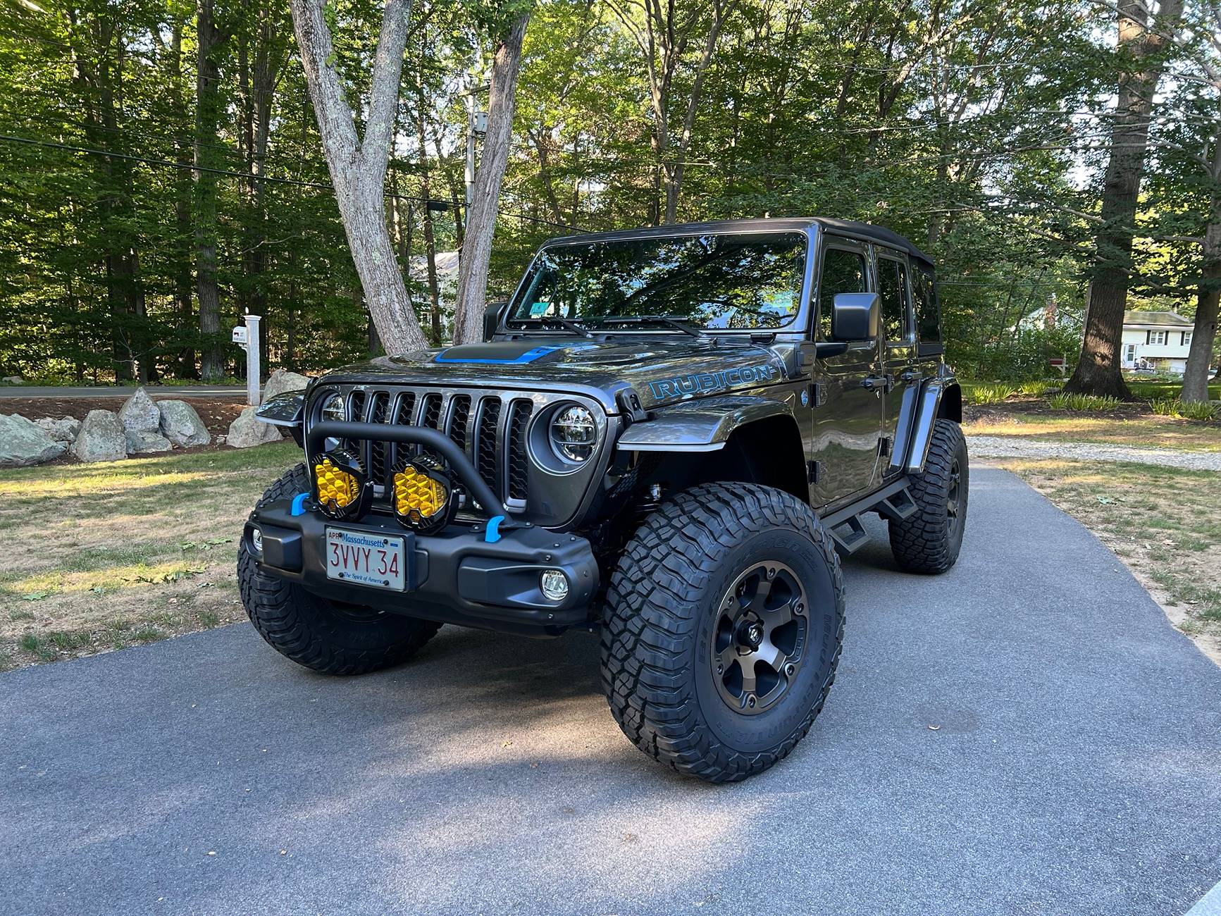

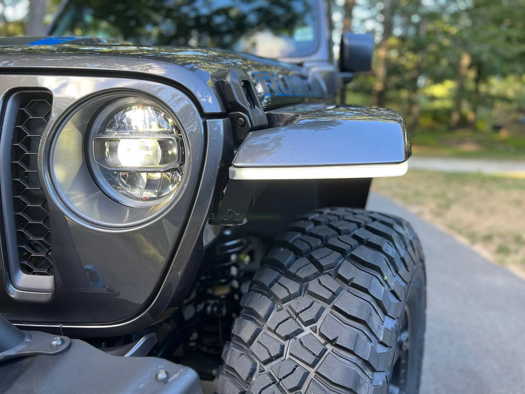

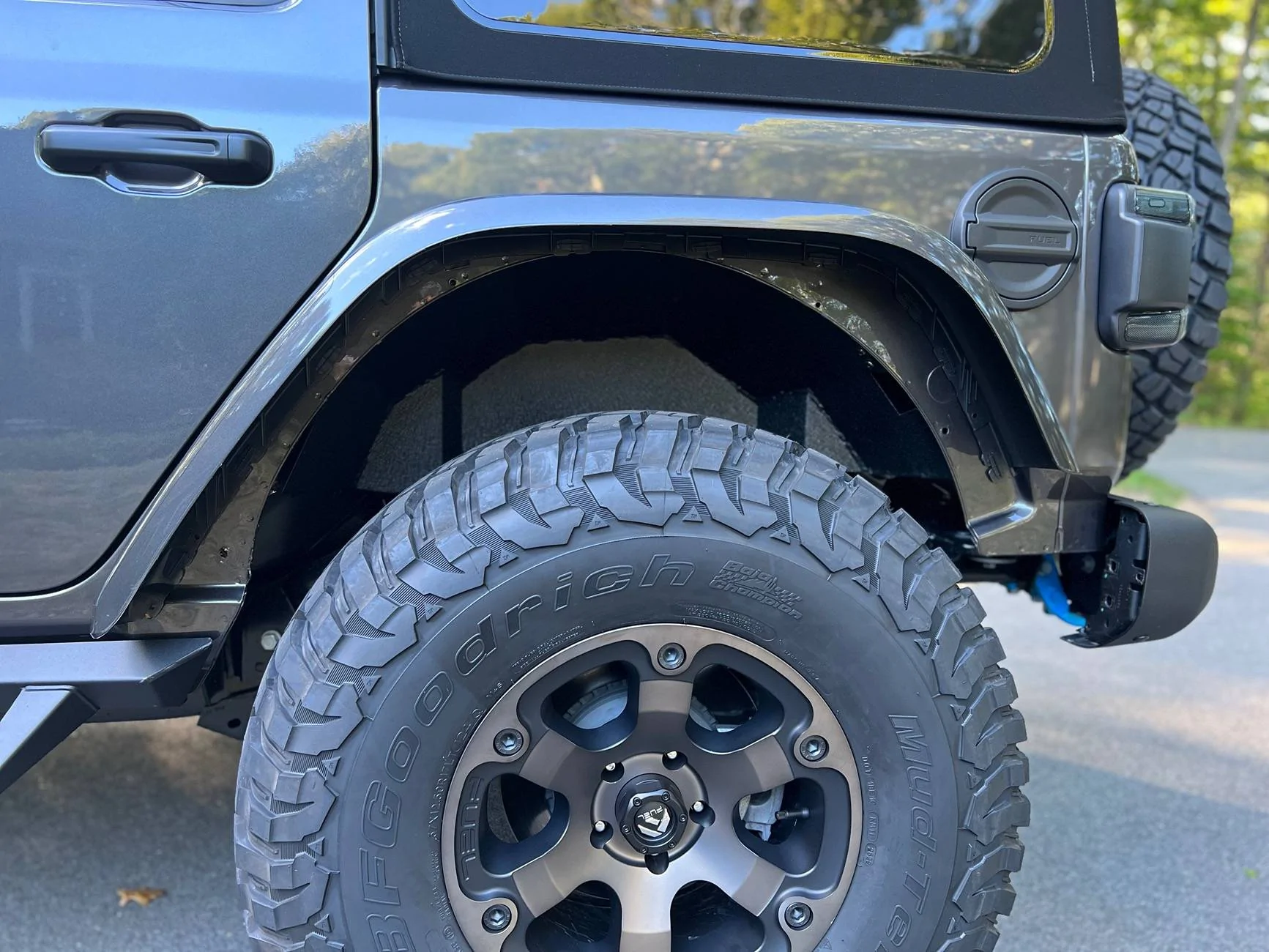

Here you go! I have to say the AAL light brackets rust out in no time here in New England. They should make them out of aluminum.

Inner fenders are Barricade, holding up well!
