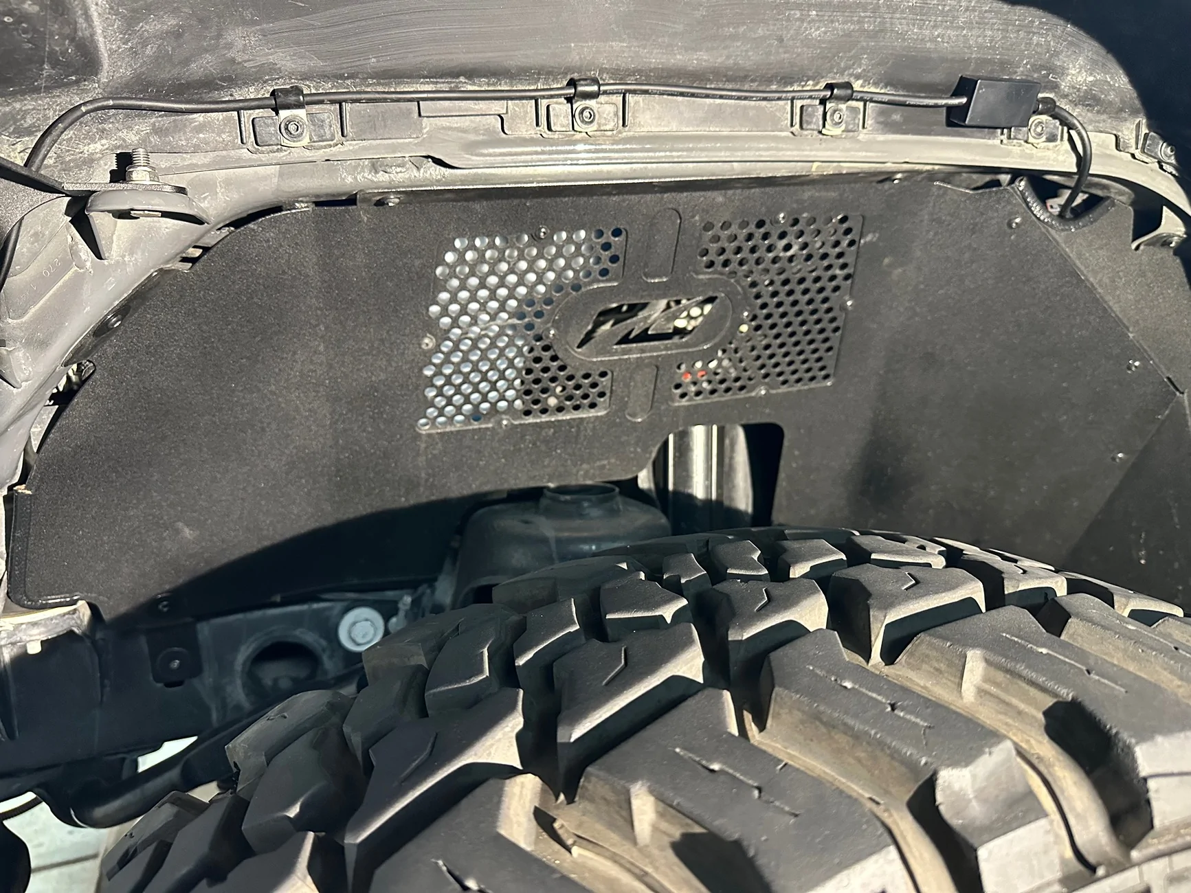

How did you do the chop while keeping the bottom edge and flare extension as shown in image on the left? That's what I am looking to do but can't find a video that shows how it's done.
Did you have to keep the factory liner? I'd prefer to do an aluminum liner while keeping the flare extension if possible.
I found that the Motobilt rear fender liners had less clearance than the OEM plastic. These aluminum liners are all pretty much copies of each other. After the rear fender chop, I ended up ditching the aluminum Motobilt liners and putting the OEM plastic liners back in, with trimming of the liner itself.
