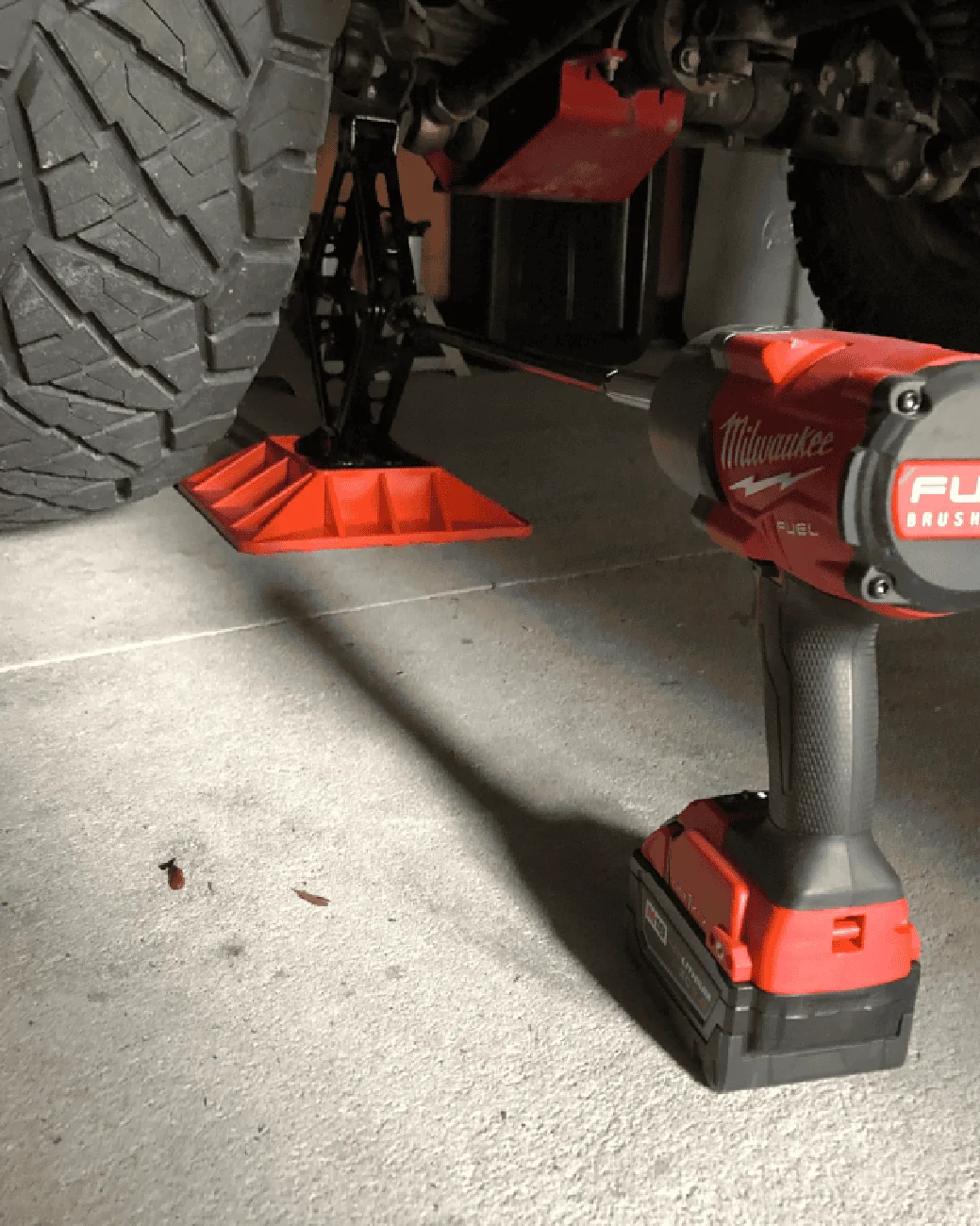

I use a hi lift jack base with the factory scissor jack…it’s nice and wide to help with softer ground…… I also use my M18 impact with a 13mm socket to spin it, raises it in seconds……
Where did you get that? I want one.

Amazon….. type in…. Hi Lift jack base, there’s a few different ones….

Yeah, I tried a lot of different things, hi lift, bottle jack, etc….. But since I only need to lift it a few inches to change/fix a tire, I came up with this idea, it’s simple, and the jack is already in there so not taking up any more space….. the base sits in the rear cubby with a few other things…… works out great, best part is not having to spin that crank by hand…?
