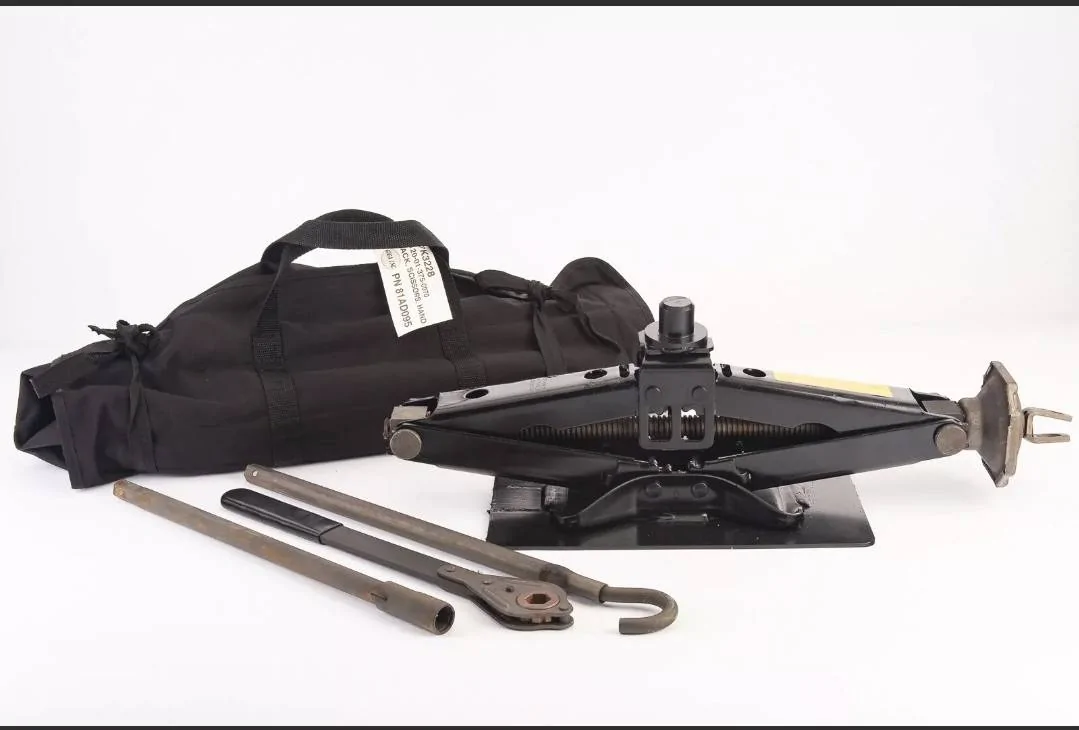

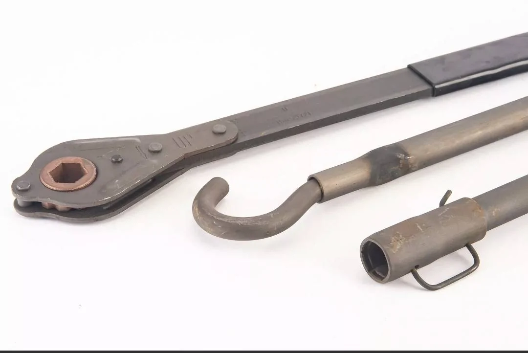

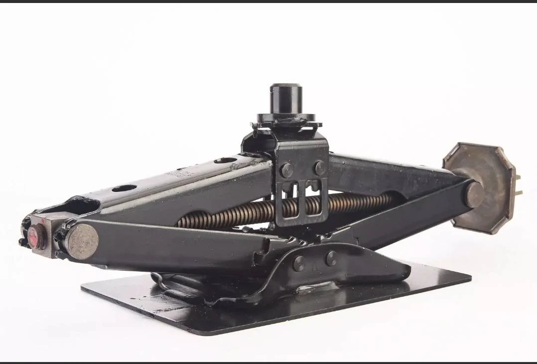

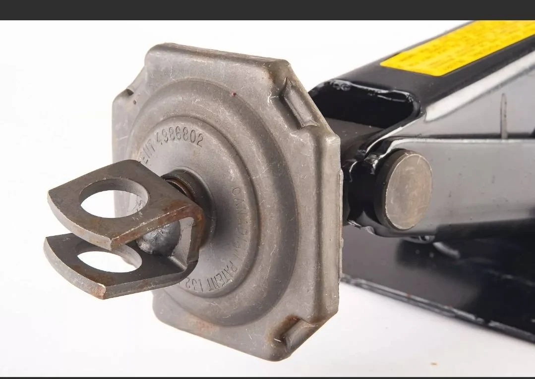

I did this: ?
HMMWV Jack
Looks tough, but cant find it for sale anywhere, i see it with a hydraulic pump, but not this one, would you mind posting the link or name of site ? tnx

@AC77 A couple of years ago I bought two of the HMMWV jacks in unused condition off eBay for a decent price. I also bought an Agile Off-road Adapter but a similar bracket could be fabricated for much cheaper. It seems like the jacks have become scarce and expensive. Also the jack does take up a fair amount of real estate inside the Jeep and does not even come close to fitting the factory jack cubby, so something would need to be fabricated to prevent injury in an accident or rollover.

You can find Humvee jacks on eBay. I think there's another thread about them and an adapter to put on the stud on top of the jack
thanks for the info ?
