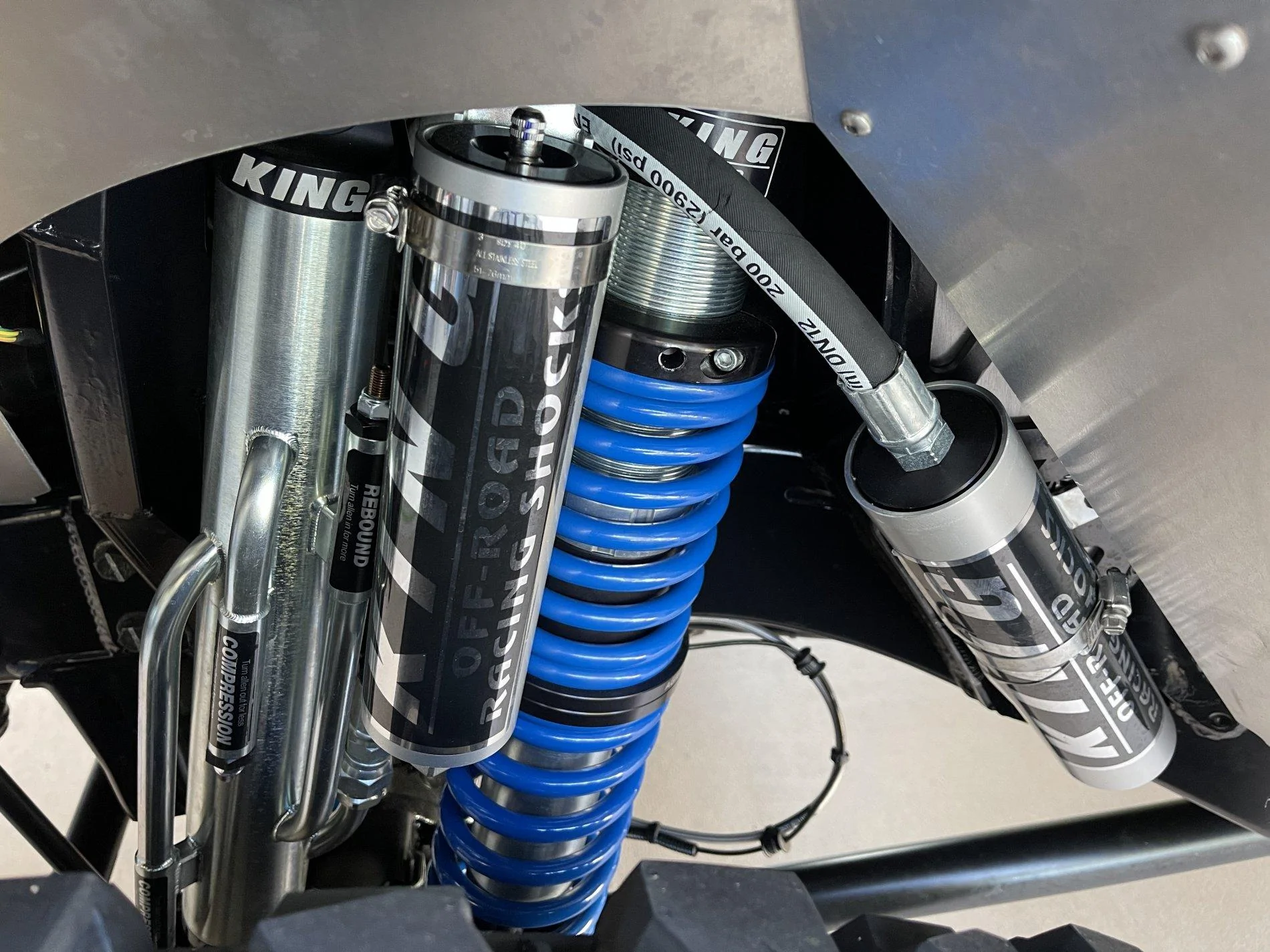

They are 2” 2.0 bumps. I actually think i can thread them up a little further for a bit more up travel, but I haven’t had a chance to get it back on a lift to cycle everything.
After changing to the AGM sliders, the only noises I hear are when the slider makes contact with the timing rings or when the bump stop makes initial contact with the king bumps. That said, those noises can only be heard driving slow in places like a parking lot with the window rolled down. Overall, MUCH quieter with the new sliders.

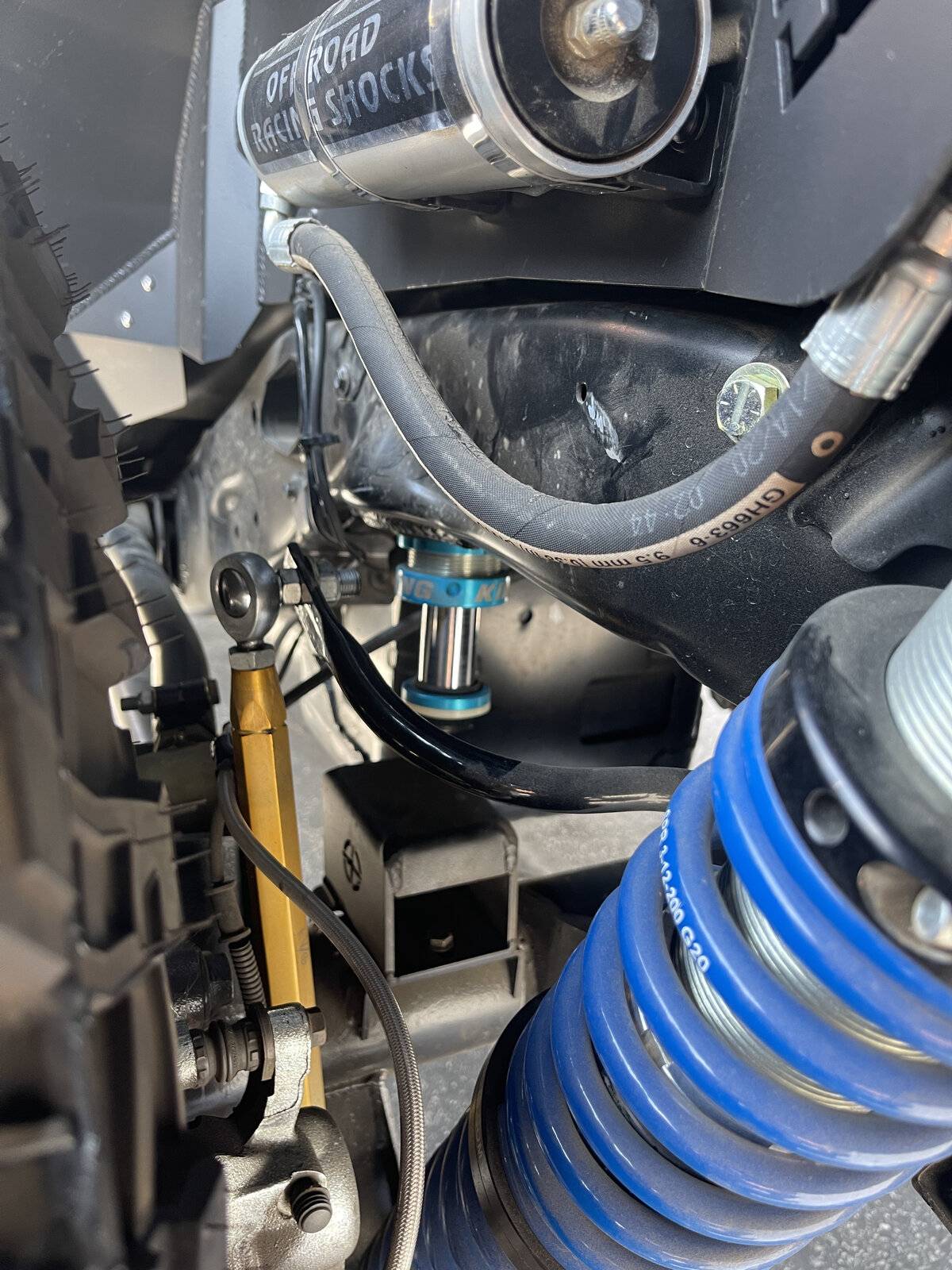

on the ud60s in the rear end did you use the stock brackets to come onto ud60s and the coilovers and the sway bar links fit? Can you post more detailed pictures of those areas near the brakes and the bracketry thank you, nice setup by the way.

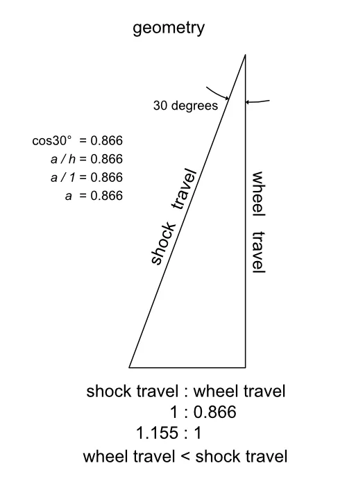

...I haven't measured travel but I believe it's a 13" stroke shock... how does it get advertised 15"?
...It should be a 12" stroke and the shocks are mounted 30 degrees from vertical. 1/cos(30*) is a 1.15 correction factor, 12 x 1.15 = 13.8" of wheel travel...

I dont measure 30 degrees i measure 17 degrees for front and 24 for rear. But i dunno how to math

Nah Evo didn't supply correct hardware for the swaybars so I skipped install all together. I picked up the hardware needed, if I put back on I'll post clearance pics for you!

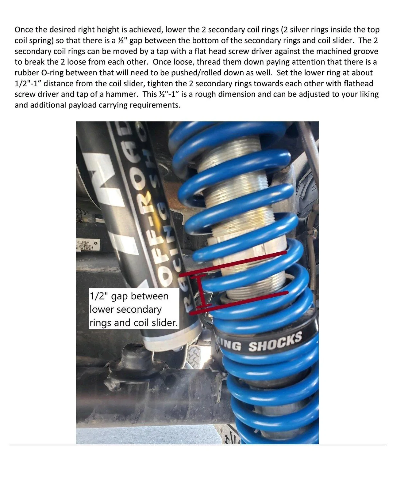

Another can of worms I opened on this build was the secondary rings on my jeep are no where close to the 1/2" mark, and all the way at the bottom of thread can go it seems to be a consistant 1.5" away on each corner
I can't believe they tell you to use a flat screwdriver and a hammer to loosen and tighten the lock nuts. Every C/O kit that I've had for road cars come with C spanners to do it correctly.
You cant really get a spanner in there to adjust the stop rings, brass punch or the like works better, i just use a screwdriver, they get all chewed up from the springs anyways so it doesnt matter to me at least

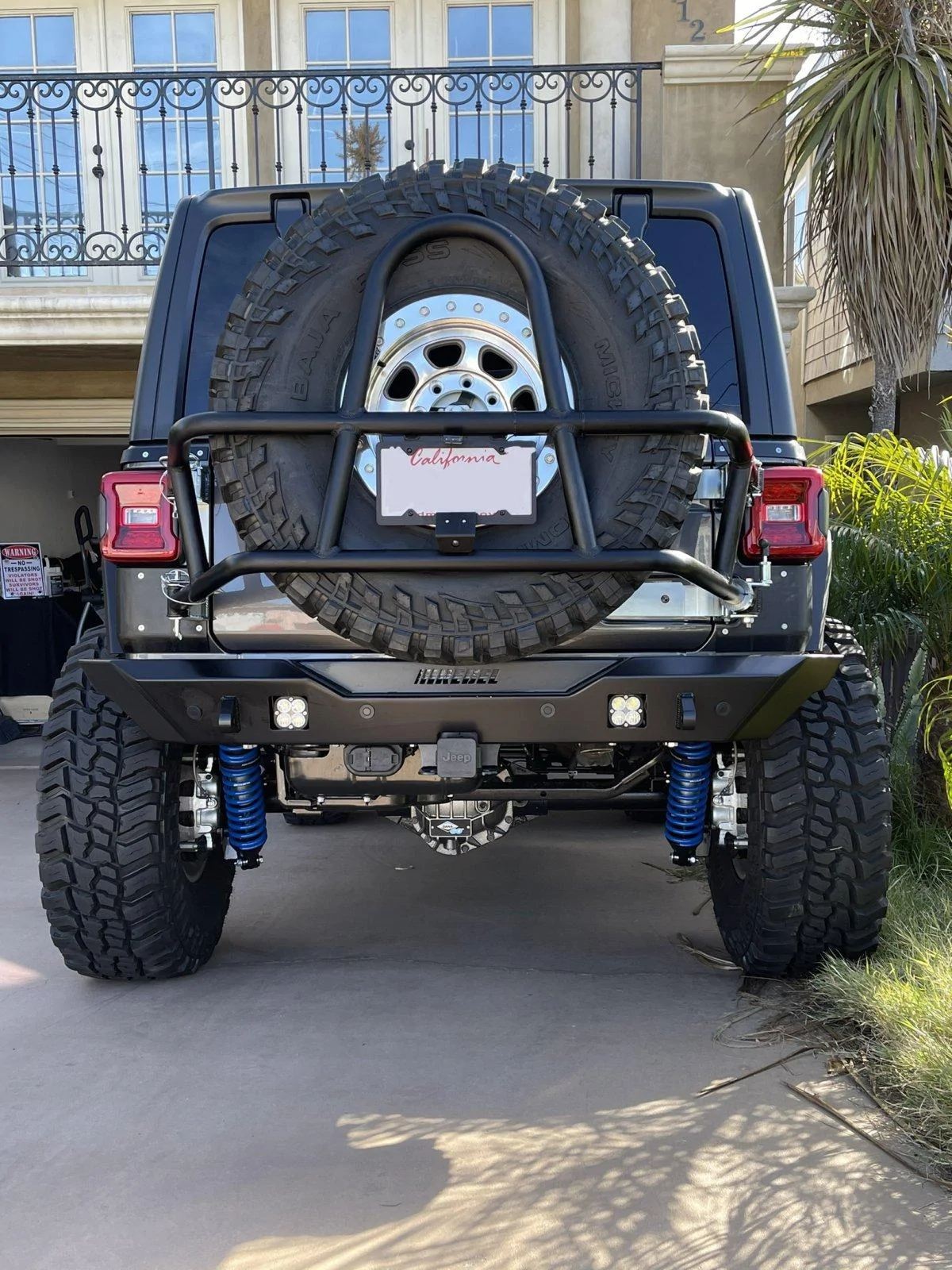

How the hell do you have so much clearance between your rear King bumps and the Axle???
I have the same bumps and same rear bolt on Coilovers from Evo and I have less than 2” before I’m hitting strike pad…. It’s quite annoying actually - can’t wait to replace these crap sagging King springs (with only 6k miles on them) with some Eibach ones appropriately tuned for my setup!!!
Edit Before I post: looks like this goddamn Evo strike pad extension is in the way on mine….

Yessir, remove it and adjust bump down accordingly ?? I have the foxs in the rear but no bump pd on the axle
