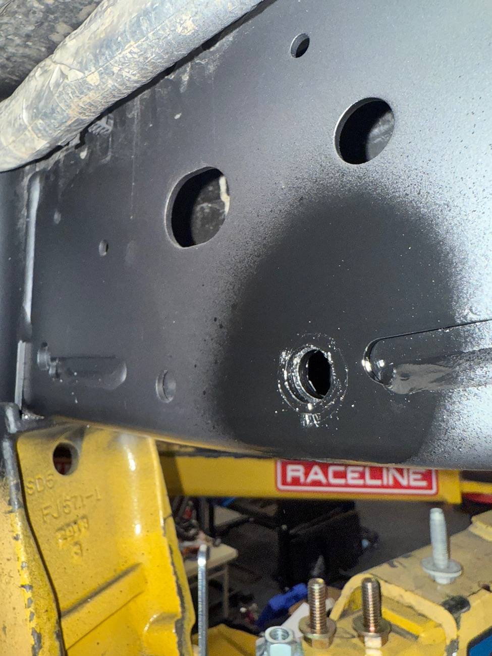

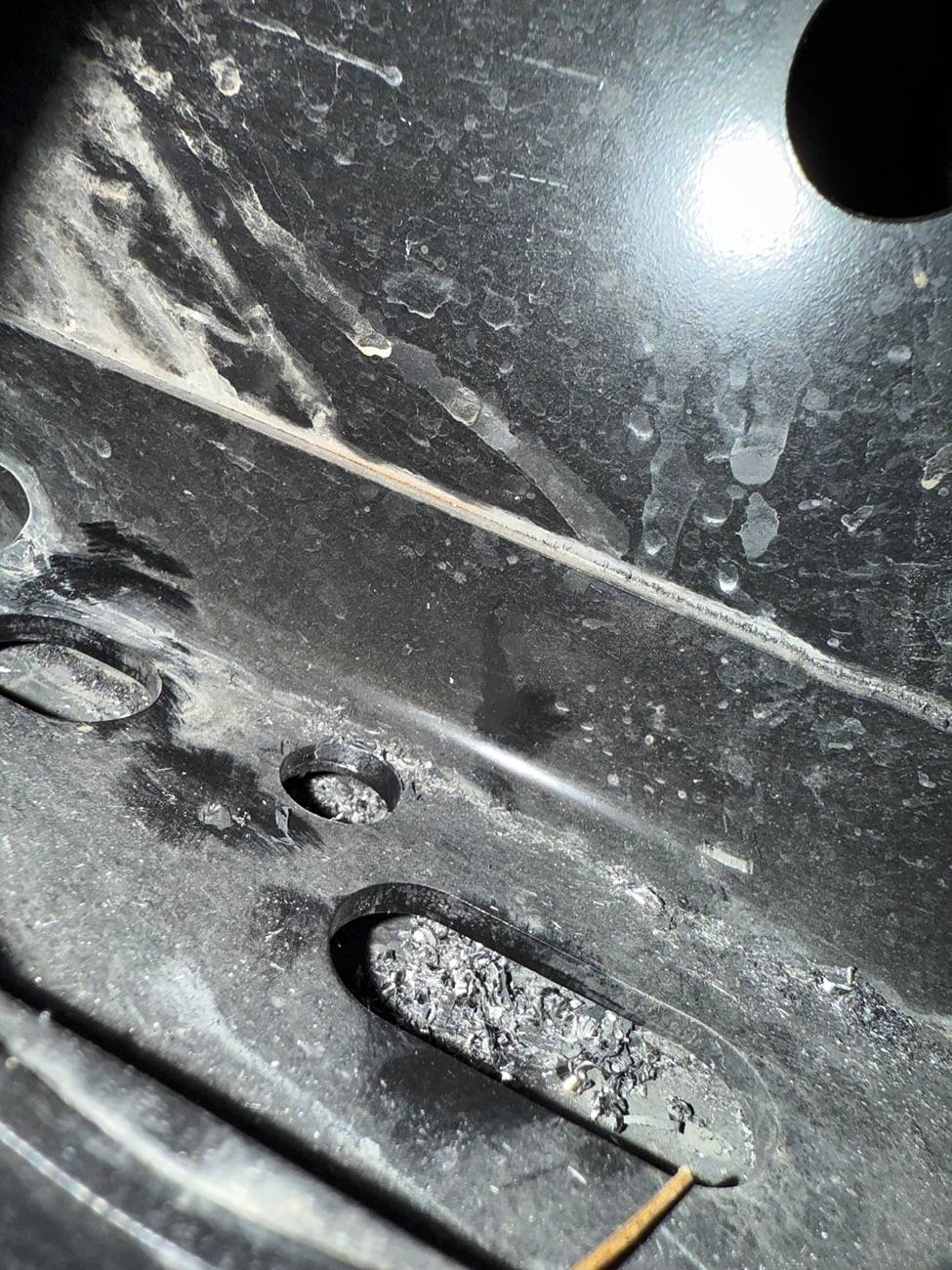

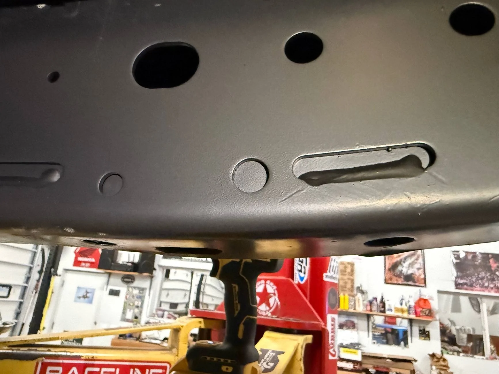

I’m finally in the process of installing this kit. There are definitely some things they need to fine tune. First thing I ran into is that the 392 has some internal frame bracing in the front frame rail that required buying 4 longer bolts. The front hole you drill in the bottom of the frame you can see here required 1/2” longer bolts than they included.

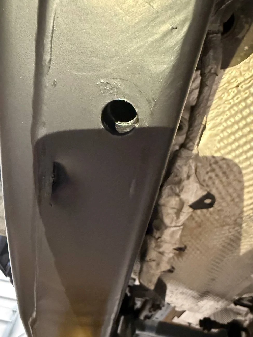

On the side you can see the hole in the main frame rail that had to be drilled through the inner reinforcement. That required 1/4” longer bolts.

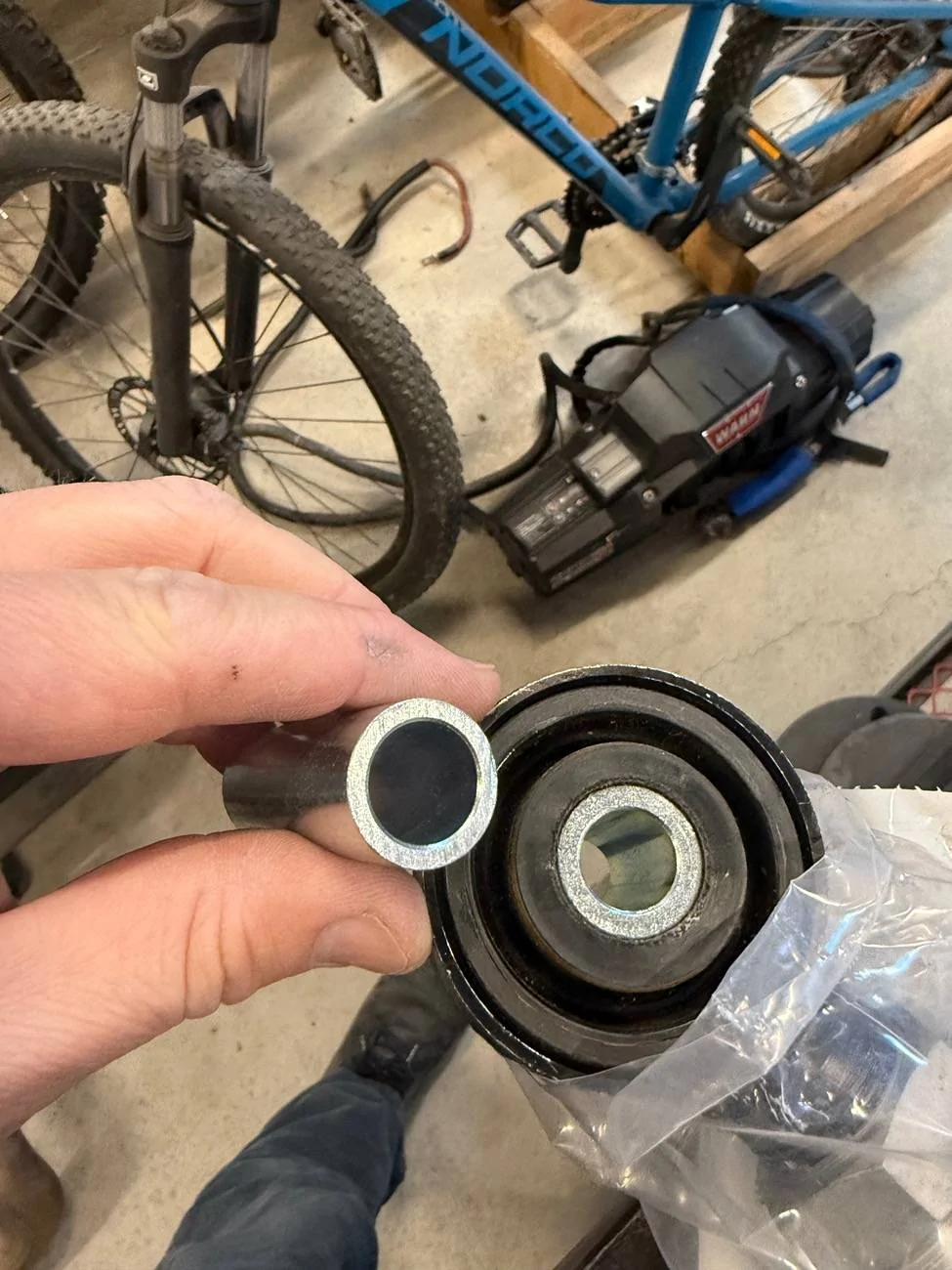

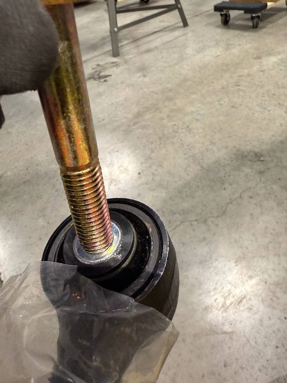

Then moving to the rear, they have the inner metal sleeves on the lower control arms reversed. The ID of them need to be on opposite sides. Thankfully you can just swap them as the OD of the sleeves are the same.

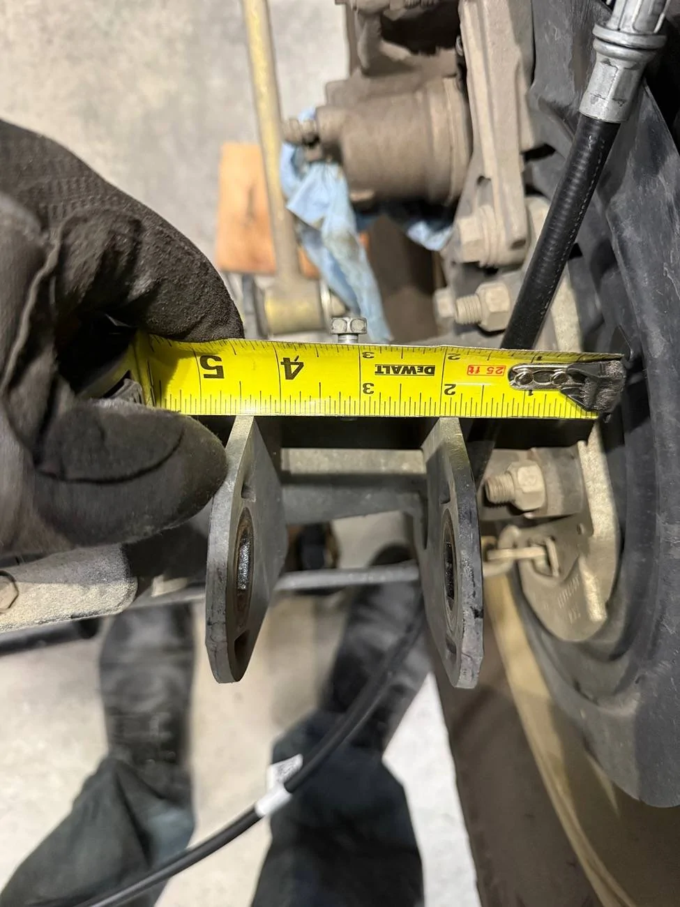

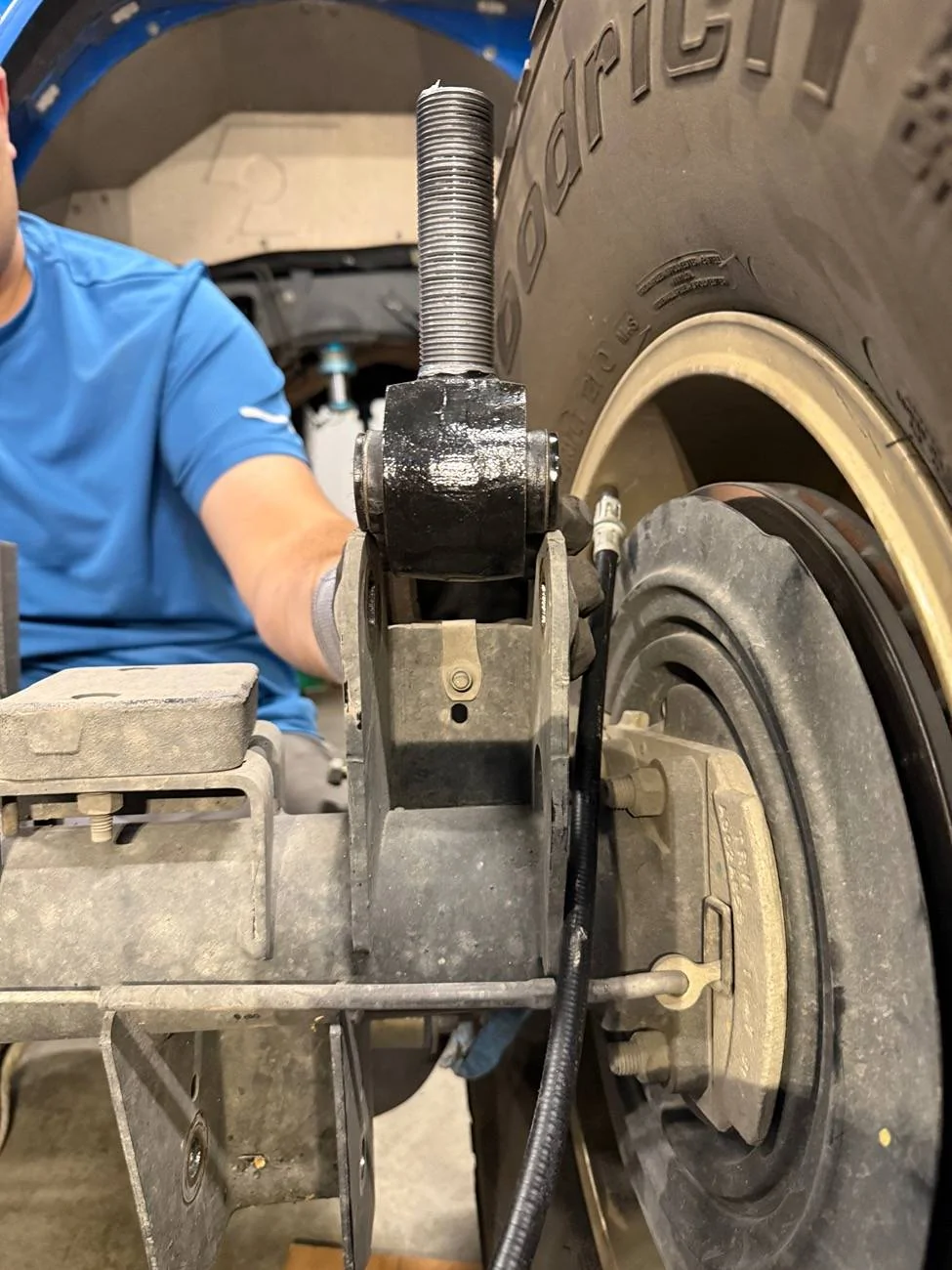

And to end my day, and my progress, the rear upper control arm bushings don’t fit into axle mount brackets!! 🤬😡 The bushings are just over 1/4” wider than the bracket!!!
Jeep Wrangler JL Synergy High Clearance Long Arm IMG_2795
Jeep Wrangler JL Synergy High Clearance Long Arm IMG_2799
Of course I discovered this about 7:00 on a Friday night. I emailed Dave, the owner of Synergy, on the off chance he’ll check his email on the weekend. But, it’s not like he could do anything until Monday anyway. I’m just SO ANNOYED.

Synergy replied to me on Saturday saying they would reach out Monday. I had to call, twice, but they are sending me the proper bushings to press into the control arm ends. They discovered that their BOM (Bill of Materials) was wrong. I’d imagine they’ll have this fixed before they ship any more kits. Those should arrive Wednesday, but then I’ll be out of town for Turkey weekend. They assured me I can press them in/out with my cheap 12 ton HF Press.

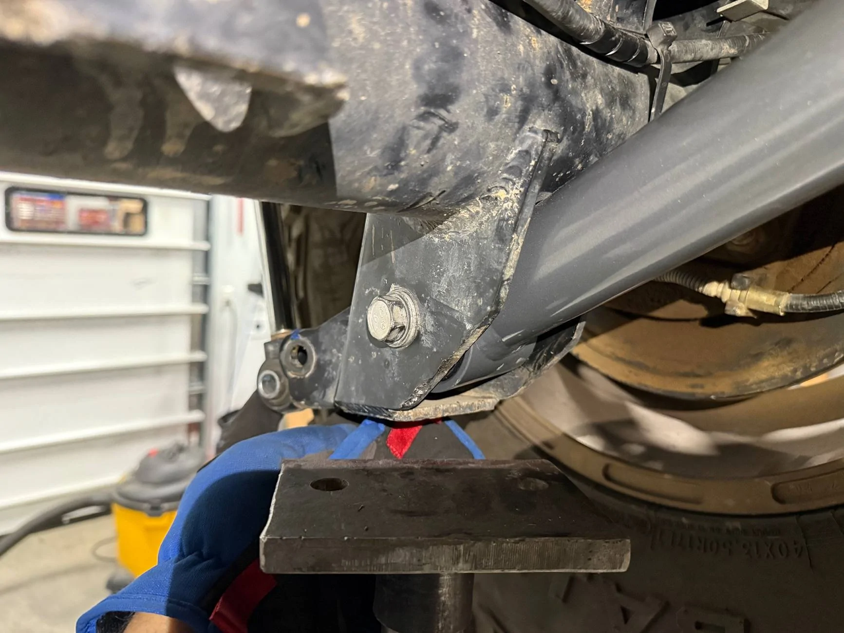

Not yet fully, too many life distractions in the way. I was able to get pinion angle set today though. I have the arms adjusted essentially as far rearward as I can to help the clearance for 40”s. The rear LCAs do limit the droop to 12” exactly (not really droop from ride height, but hopefully that makes sense). My shocks have 12.5”, so I’m losing 0.5” of droop. I plan to call Synergy next week (it seems most companies are short-staffed for the Holidays, and I’d like to talk to someone who actually knows something) and see what they have to say. I will say, adjusting arm length, castor, pinion angle, etc. was SO MUCH easier than with the WFO kit. So nice to just turn the adjuster!
Here you can see the arm hitting the axle tube and my shock Has another 1/2” of travel.

Thanks for the update.
Yeah, if pinion angle is already optimal at ride height, then that is strange as I would expect the travel to be far more then 12" from a long arm.

Like 9.5° and driveline is at 10.5°.
