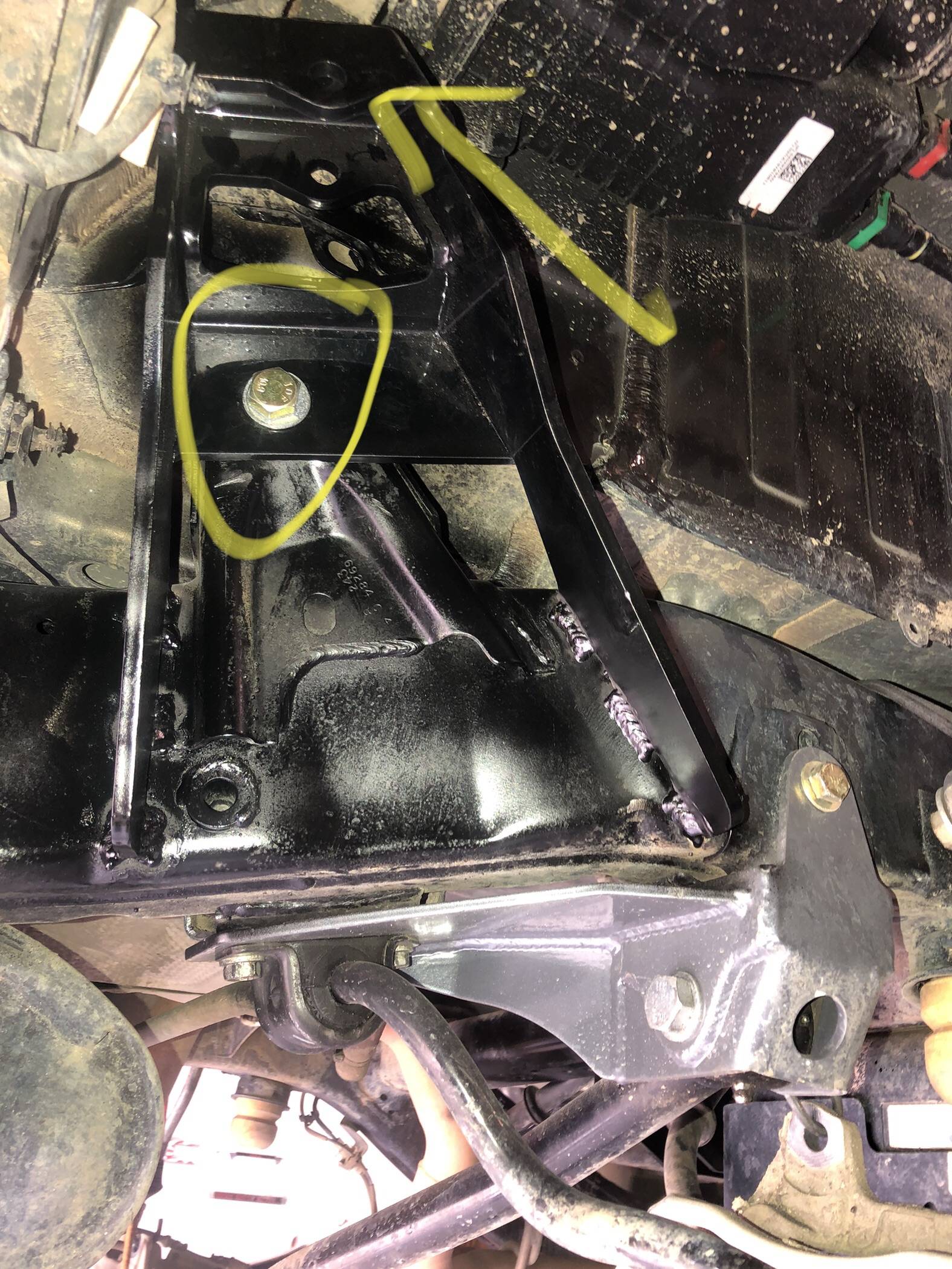

The biggest gain is the rear axle lca/shock brackets. RK lifts them 3-1/2”. The bolt circled is where factory shock mounts, and the arrow points to new mounting location…..

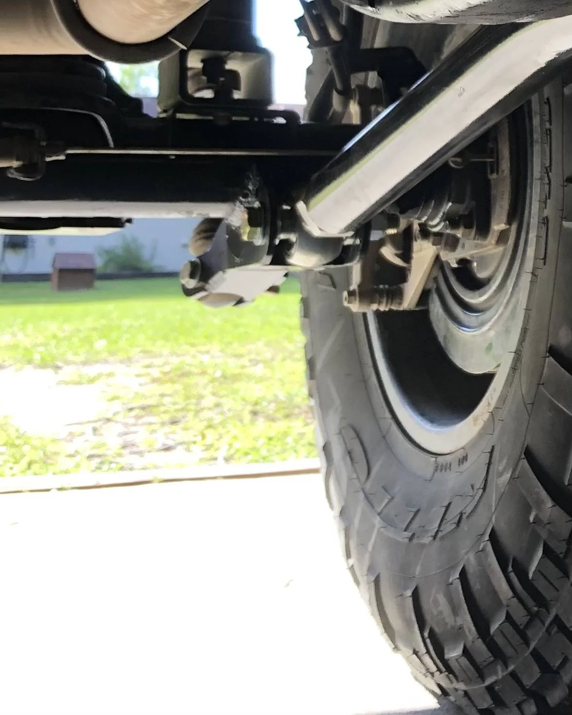

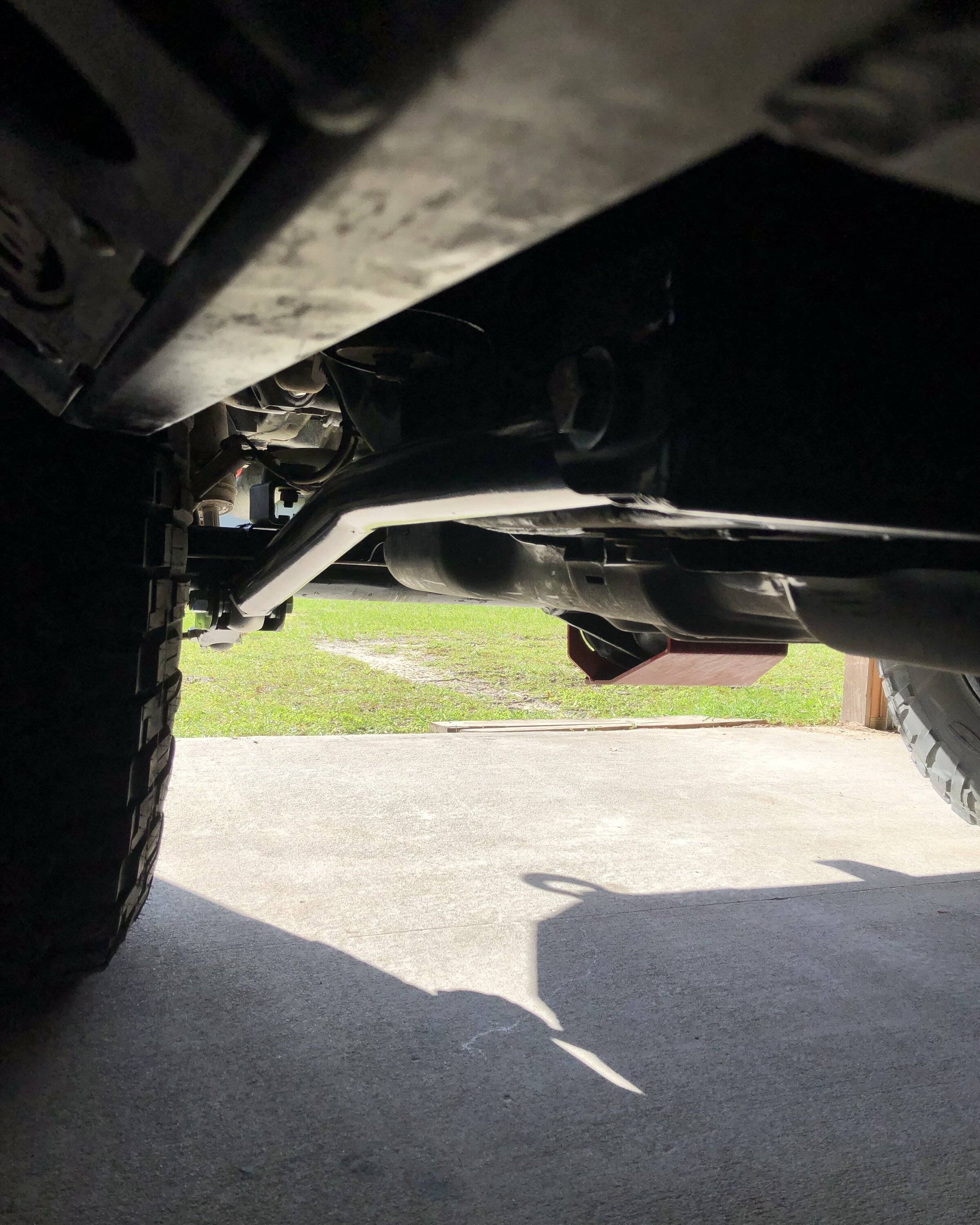

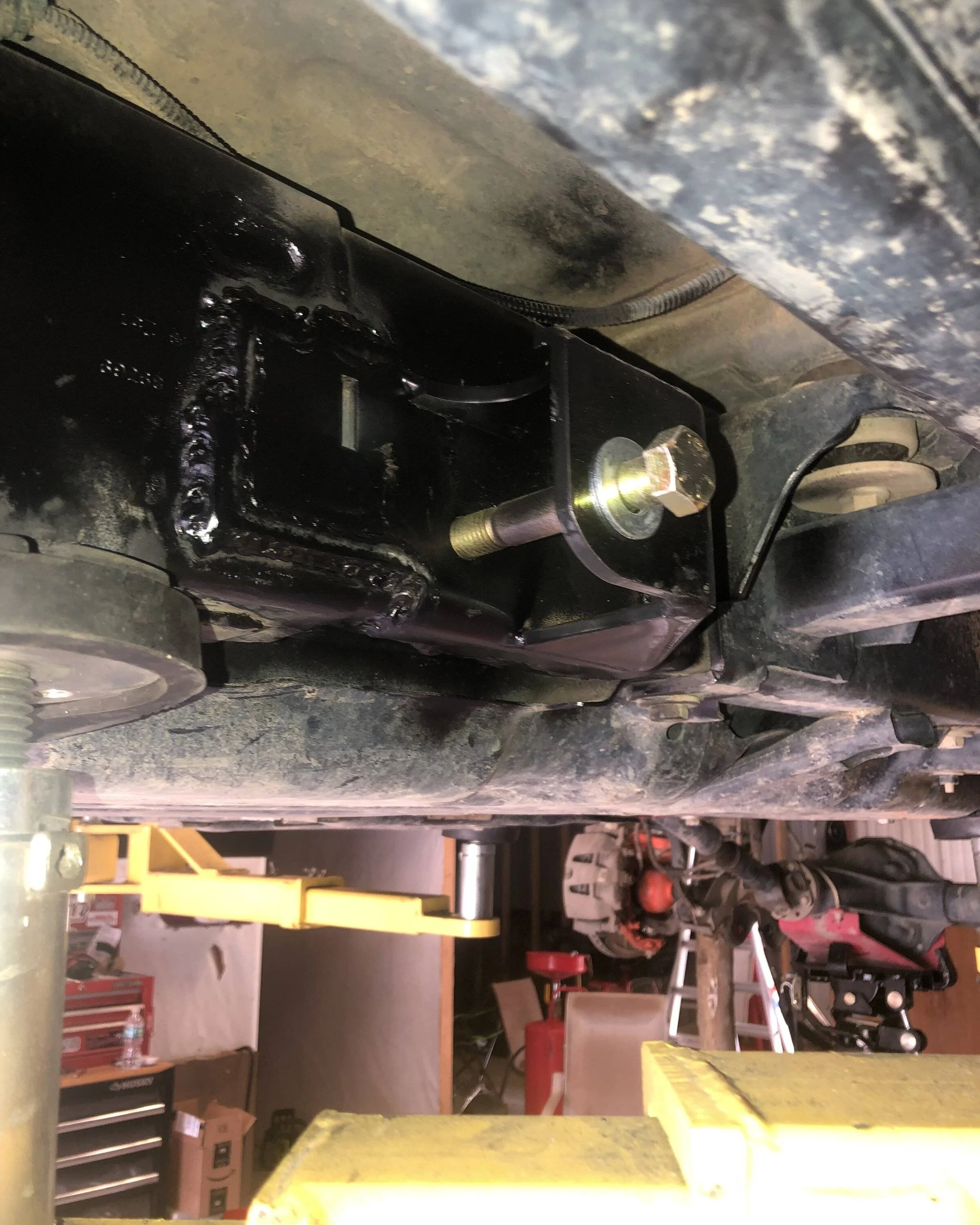

And here is some different views of the arms/brackets………
Jeep Wrangler JL Long arm rear lower arm mounts FAEA115D-3A1F-4F76-9711-F64A65BB66B7
Jeep Wrangler JL Long arm rear lower arm mounts F7CA2385-8BAC-40AA-8593-C6C524CFC707
Jeep Wrangler JL Long arm rear lower arm mounts 0DE9FA76-3D8A-4A6B-B289-68E9FB17B391
Jeep Wrangler JL Long arm rear lower arm mounts C82CB9EA-C7A8-4216-9D70-CC199E29CF5D
Jeep Wrangler JL Long arm rear lower arm mounts A437B976-C782-4433-BE51-5017C37CD677
I’m not debating what’s better brackets or arms , they both play their respective roles depending on the consumer and how they use their rigs, I just want to clear up the misconception that you’ll lose ground clearance going to long arms, some you will but not with this kit….

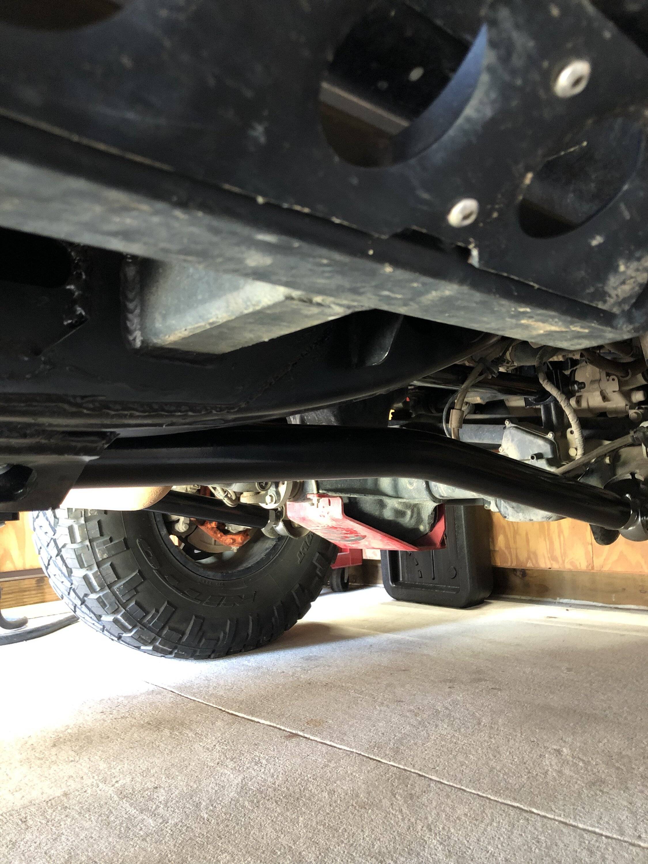

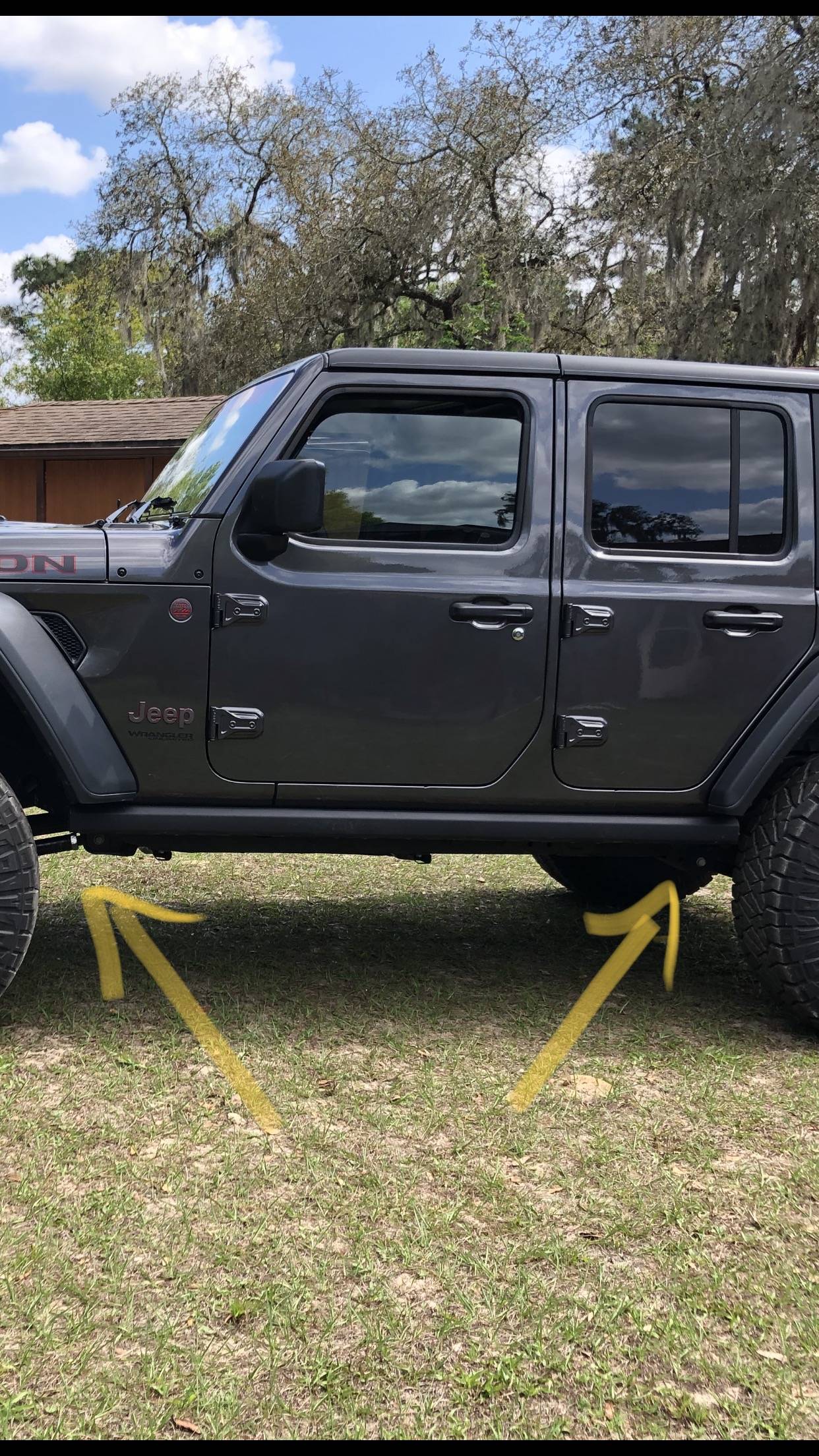

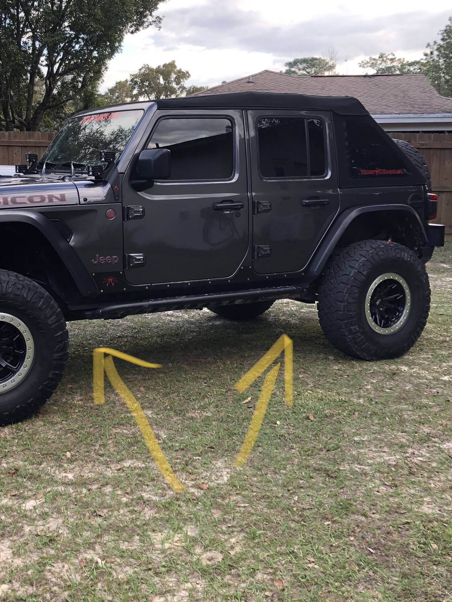

Unless it’s a RK long arm kit…..I increased ground clearance going to their long arms…..
Before……
I
after……

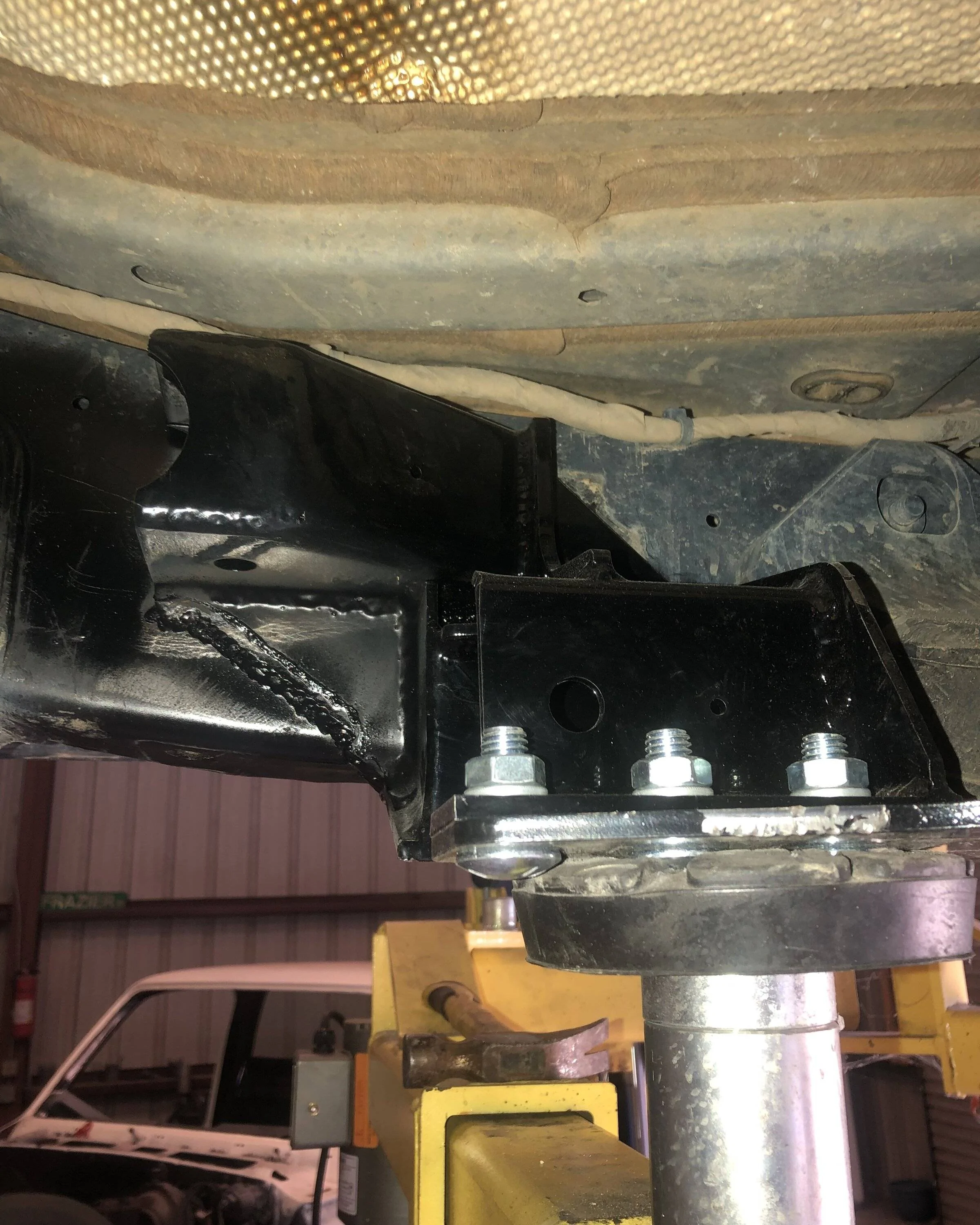

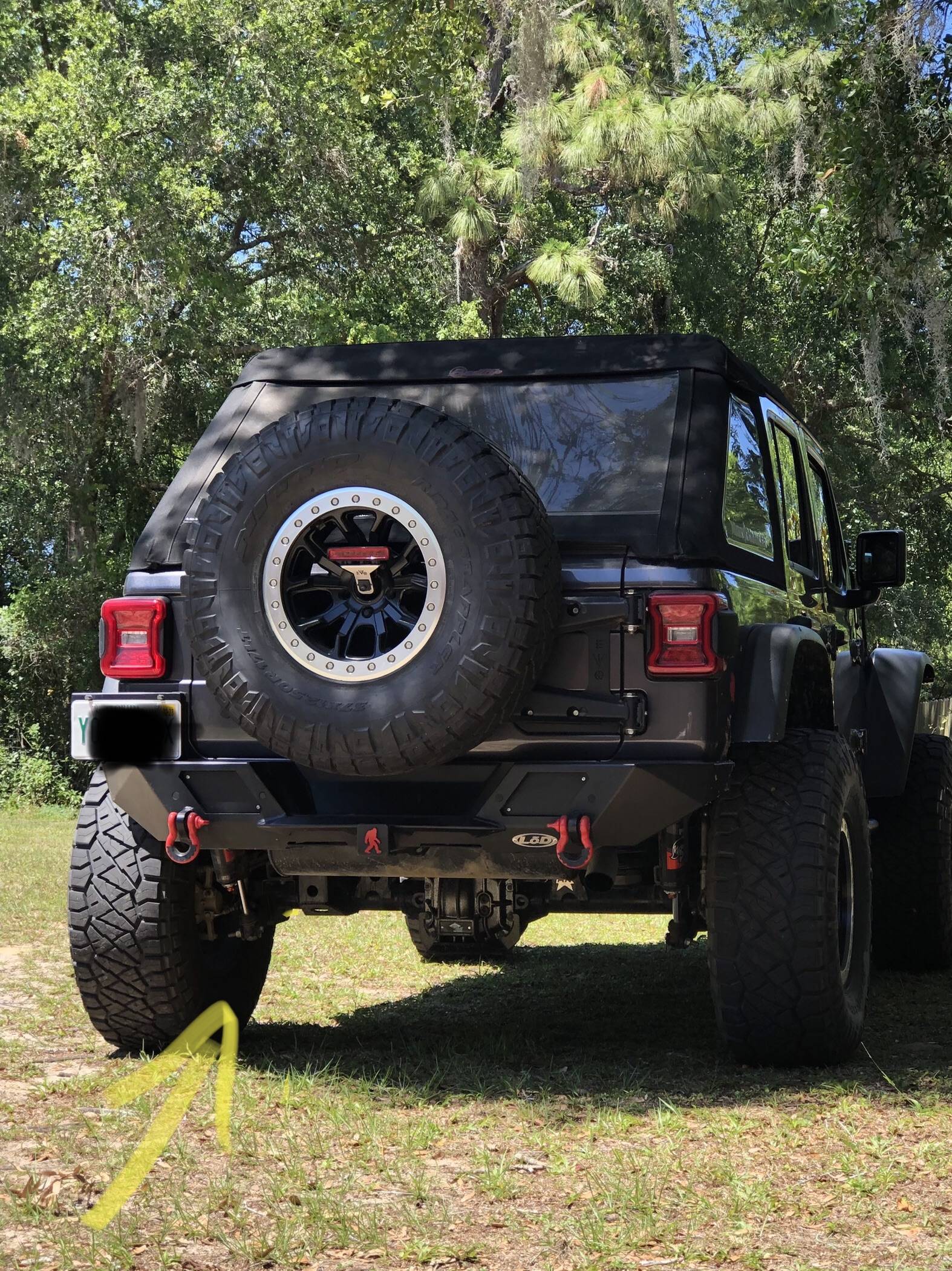

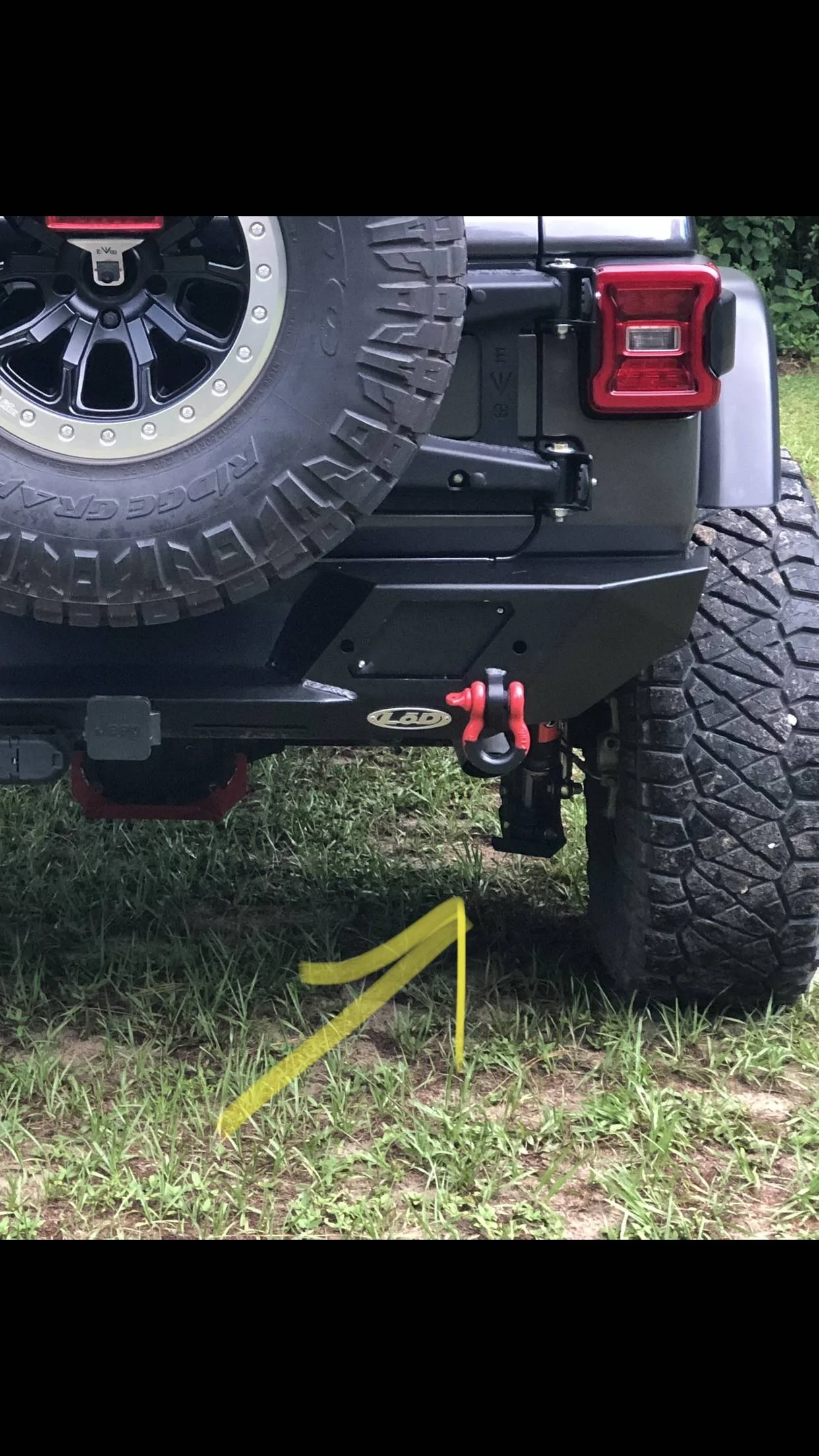

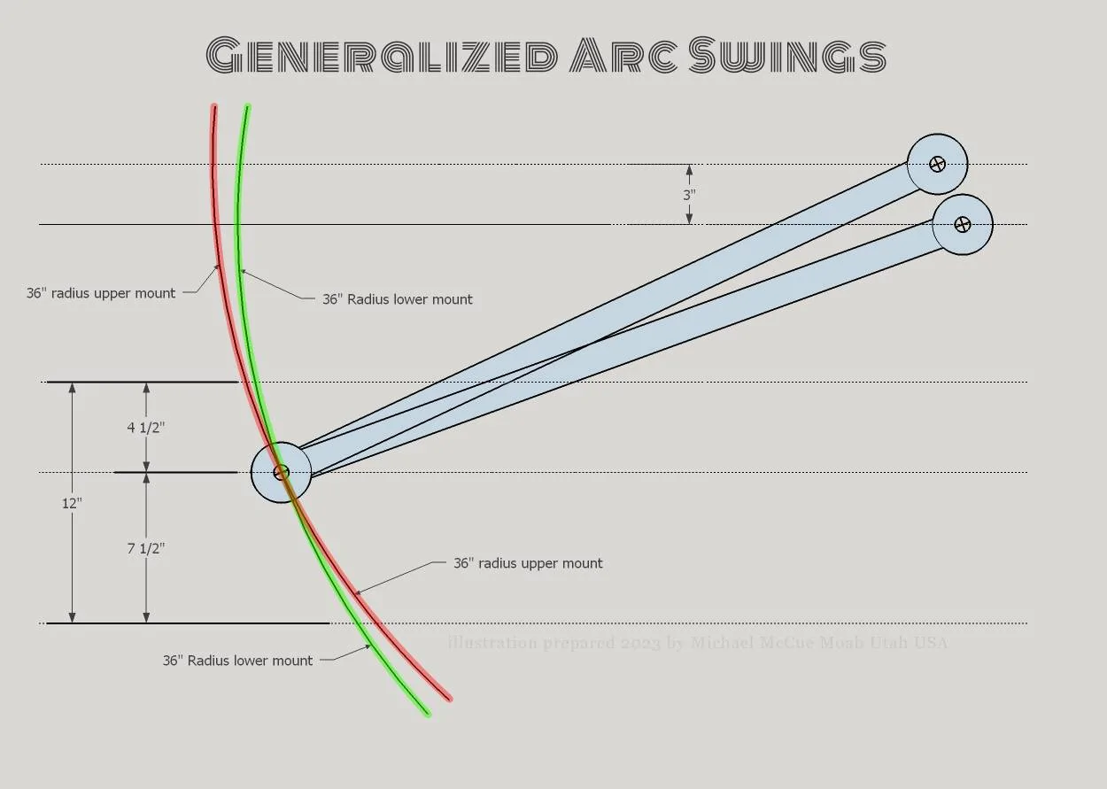

Gaining extra ground clearance is desirable.
With regard to arc swing, raising the frame mount point has the opposite effect of lowering the frame mount point.
Trade-offs.
