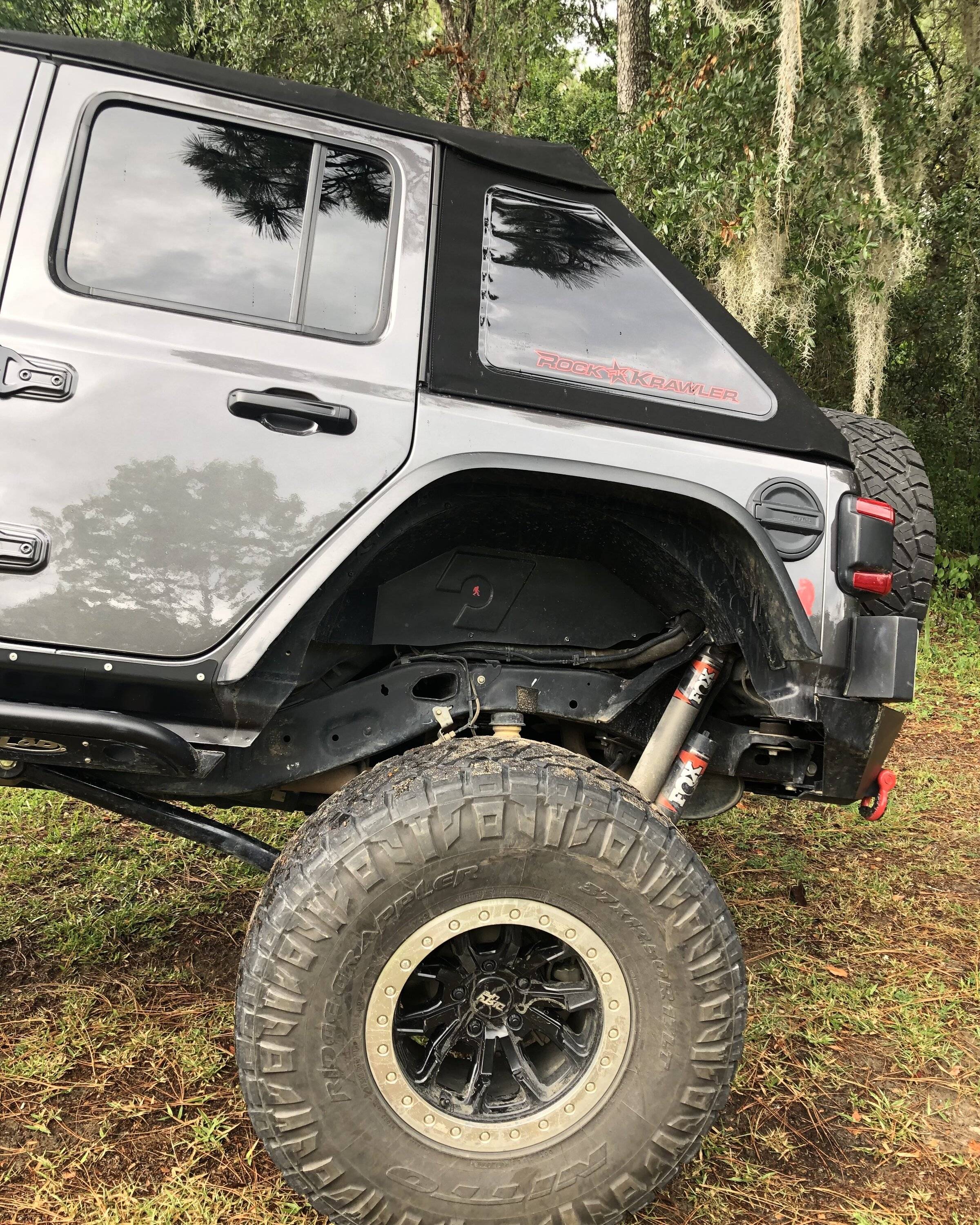

Nah the rears are mounted up inside the frame rails, just wondering what bracket you used, it looks good. These are the accutune brackets:

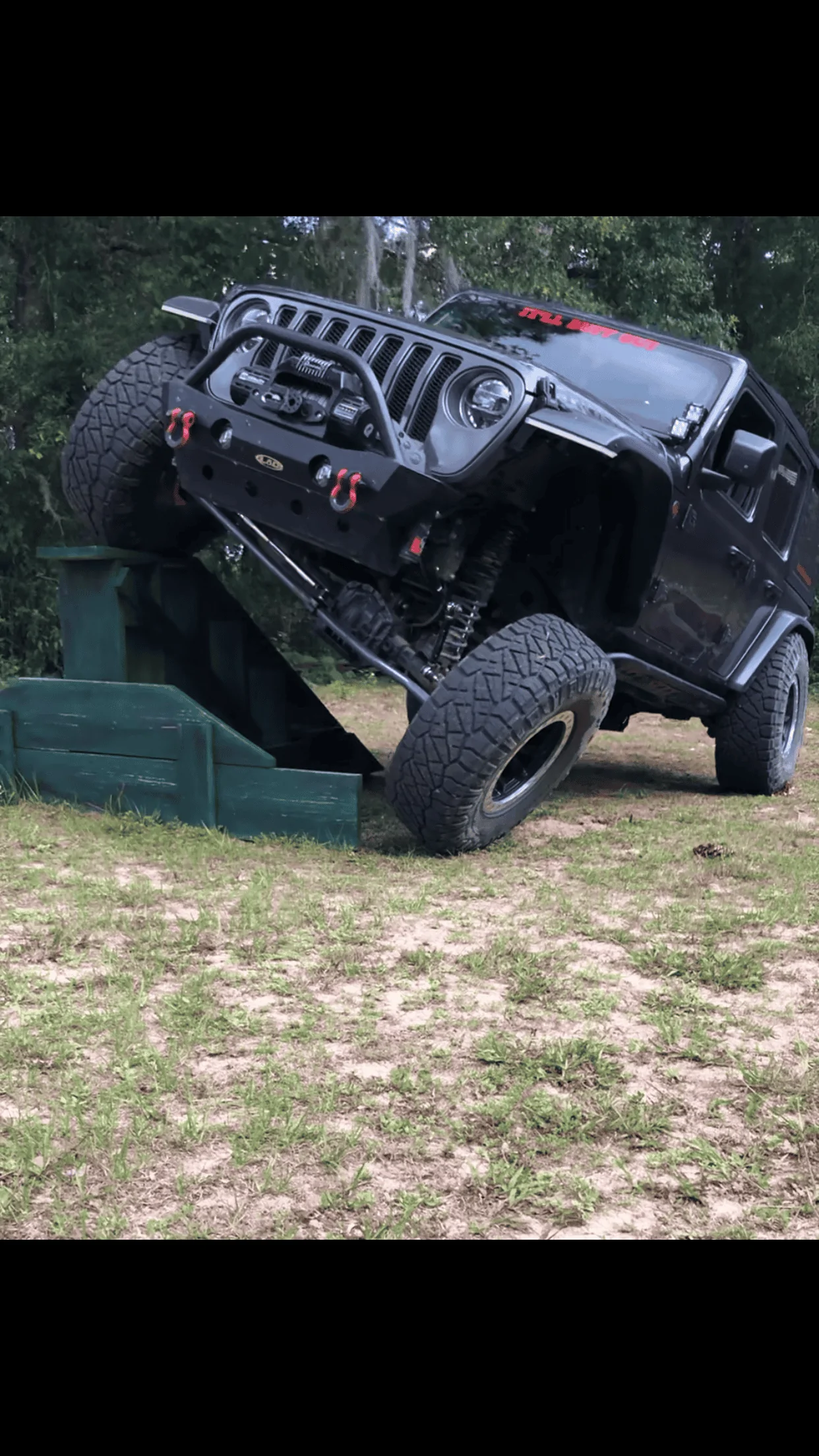

It's not 1:1 at least on the back. It should be a 12" stroke and the shocks are mounted 30 degrees from vertical. 1/cos(30*) is a 1.15 correction factor, 12 x 1.15 = 13.8" of wheel travel. A bit of a simplification and it assumes there is no binding and it assumes your jeep is perfectly bumped. But a pretty close estimation, and they advertise 14" in the rear.
In front your shocks should be a 14" stroke mounted 10 degrees from vertical. 1/cos(10*) = 1.015, 14 x 1.015 is 14.25" of travel. They advertise 14.5", again, close enough.
The shocks are also not mounted at the outside edges of the tires, so there is additional wheel travel over shock travel as the wheels are farther from the fulcrum. I haven't measured, but for easy math let's assume the shocks are mounted 36" from center line and the wheels are 44". 13" of shock travel at 1:1 is equal to 15.89" of travel at the outside edge assuming my guesstimate on distance from center line is remotely accurate. Obviously in a straight vertical front axle travel scenario, such as jumping the jeep, the travel at the wheels is equal to the shock travel with vertical shocks. In a real world articulated scenario the wheel travels in an arc around the center of the axle as one side stuffs and the other droops.
