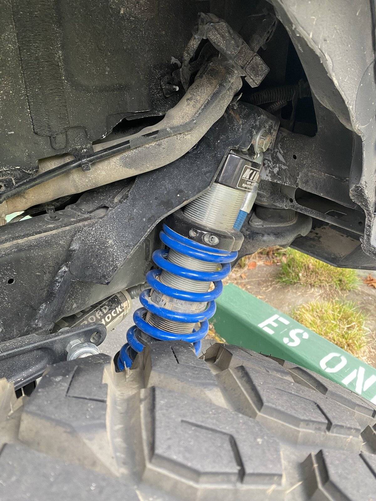

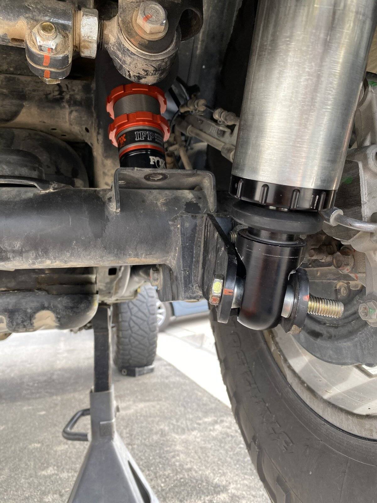

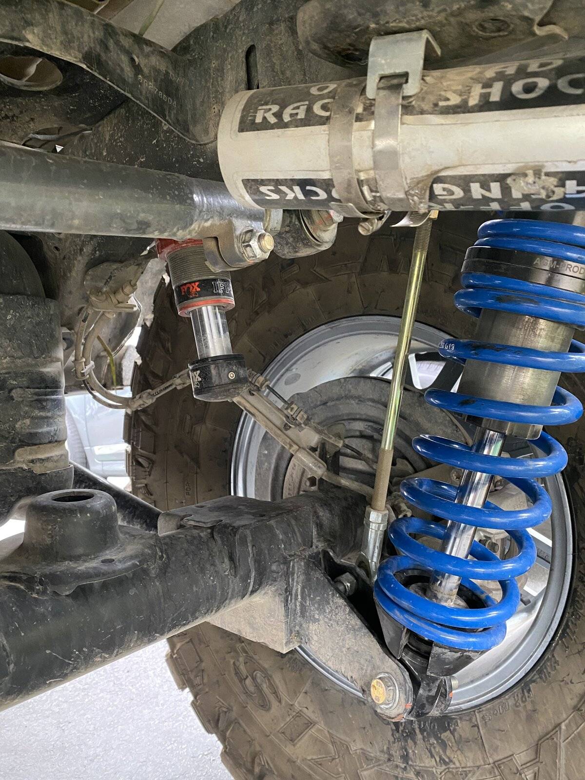

Yessir, remove it and adjust bump down accordingly ?? I have the foxs in the rear but no bump pd on the axle
Highly doubt that Jeep rear coilover setup in the photo is complete. Even if you removed the bump stop spacer and then unthread the air bump to be lower... you would still have the same amount of up travel (if done correctly).
edit: found a more recent photo with bump spacers:
That is true, i was thinking more a long the lines of the bump is as high as it can go in the housing and the pad is taking up unneeded space

How much shaft do you have showing front and rear?

5.5 front 6-1/4 rear. But my rear towers and axle brackets are different, i was able to move everything up higher and not gain height

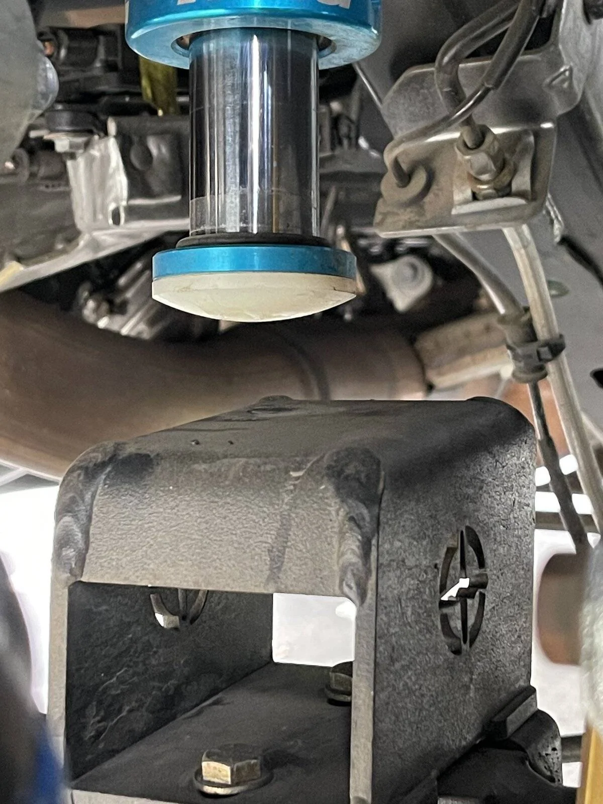

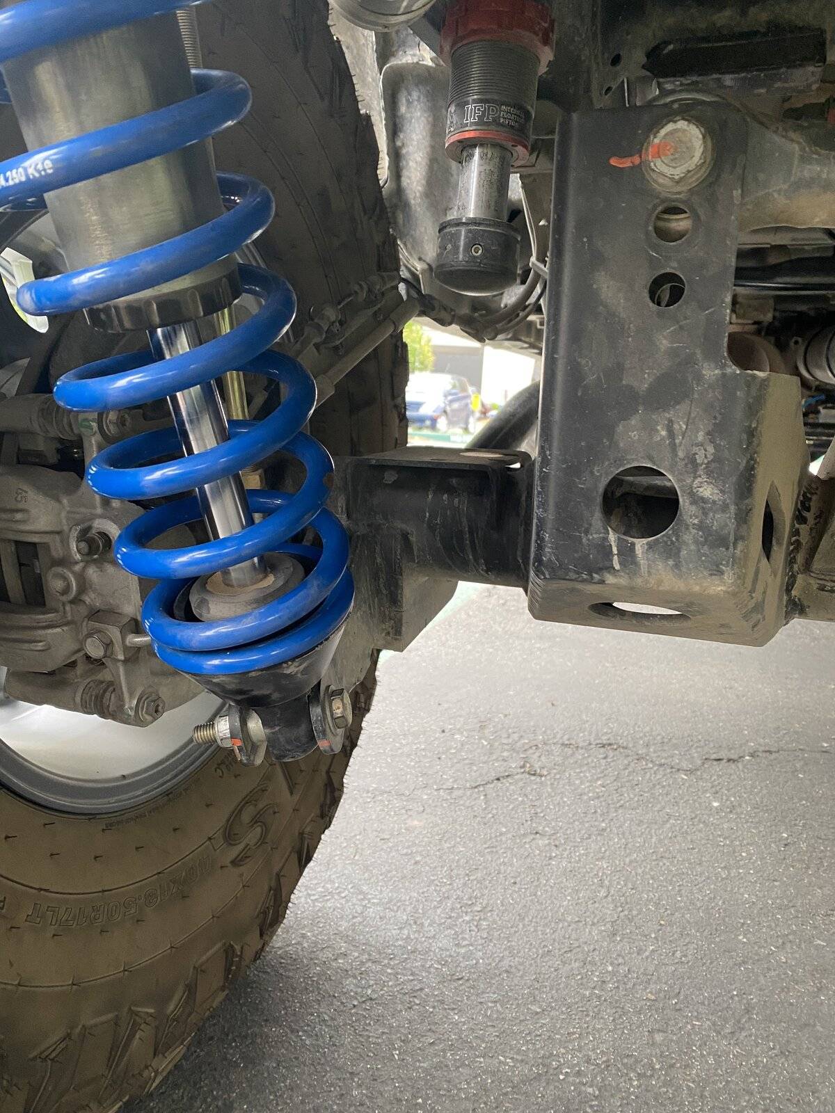

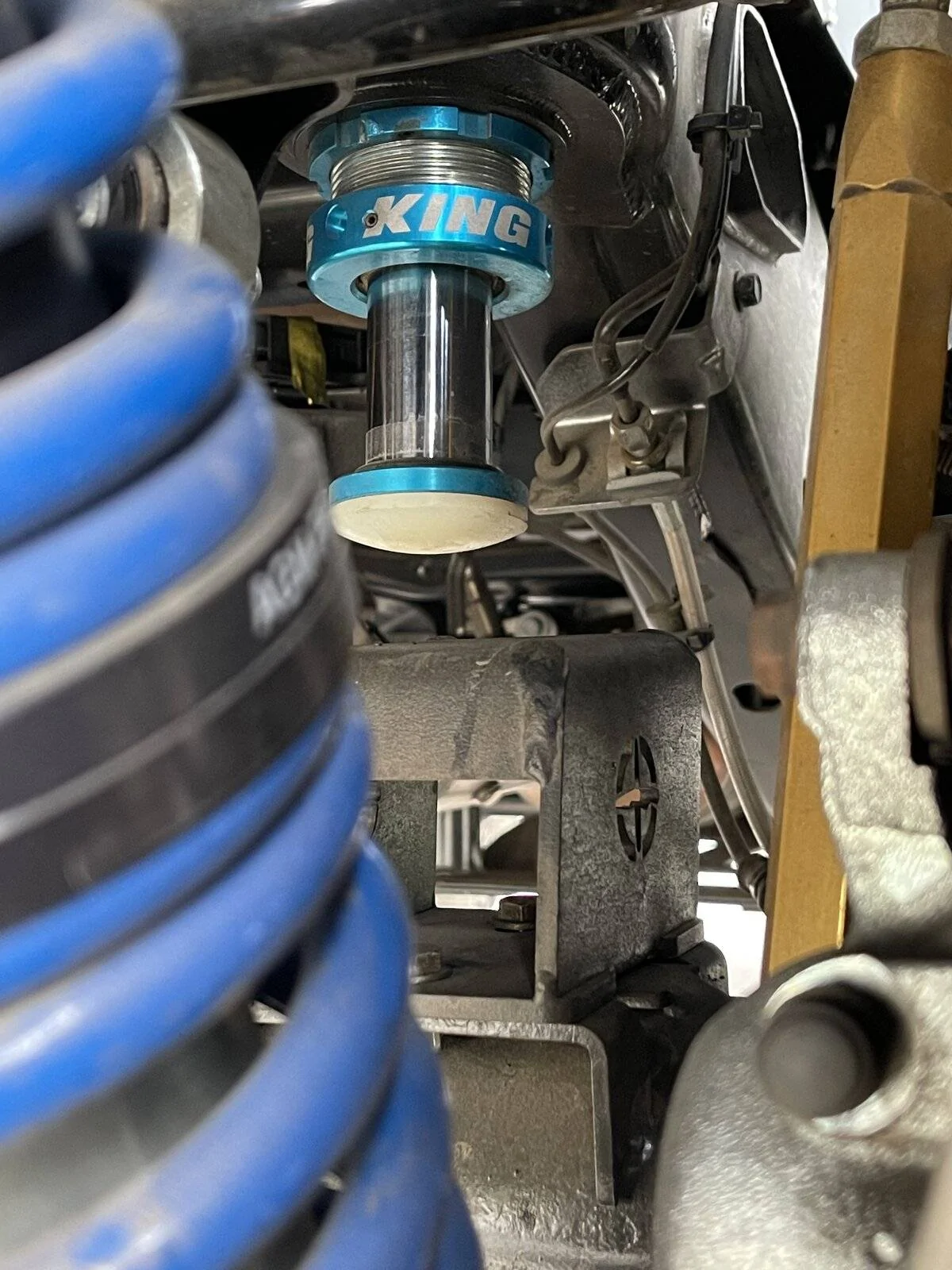

Here’s a couple more pics of my rear bumps. It looks like the King springs have sagged even more now after last weekend’s light wheeling I did ?
Jeep Wrangler JL EVO High Clearance Long Arm Kit Issues A0A7C708-A93F-49B3-980B-012F1AC89337
Jeep Wrangler JL EVO High Clearance Long Arm Kit Issues 770F66EE-1AE0-49F9-AAF5-089508A2355B
Jeep Wrangler JL EVO High Clearance Long Arm Kit Issues A34856C3-B5D7-4CFC-9E41-528988CF31A7
Now I’m only about an inch or so away from the strike pad. On the plus side I can see in these pics it will be easy to remove. But maybe I won’t need to take it off once I get the new springs from AccuTune.
That should lift me up some more and then I’ll have about 5.5” shaft showing in front and 5.25” in back, and the rig should be sitting perfectly level.
That should lift me up some more and then I’ll have about 5.5” shaft in front and 5.25” in back
What new rear brackets are you running?

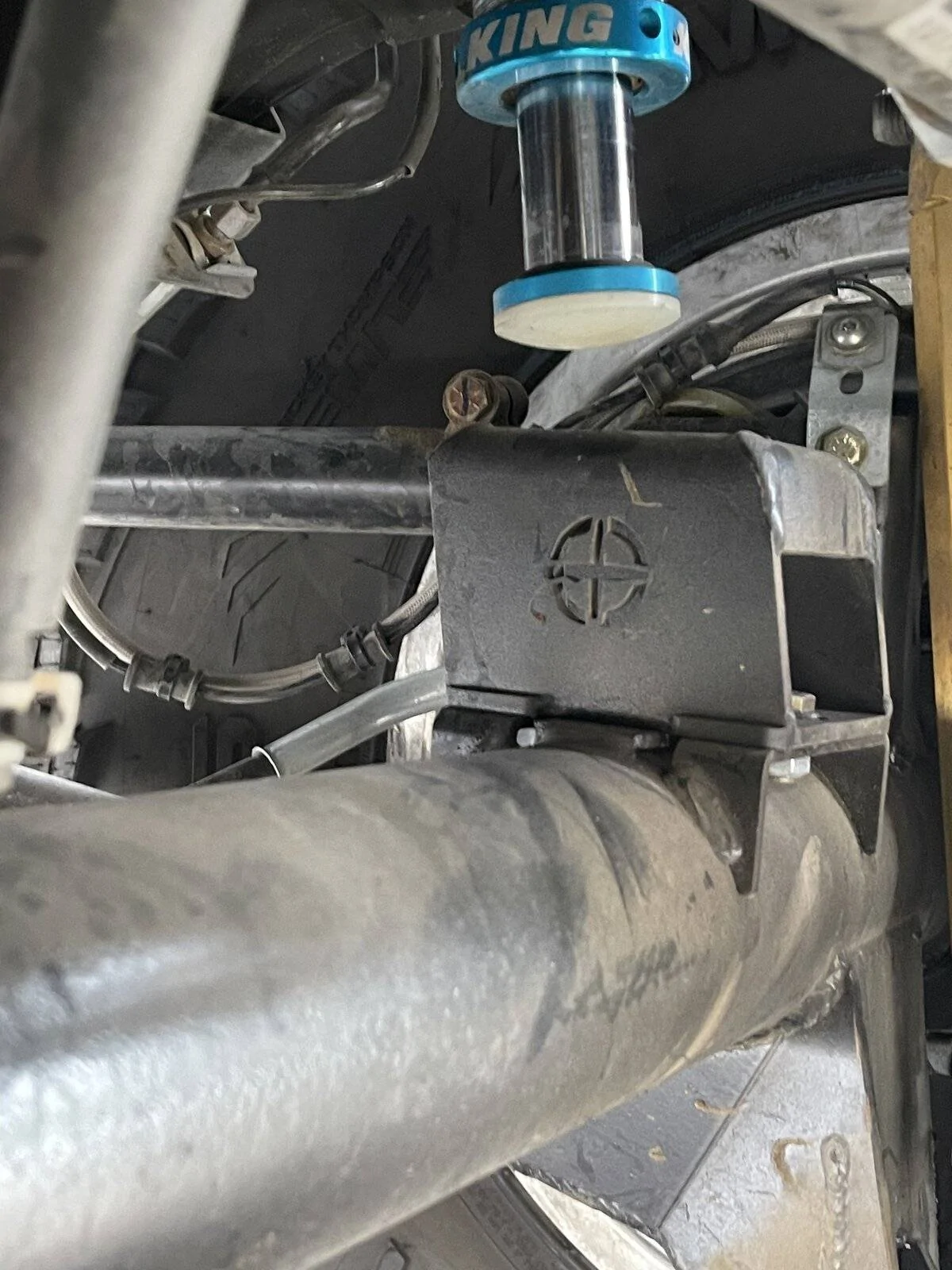

Yeah youre gonna have to cycle the shocks with the springs off and see where they bottom out at, im gonna guess you can move them up a bit or remove the plate.
i have the rklong arm brackets and the rear shock tower is 3-1/2” taller because the shock mounts on the axle got moved up.
From those pics it looks like your shock is going to bottom out before your bump stop does in the rear that's not good.

The Evo kit uses a king shock that is actually a 14-in travel shock. My rig is actually higher than I want but everything's custom on mine because I have aftermarket axles and I did not use any of the brackets that were on there I do a lot of snow Wheeling so it's good to be a little bit higher. That being said in the front I have almost 17 inches of wheel travel.
No sir, i take all my springs off and adjust my bumps, it has about 1/4” left of shock travel left

I get a full 6.5” of up travel in the rear
