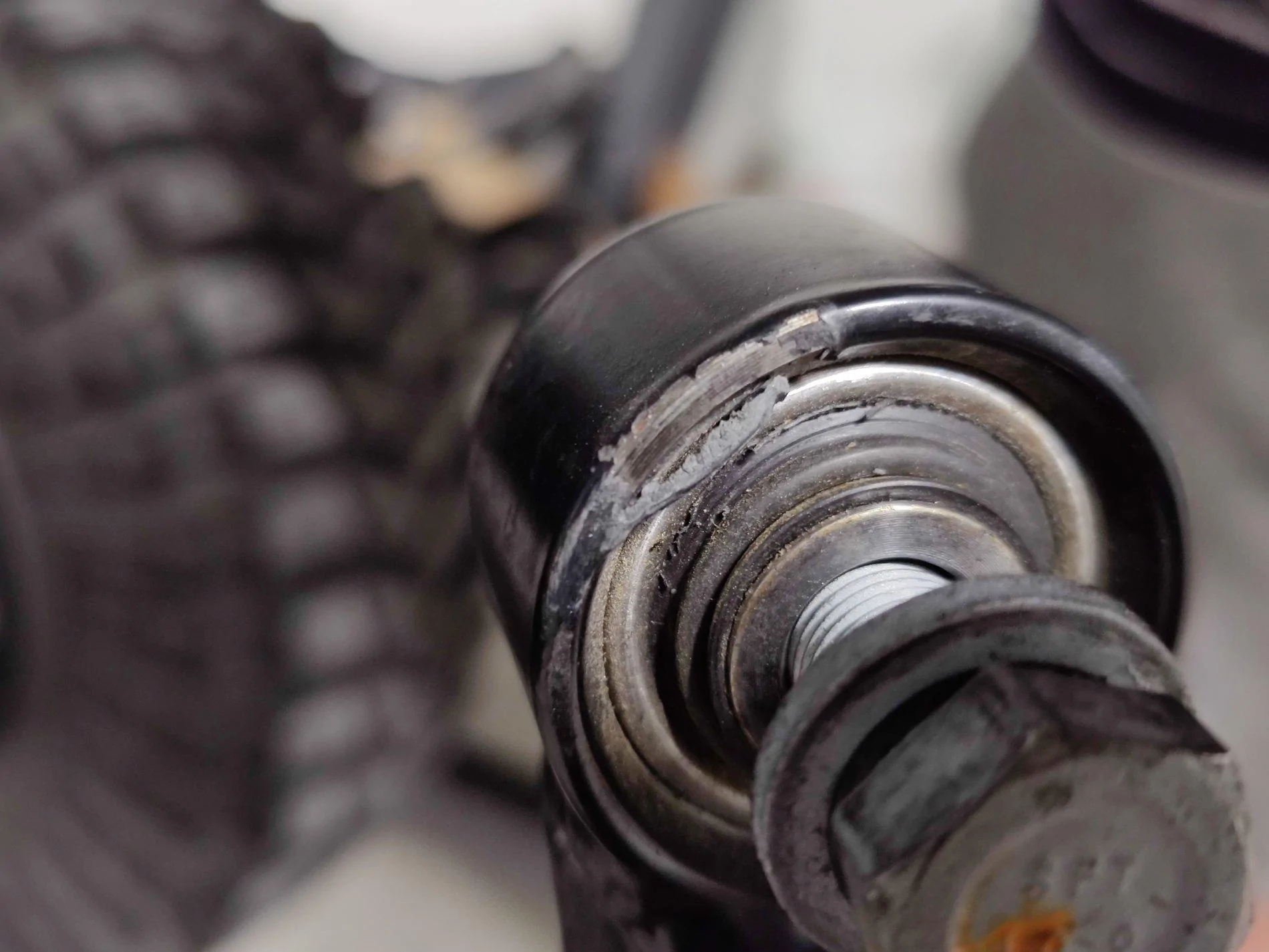

Just took it apart and yeah its shot. The RK Trackbar didnt arrive like it was suppose to today but all good as long as its here by friday. I am gonna change the bushing out for something else and test that. Seems to be hitting under flex as well .

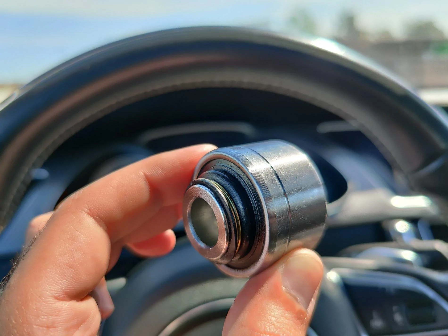

RK trackbar from Northridge went MIA lol what a cursed jeep.
Had my buddy call Evo and they gave him a replacement bushing under warranty to try to put on. So that was kind of a plus, and now we can really see if it was faulty or not.
Jeep Wrangler JL EVO High Clearance Long Arm Kit Issues IMG_20200507_152831
*EDIT*:
Drove about the same, only difference was on freeway now less mini violent rumbles especially with a bend in the road.

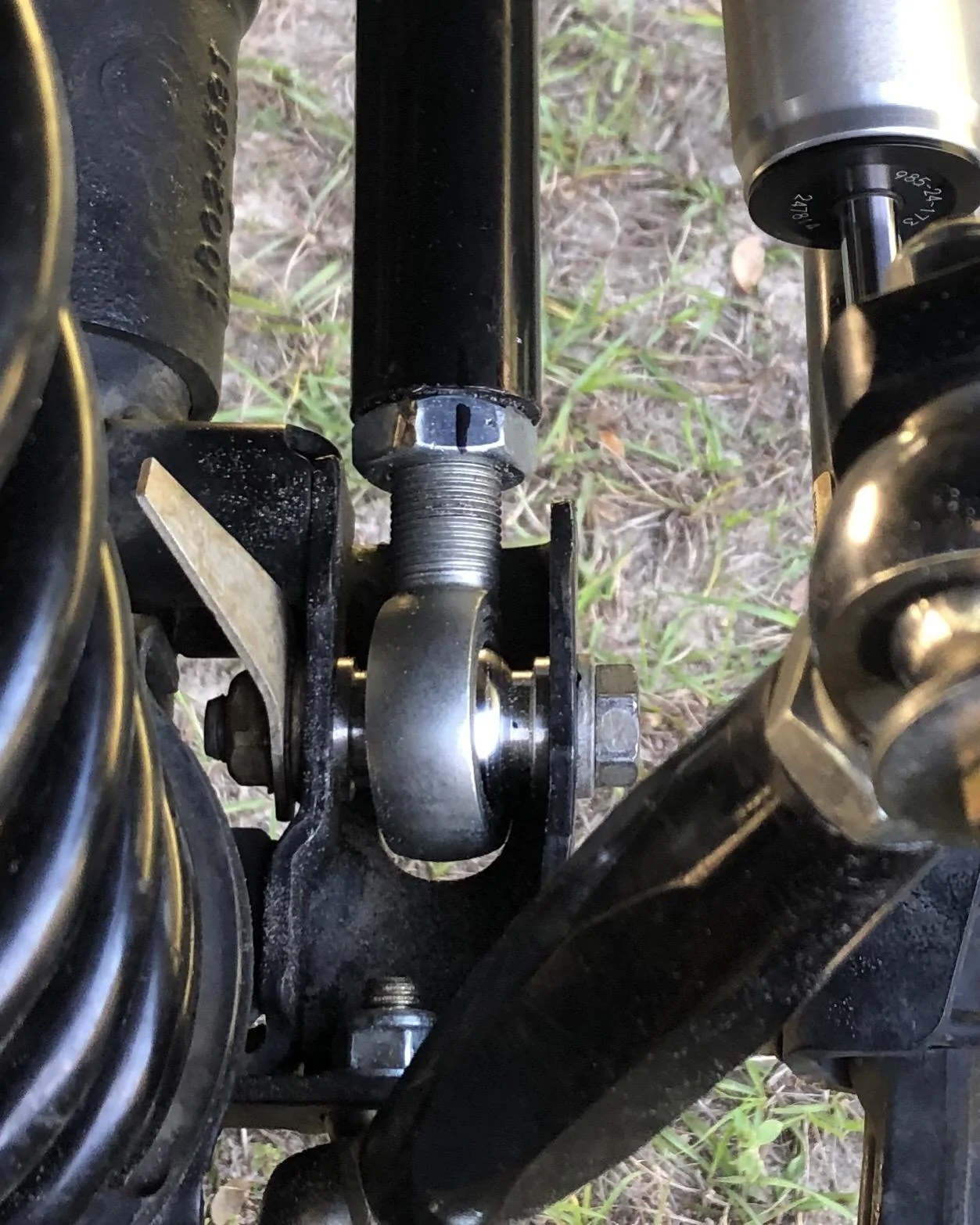

Been reading through this thread I have the same kit on my rig with the long arm from Evo. I actually had extra hard wear in my packs and this is not the first time I've used their coilover kit I had one on my JK as well. Didn't really have any issues with the lift install until I put UD 60s on my Jeep then everything turned out to be custom. Ud60s make it very difficult to put coilovers on because of the size of the brakes it can be done but it's tight but because the price I got on duty 60s it was worth it.
My observations on track bars I've been through two RKs and a Teraflex. I'm currently running the RockJock trackbar for the JL and have no issues whatsoever. In fact it's lasted the longest time that is any of them have ever lasted including the ones on my JK.
