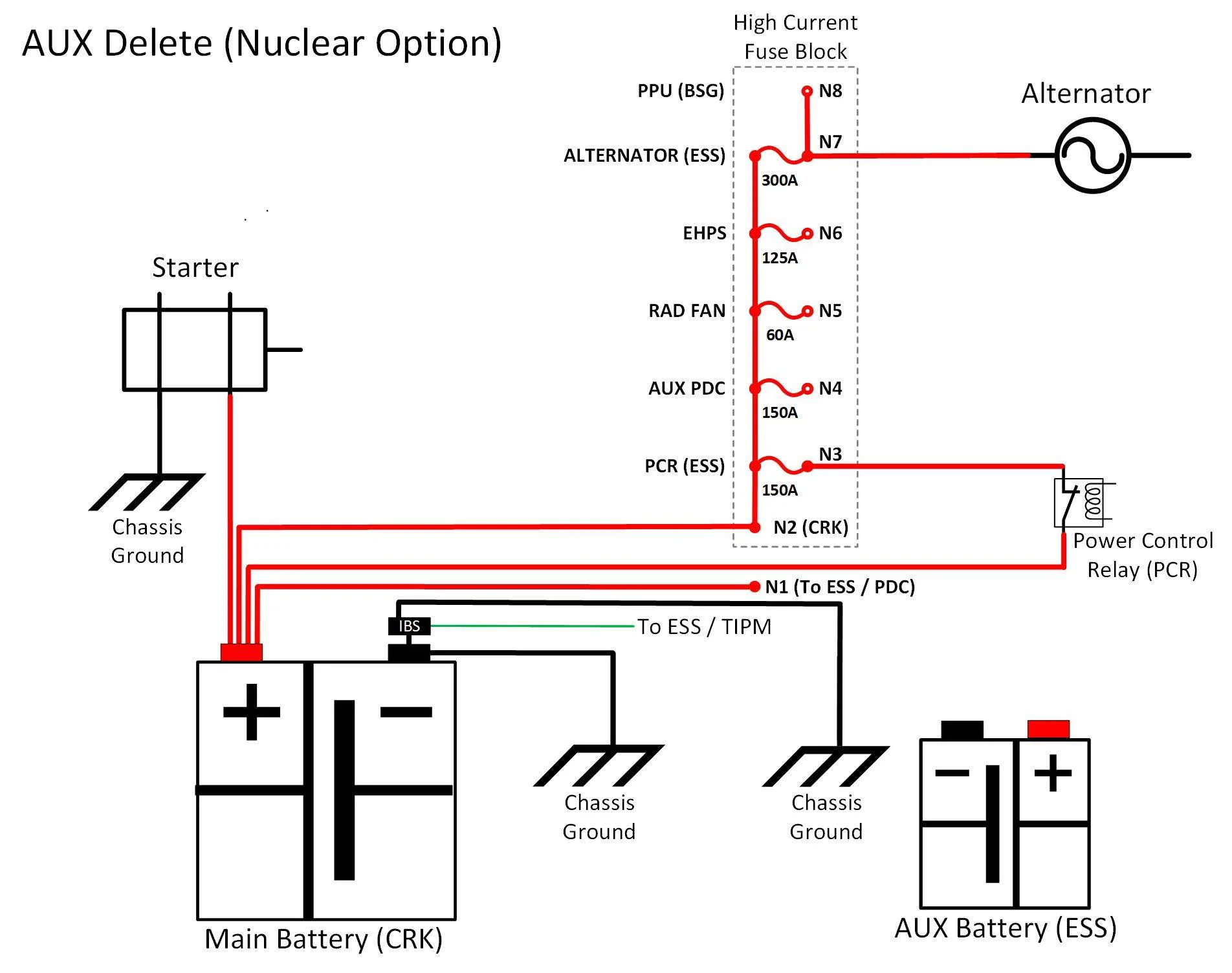

I finally bit the bullet and deleted the AUX battery in my Sahara.
I realized that feeling "Relieved" it always died in the garage was not a way to live life.
The dealership was anything but helpful. Their approach was "we can just throw parts at it as long as you give us money and we will just send you on your way.", problem solved or not.
It is stuff like this that forces paying customers underground. I do not want to just replace parts until something works. More so when they want $900 for a TIPM and if the problem is still there, you have to purchase another one. No thanks.

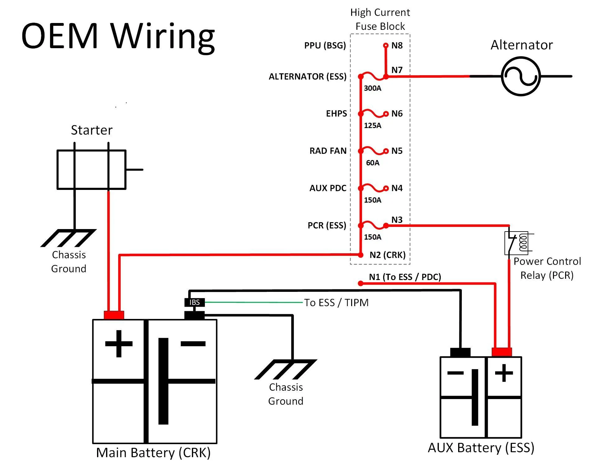

I have tons of pics, but the down and dirty is fairly simple. The actual process involves some unwrapping, cutting, soldering, heatshrinking and rewrapping of the wires.
You can see the OEM design, and the Nuclear Option, where I just rewired the AUX leads to the CRK battery posts, using the extra lugs for winches, etc.
I can write it up, but it was a bit of a process! Not for the faint of heart, you will be cutting and soldering some large wires along the way!
FYI - The Start/Stop (ESS) system still functions exactly the same with AUX delete. With or without the Tazer in, the Jeep does not know the difference and it functions as intended.
Mark:
I'm curious if:
* You've overcomplicated how to do this bypass
* Failed to approach it a simpler and arguably better way, and
* Failed to appreciate the fact that "the Start/Stop (ESS) system still function[ing] exactly the same with AUX delete" is NOT a feature, but a bad thing.
I admit to not knowing the answer to any of these 3 issues but will offer some thoughts, not in judgement, but for educational purposes.
Your 2019 should be designed from the factory to IMHO, allow a much simpler process of taking the ESS/Aux battery out of the electrical schematic of the vehicle than that I think you've described, that can also involve its physical removal if you wish.
Two black cables from the factory connect to the negative terminal of the main battery. One such cable's other end is the body ground on the passenger's front quarter panel. Please leave that cable attached and untouched.
The other cable's distal end, as I think you know from your schematic, attaches to the negative terminal of the ESS/Aux battery. Simply remove that from the negative terminal of the main battery and tape up its free end.
Crank your 3.6L. Expect that crank to fail. Do it again. The second time your 3.6L should attempt a crank solely off the main battery. If successful, the vehicle will from this point on crank on the first try, solely from the main battery, running solely on it as well. It will remain this way until the next cold crank, if any, in which an energized ESS/Aux battery is reintroduced.
Additionally, your 3.6L should put an "ESS off" message in the dash. This is a good thing IMHO. Which segues me into my 3rd point. The fact that the ESS system continues to run (because your approach has tricked the 3.6L to reroute calls to the ESS/Aux battery into the main battery) is not a feature, it's IMHO a potential safety concern.
We don't want to run ESS events on a 3.6L with one battery. Those events could rob the main battery of cranking power while it energizes appliances during an ESS event with the engine off.
Normally such responsibility for keeping appliances on in ESS events is on the ESS/Aux battery only, sparring the main battery to effect the bulk of the cranking load. Main battery only ESS events risk not being able to crank once a foot is lifted from the brake.
I have no issue with approaches like yours that reroute calls from the ESS/Aux to the main. They take various forms, with or without the ESS/Aux battery still wired in, involving fused jumpering of N1 to N2, and/or pulling Fuse 42, but they should be done IMHO in concert with turning ESS off, either by button push at the time of cold crank, or the purchase of after market tech to effect same.
Some people think the ESS off light of simply pulling the cable I describe annoying. I call it a feature as the vehicle has turned ESS off for you when running one battery: no button push or tech required.
This technique is not for early model 2018s without TSB 18-092-19. These JLs won't crank if an energized ESS battery is not detected.
Yes, many vehicles run ESS on one battery. But the 3.6L wasn't designed for that.
To the extent that you know this stuff please appreciate that I have no desire to show you up. I just don't want people stranded when making left turns, with ESS engaged on one battery, and getting stuck in the left hand turn lane.
