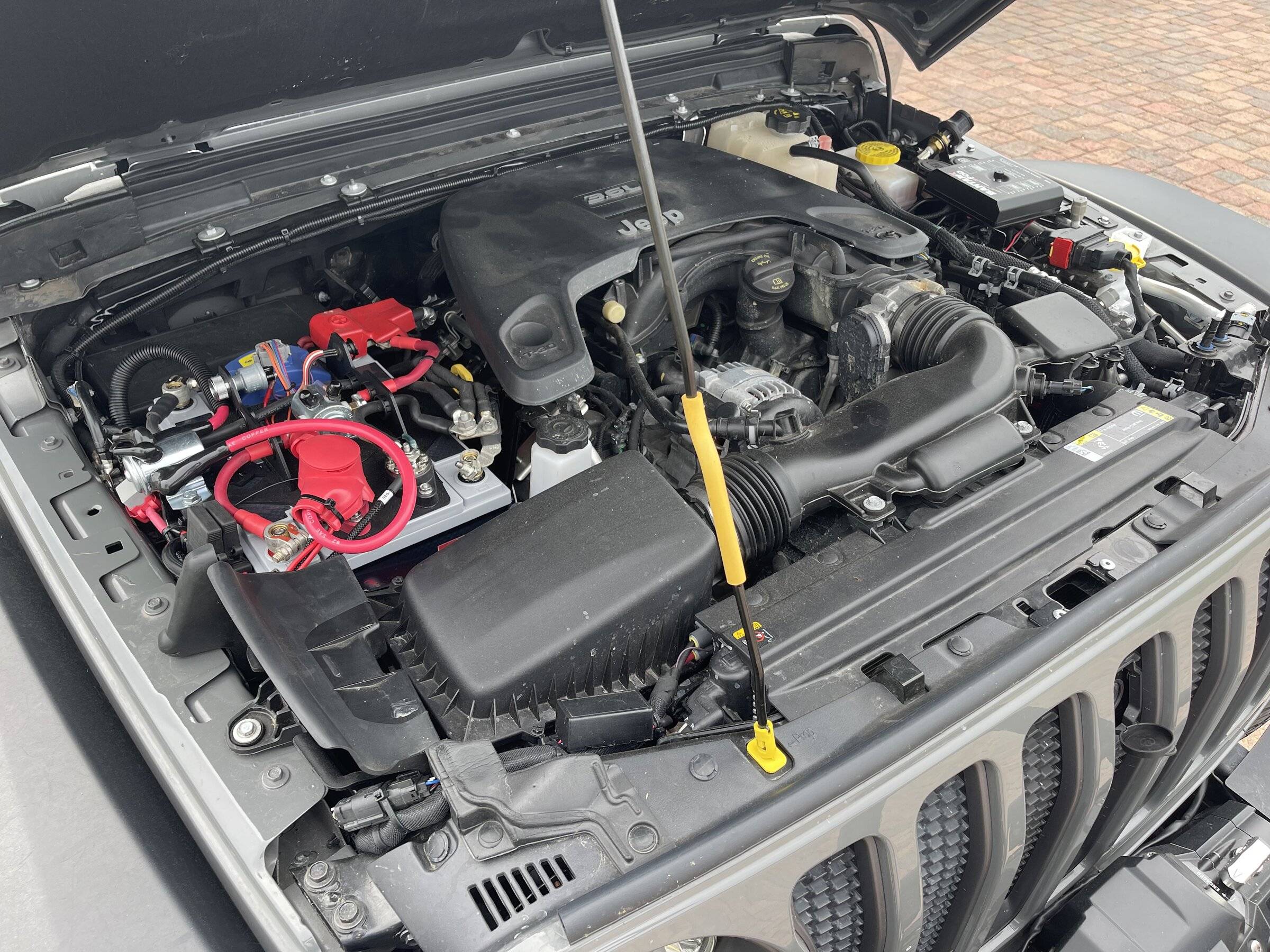

My batteries died last Tuesday. I was going to just replace both with (hopefully) better quality batteries, but the Aux14 battery is unavailable in my area, so I eliminated the Aux battery out of necessity.
I pulled the passenger front fender, removed the Aux battery, ran the positive cable up from the Aux battery position, and hooked that positive cable up to the new H7 AGM main battery. Removed the Aux ground from the main battery negative terminal and taped it off.
Have run this set up now for 6 days and about 200 miles without issue. Charging voltage has dropped from a constant 14.1+volts down to 12.7-13.0volts. I don't see a reason not to do the Aux delete, but I am not an electrical engineer.
People will tell you to just run the jumper. This just seemed to be a cleaner alternative. Think of it as a permanent jumper. Note - I run a Tazer to keep ESS turned off at all times (among other things).

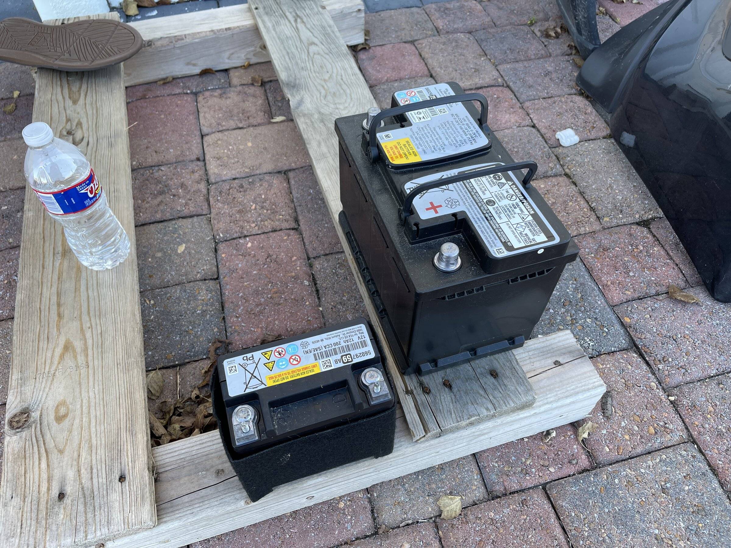

Did this mod today to get rid of the aux battery. I just left the negative terminal unhooked and taped is up and left in the aux tray. The positive power connector I worked out of the wire loom and routed it back to the main battery terminal. I did have to cut one wing off the connection from the aux battery positive and enlarge the opening for the stud on the battery post.
I also upgraded to a larger battery than the OEM one.
