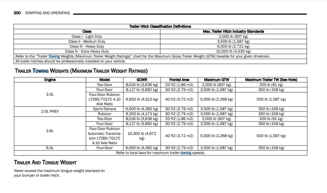

There are a couple of JLU engine/trim/tire/gear packages that have a higher tow rating and tongue weight if you get a 2024 My.
