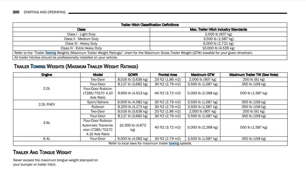

The 2024 manual I have has this chart in it:
Jeep Wrangler JL 5,000 lbs towing capacity 1000007882

I had asked in a another thread about this since, in the 2024 manual as shown above and I just got a 2024 "standard" Rubicon and shows 5k but look above that at the hitch. Need the class III and on my delivery build sheet break out it was equipped with a Class II hitch so limited to 3500.
Can it do 5K? Evidently so now, but is it equipped from the factory to do it? No and you very likely will not get answers from the dealers about it. Mine just said, yeah it can do it but was...huh? when I mentioned what the owners manual showed about the hitch and couldn't get any other answers. Another guy said he asked a dealer and was told they couldn't offer any answers due to liability issues.

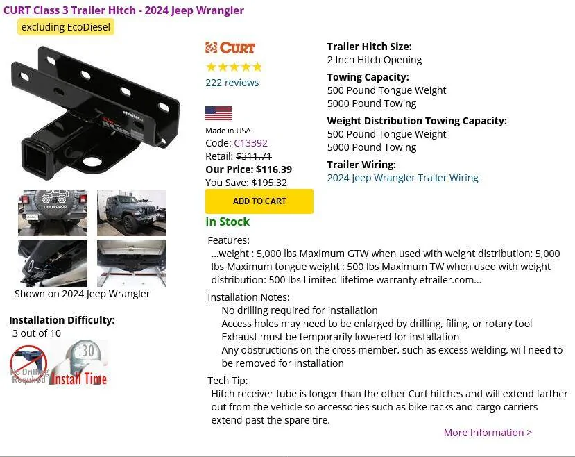

Typically, the guy walking in off the street knows more about these than any salesman at the dealer. There are 2 hitches on etrailer listed as 5000 lb capacity. Also note they fit 2020-2024 with no disclaimer about manufacturer rating. Overseas, the Wrangler has towed 5500 lbs since 2019.
https://www.boatsales.com.au/editorial/details/2019-jeep-wrangler-tow-test-121566/
Jeep Wrangler JL 5,000 lbs towing capacity 1719702066919-iq
