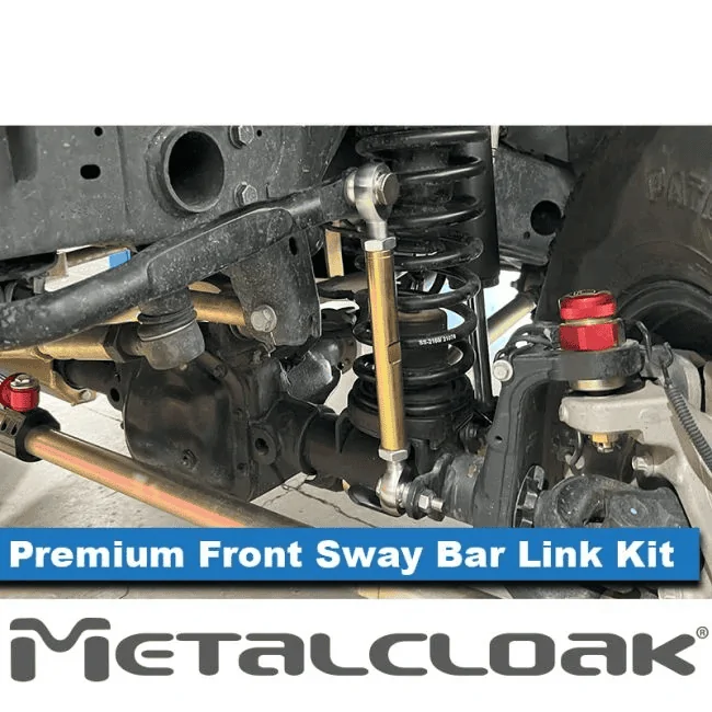

I run Metalcloak and love there stuff but felt the original links they provided were binding with all the flex the suspension system provides.
Definitely appreciate the sentiment. We now have HD Premier Sway Bar Links as options on our kits... as well as available on the site separately... here is a link to the JL/JT Kit.
Jeep Wrangler JL Do upgraded sway bar end links actually make a difference? 1715271051788-ff
Premium Disconnects will be hitting the website soon.
