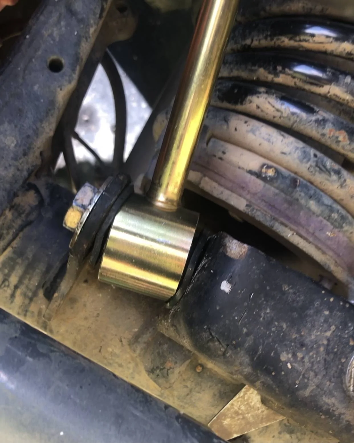

I recently have started working on my own lift setup and I am seeing the fixed length Metalcloak sway bar end links bind, see image below. This is why I believe people say they limit flex, and this could be solved by the RK no limits heims, but I think the manual disconnect is another solution for 1/3 the price?

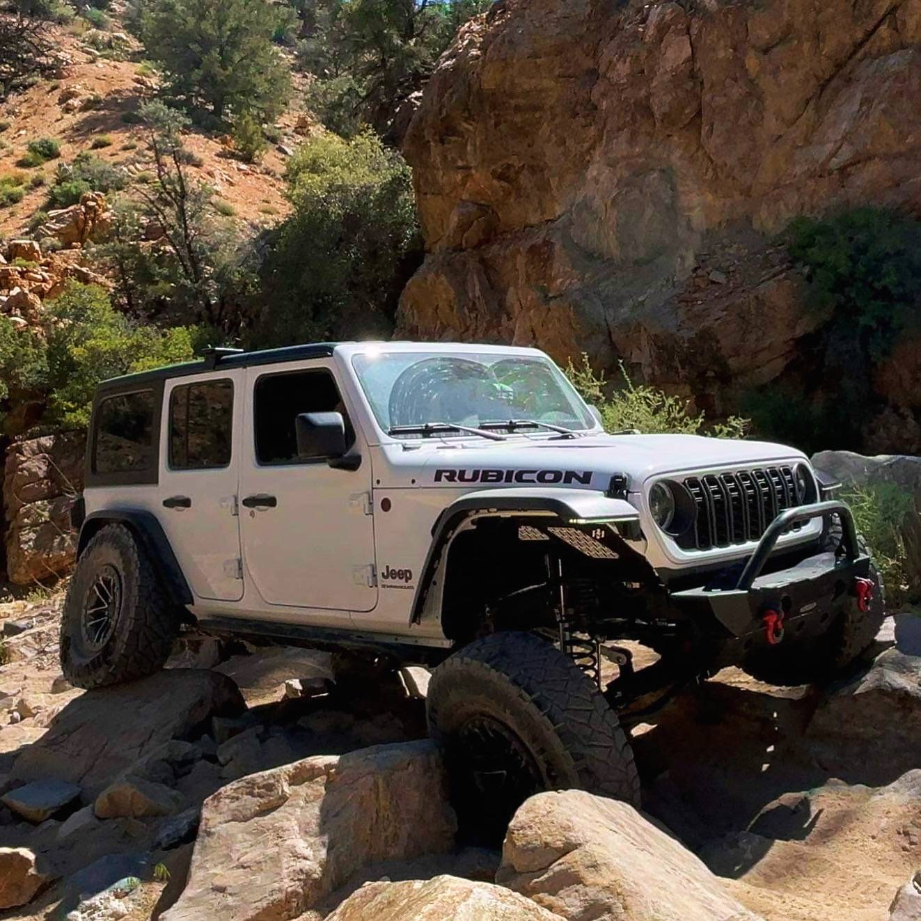

I don't know that the stock swaybar and disconnect limit articulation, but the pic in my avatar is with 3.5" metalcloak lift, stock swaybar and disconnect. My articulation seems to really only be limited by my fenders and shock travel.

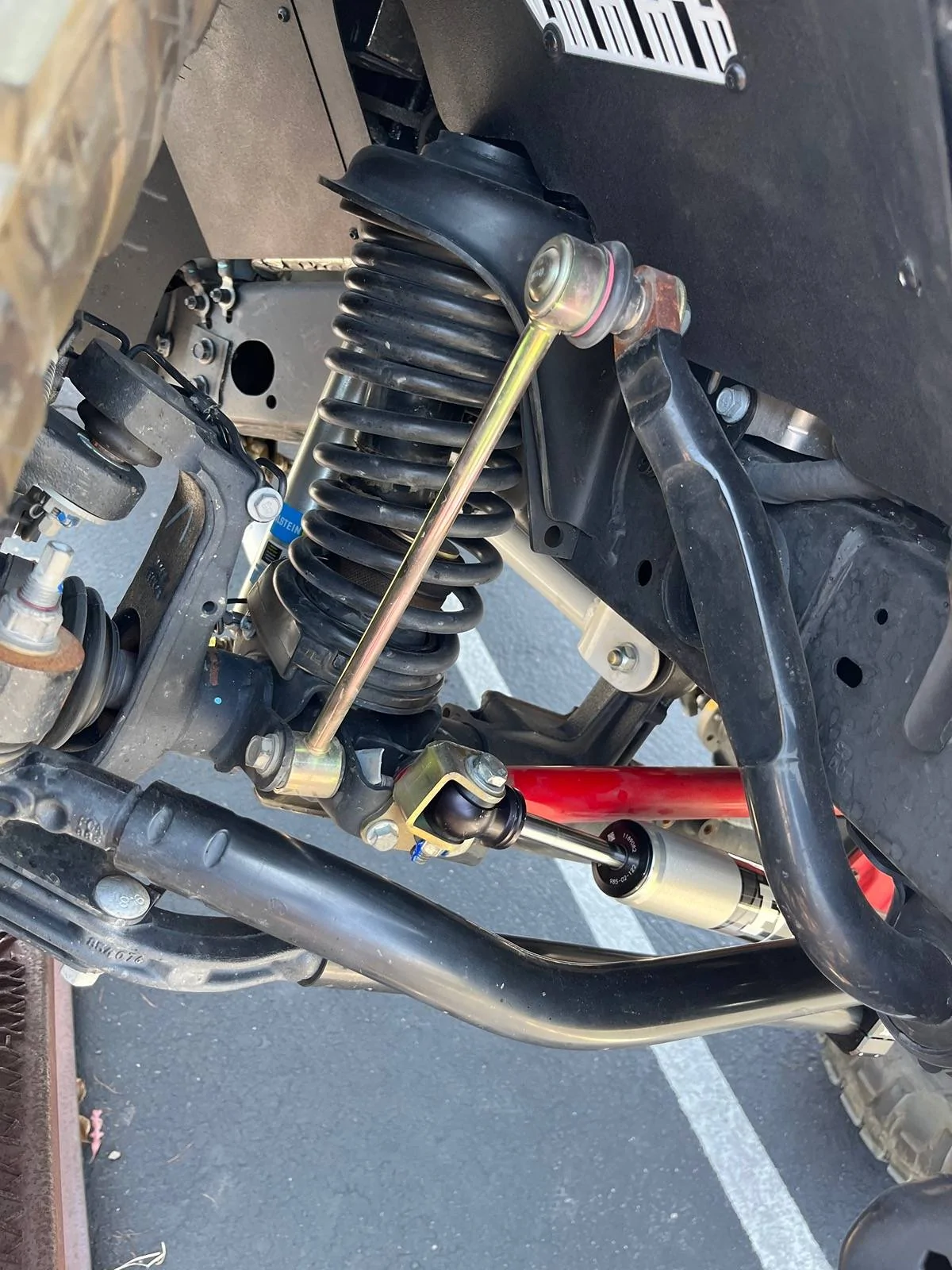

That’s not bad at all. This is mine in the wild. I’m wondering if all of these suggestions I am getting have no real merit but I was curious.

There is no difference between using the Rubi disconnect and unhooking the end links as long as you’re using the right end links….

MC links are long enough that they work, but it does pinch the bushing at full stuff…but they just came out with their own version of a dbl heim design……

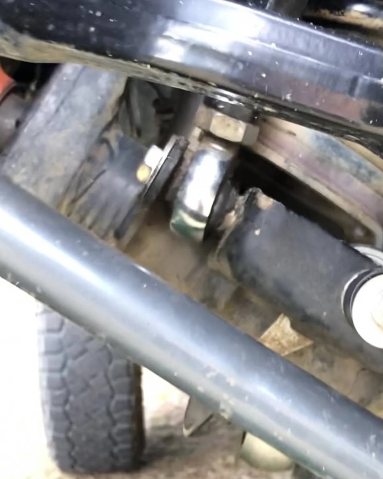

A lot of times people just repeat what they read, or here, without actually looking into something they read or heard……. That’s where a lot of bad and/or misinformation comes from on the web……anyway…. Here a couple pics showing the oem style which the original MCs are like and the dbl heim links……

That end link looks a little long to me but I guess this is fully articulated. Where does the sway bar sit on flat ground? It should be parallel to the ground to slightly raised. What does fully extended look like? You don't want it to invert.
Yeah slightly raised about 10ish degrees. The picture is full bump

I get a click noise when I disconnect my e disco and I get the same noise when I am fully flexed out, so I was wondering if it could be the end link touching the bracket as shown, and the metal on metal makes the clicking, or the mechanism is being over stressed due to the bind? That’s really what lead to ask the end link question. The noise is not harsh at all.
