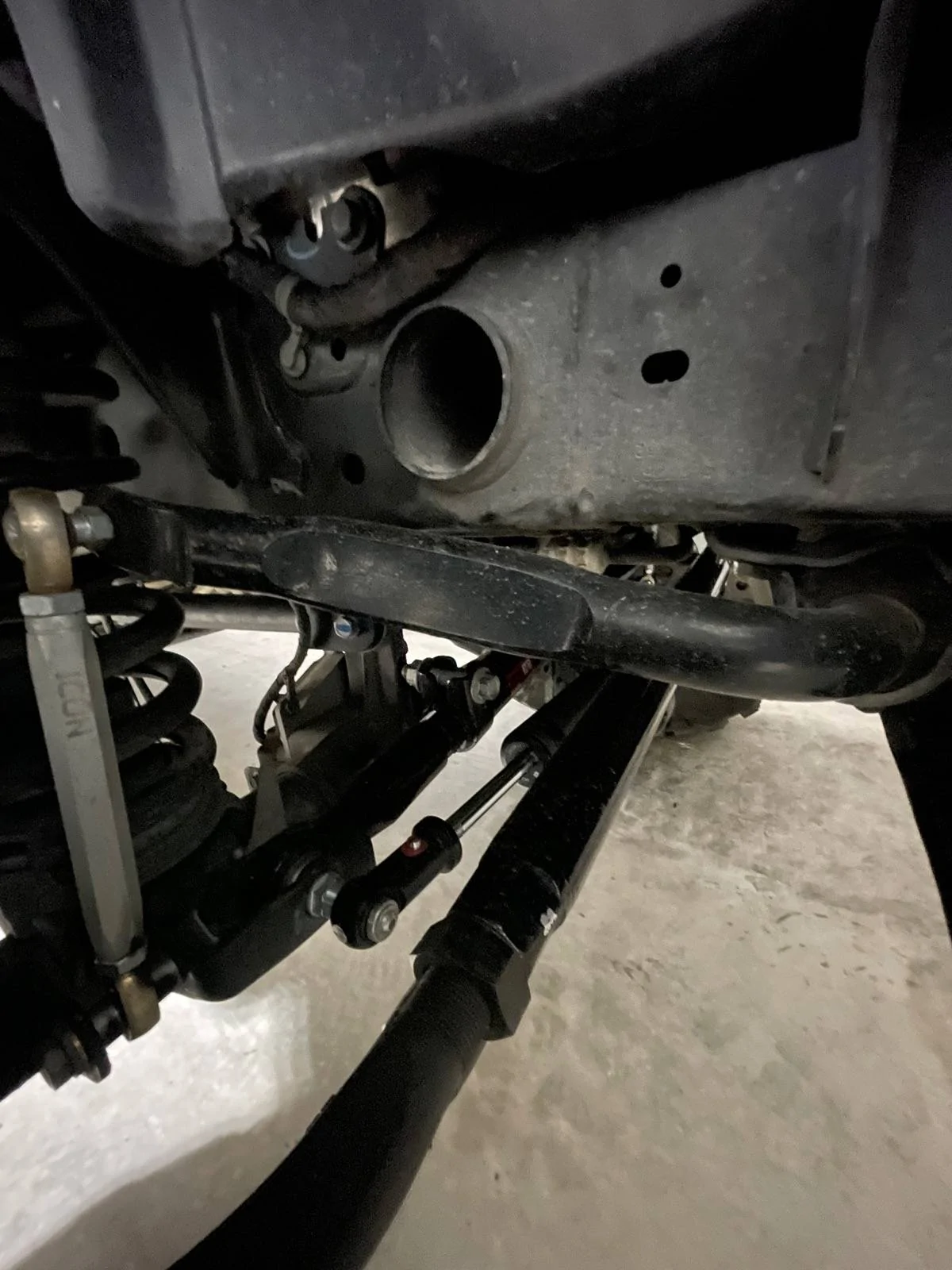

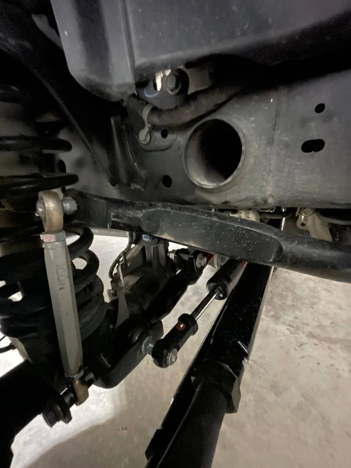

This might be a stupid question but I am wondering if the new icon sway bar links would cause the Jeep to feel like it’s floating a little more. I had issues with a shop installing metal cloak ball joints and an alignment after I did the icons.(I have another thread about this).
I had another shop redo the alignment and they said the toe was out. It seemed to drive a little better after the corrected alignment, but I still feel like it’s floating and wants to wonder on the highway. I am actually not enjoying driving my Jeep right now because of this.
So, I am trying to figure out what may be the cause.

I would have a hard time believing it affected the ride noticeably. What angle is your sway bar at, is it fairly level/slightly up or angled waaay up? Pics?
I would say slightly up.

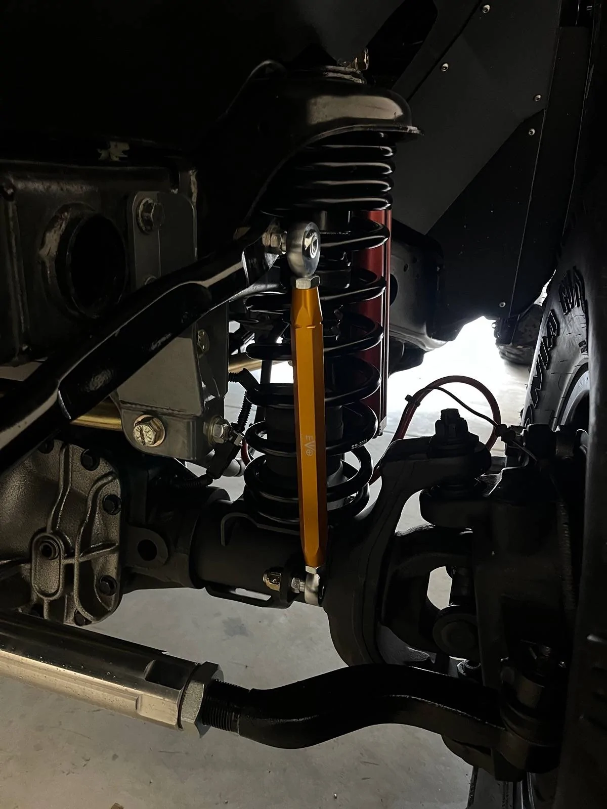

I found these Yeti links and wonder if you guys agree with the claim.
"You will notice a decrease in body roll and an overall improvement in handling and drivability when adding this kit to your Jeep"
"You will notice a decrease in body roll and an overall improvement in handling and drivability when adding this kit to your Jeep" - - - compared to what?
On a winding highway compared to no sway bar links at all? Probably. Compared to other non-adjustable sway bar links, unlikely.

The caster was the first thing I was concerned about. However, they set it to 6.4 and 6.6 if I remember correctly.
That’s the right range with a lift. The sway bar has no real give except for the amount of up and down built into the vehicle. All the heim joints do is allow more articulation under extreme flex. In a normal driving environment they should just transfer the vehicle’s body movement in a straight line with the axle. The only way to rule out the links is to put your old ones back on and take the Jeep for a drive. I just don’t see how they would change the vehicle handling that you described.
I would do this however, I had to drill the holes out to install the icons. ?
Yea I wasn’t excited about doing that but every aftermarket company uses 1/2”studs so they all need it. At least the sway bar is soft metal, took 10seconds to drill.
