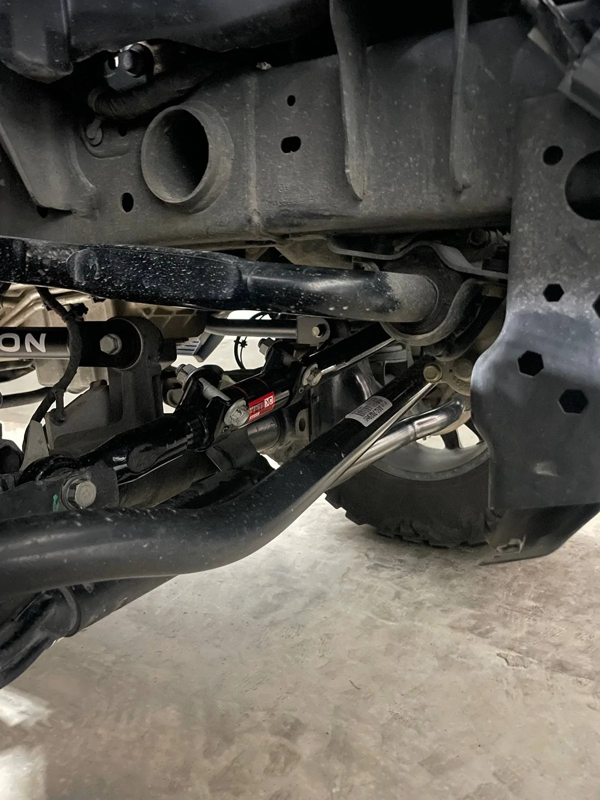

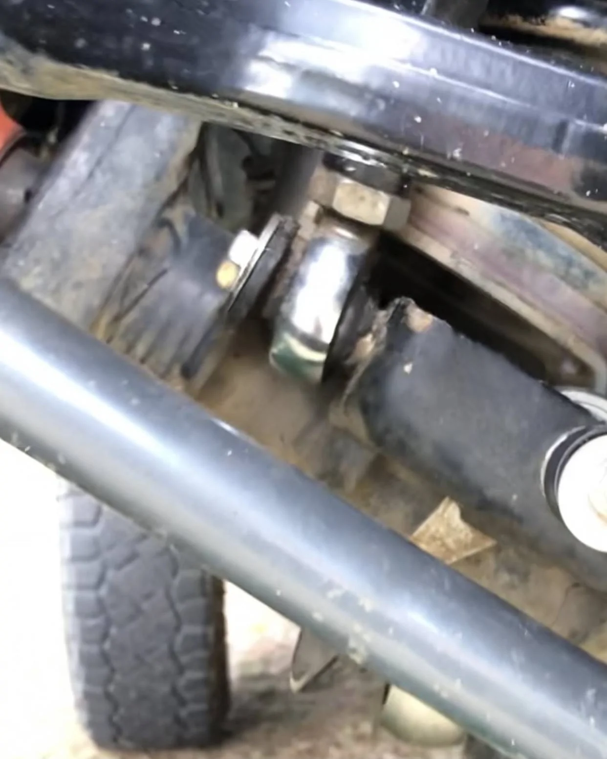

RK no limits…..it’s a dbl heim joint style link… its designed specifically for the Rubi disco..
Jeep Wrangler JL Do upgraded sway bar end links actually make a difference? IMG_9767
There’s a lot of misalignment when you’re articulating Offroad using electro disco and the links are attached….. Icon makes a cheaper version….here’s a pic of the regular style link and the no limits, you can see how much misalignment that occurs……

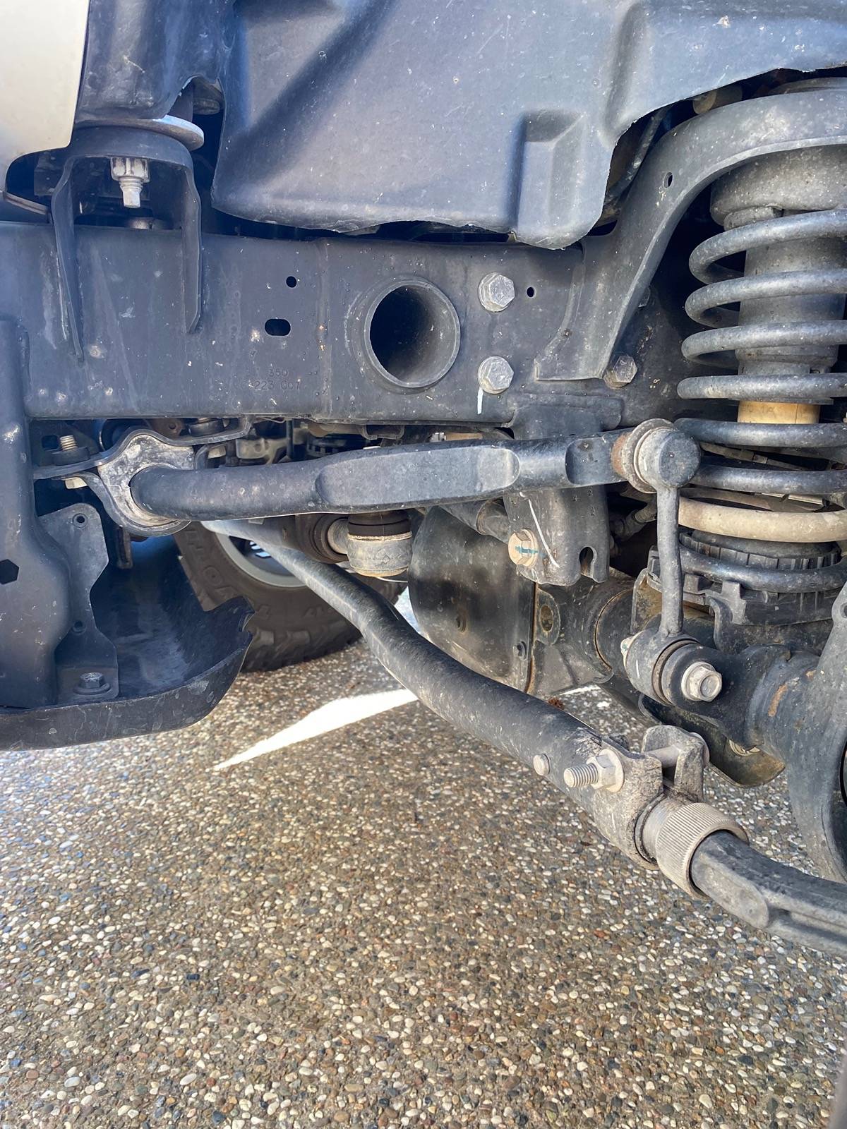

Those look a lot better. I will have to look and see if RK or Icon make some that will work with the Mopar lift.

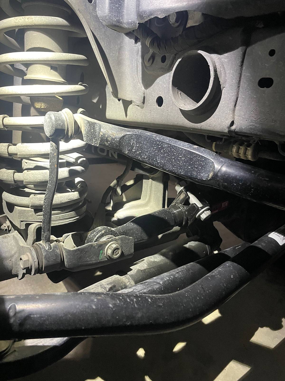

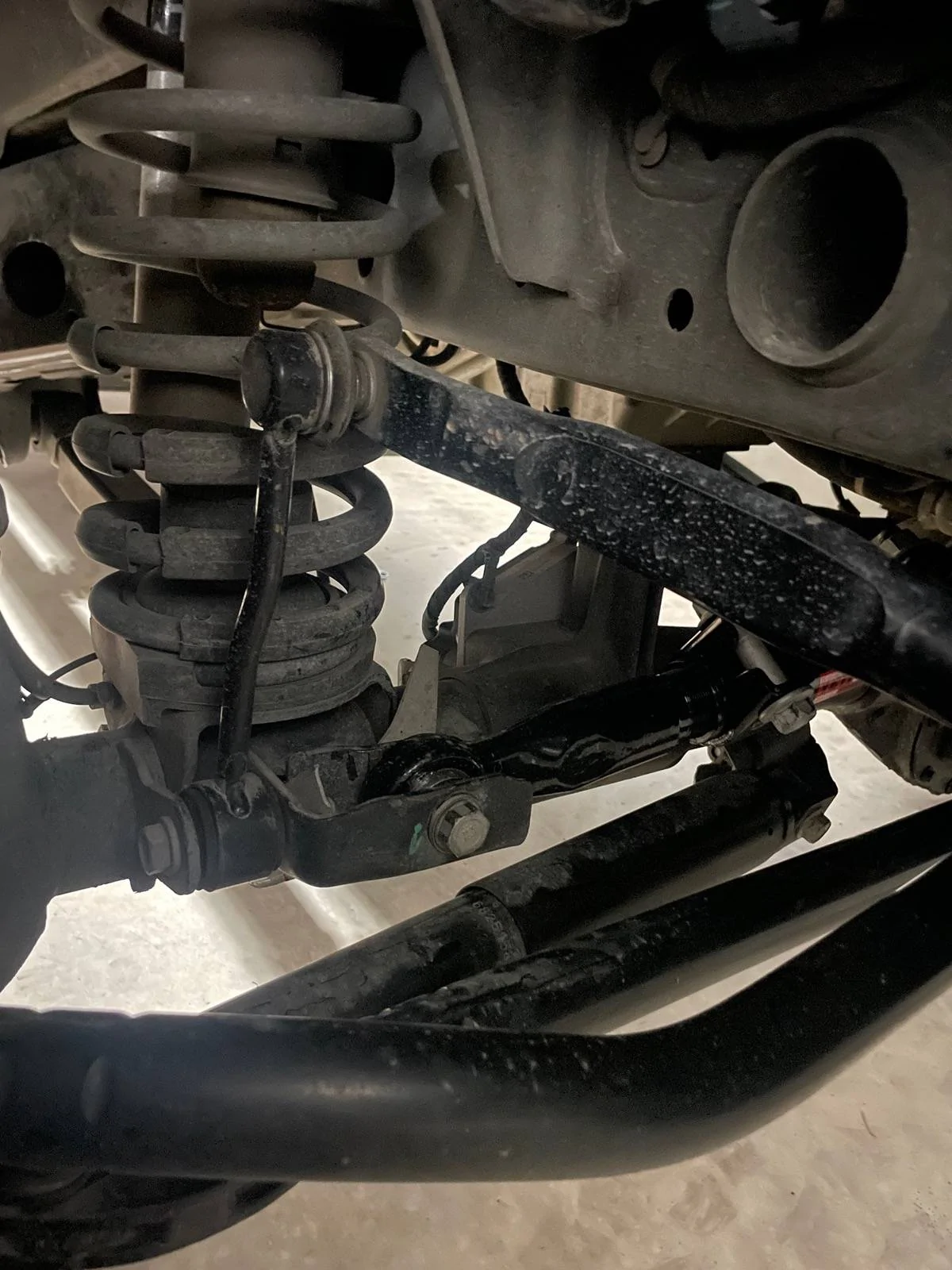

Here’s a few pics of mine right now. It seems pretty short however, the sway bar is pushed slightly upward already. I’m thinking it’s from the springs settling the last few years.

You’ll have to push the sway bar button and droop the axle to see how straight they get… the Mopar lift springs only extend 26.25” so your links may be ok, but you need to test it to be sure, you don’t want to find out on the trail…..

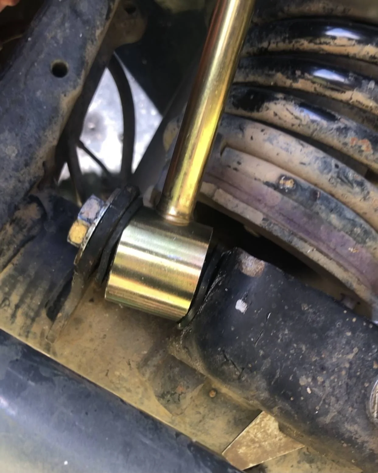

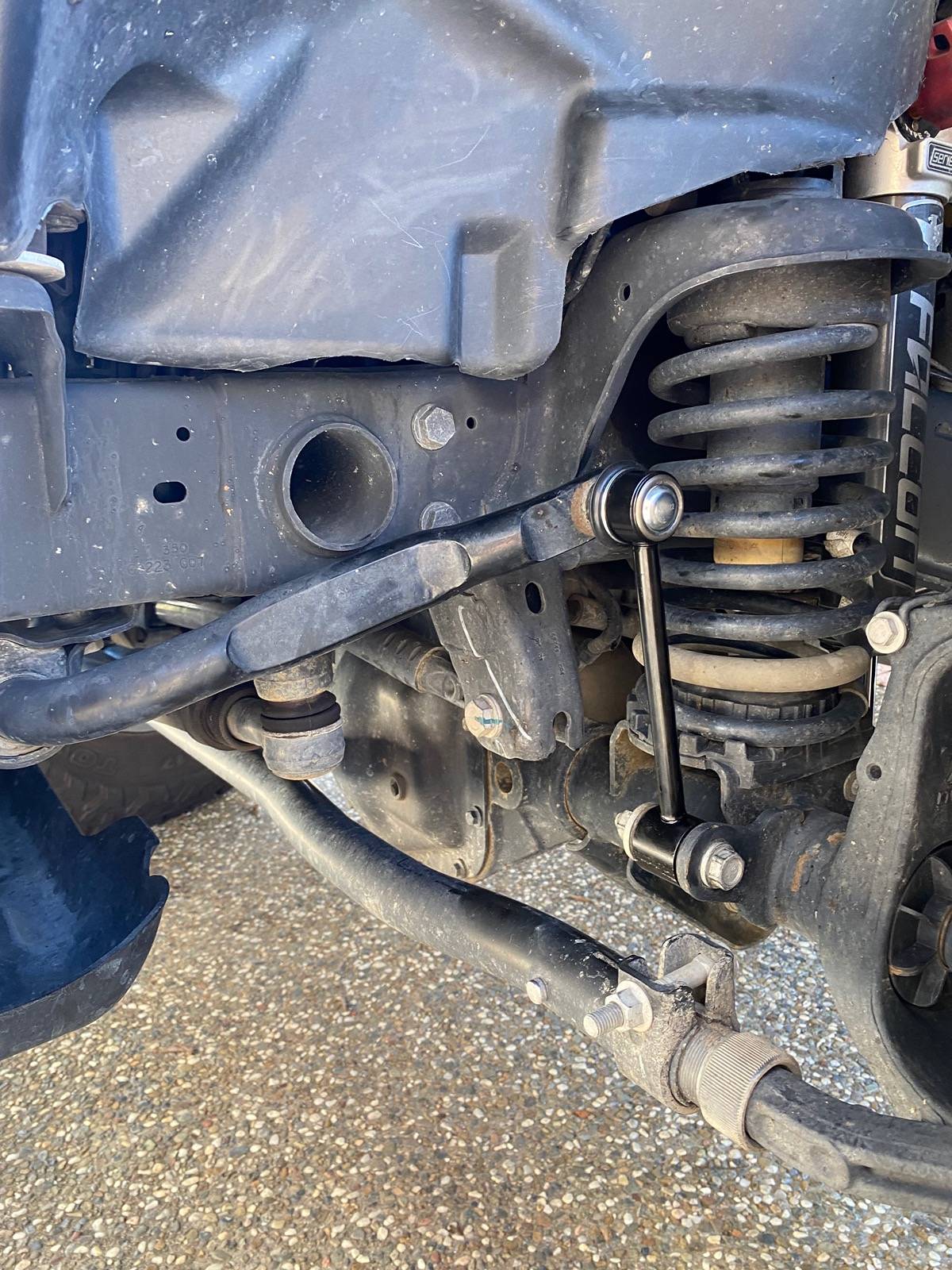

I just changed mine out from the Rubicon stock links to some AEV ones which are about 2-3” longer. After the small lift I did, I could hear them until I disconnected. I’ll be testing these soon

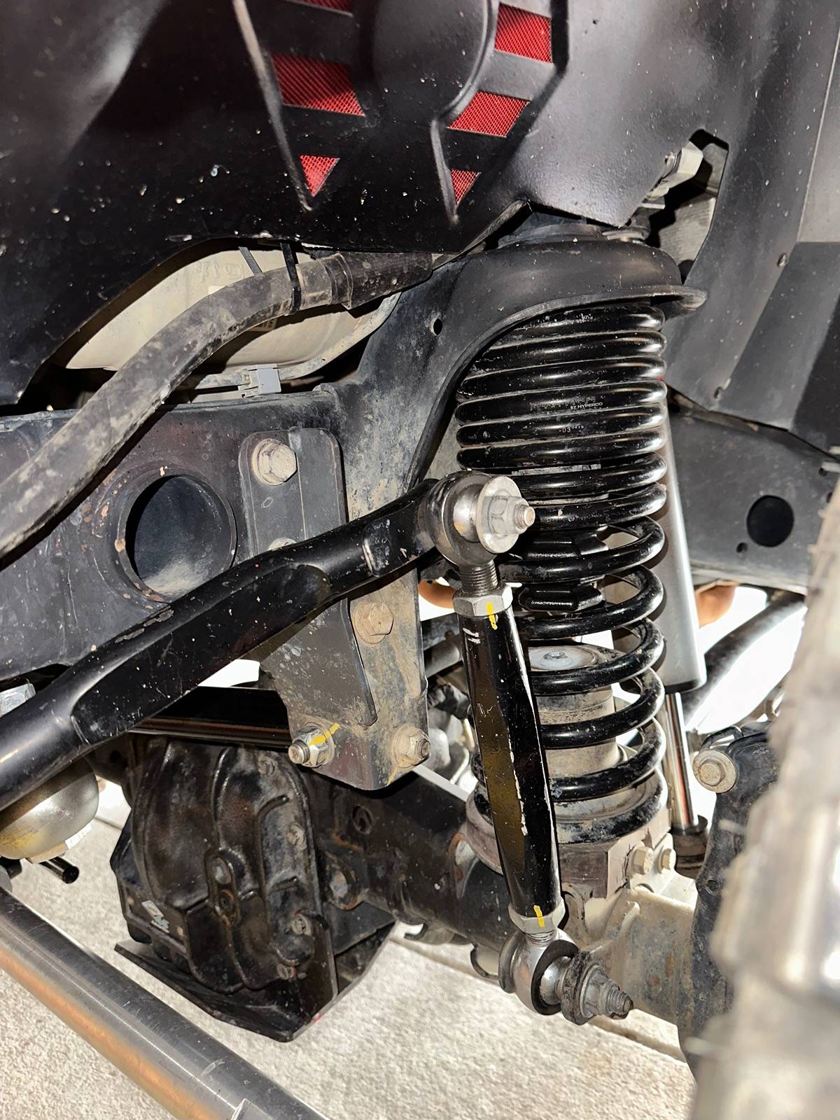

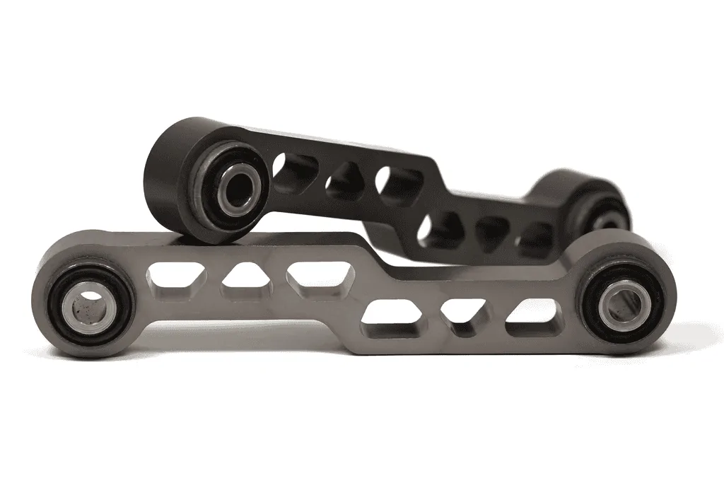

The icon ones are made for 2.5” lifts so should work. They are adjustable in length.
Since the links that came with the mopar kit are only about 7.75", I am wondering if the Icons will work if I decide to swap my springs out later with Metalcloaks to add another inch. The icons show they are 6.75" to 9.75", so I would think it would work fine. Unless I need to get the Jeep up on a hoist and disconnect to confirm??
