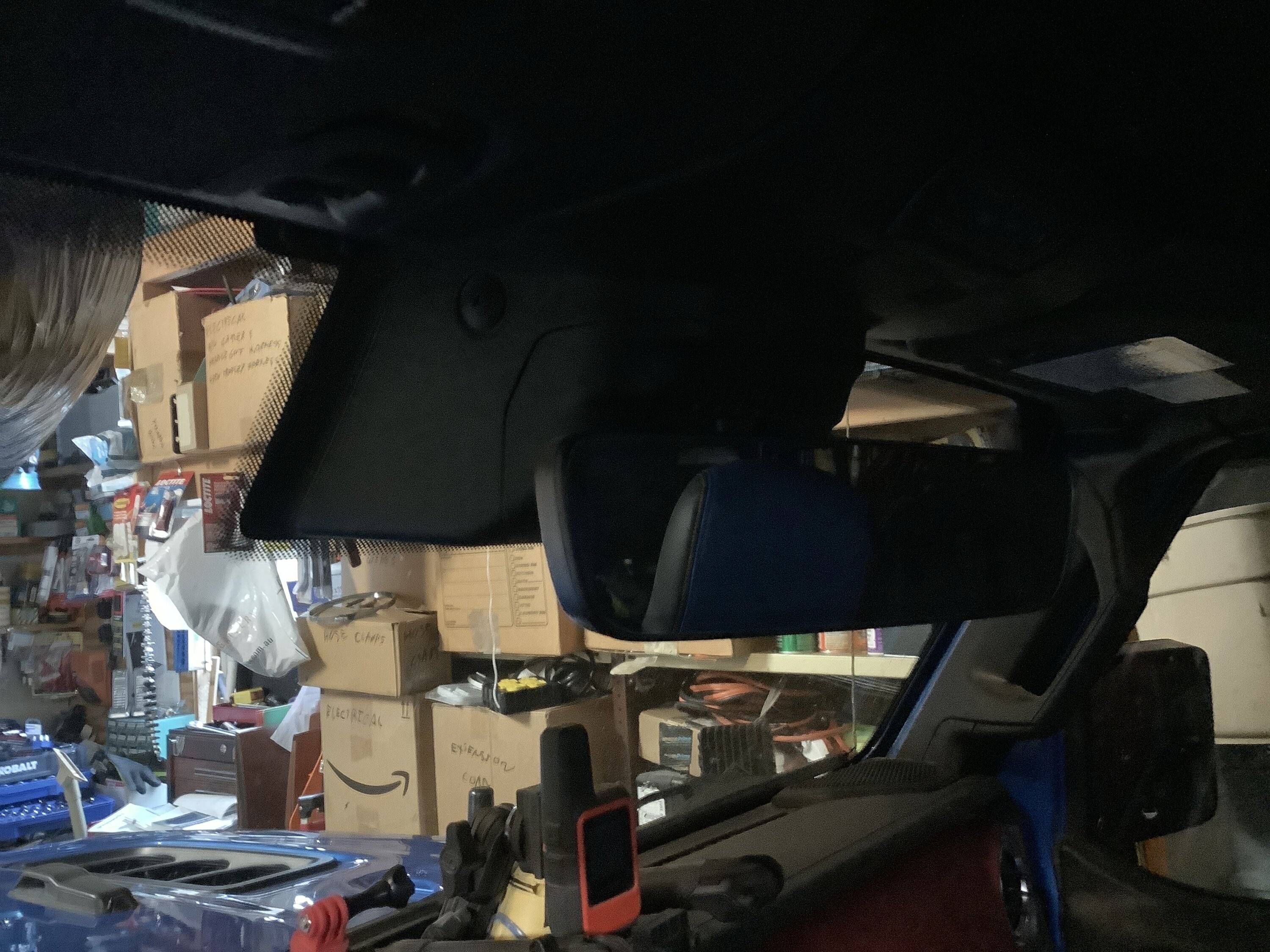

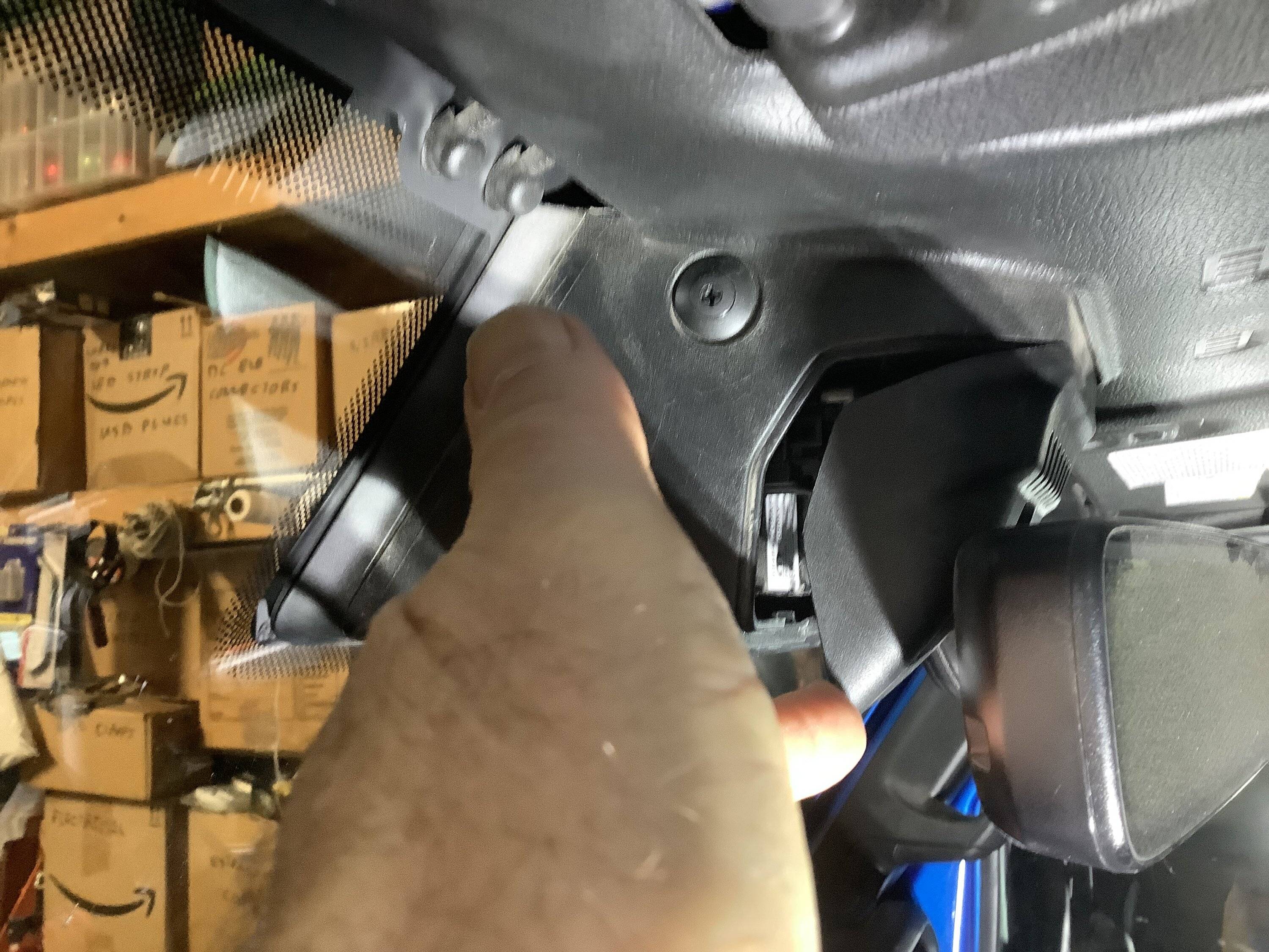

May have been answered but how do you open or remove the cover over the rear view mirror mount on the black box the is over the ACC stuff on the windshield. I can get he lower part to pop out but the top doesn’t want to come out. Don’t want to do something stupid and break it.
Jeep Wrangler JL Digital Rear View Mirror image
