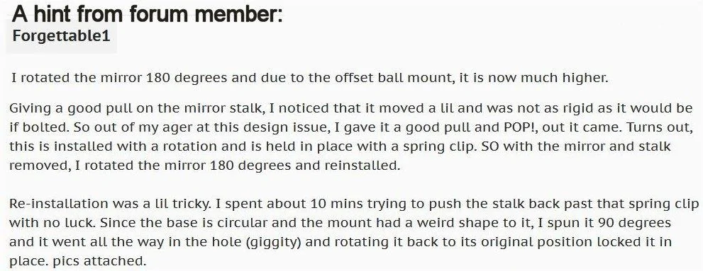

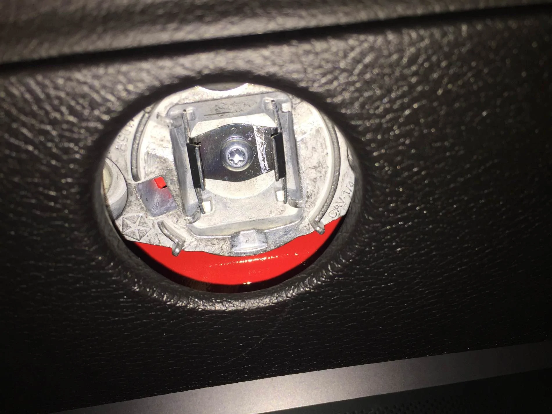

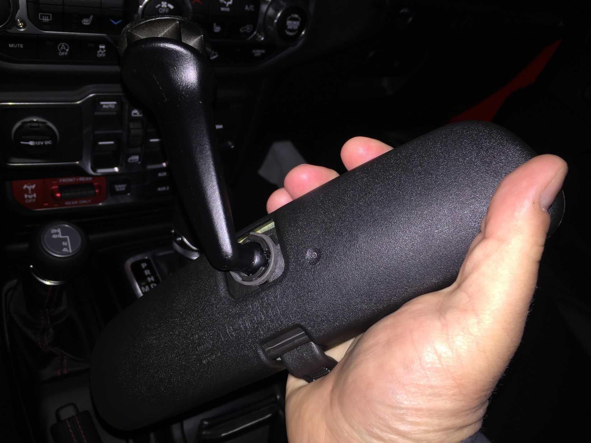

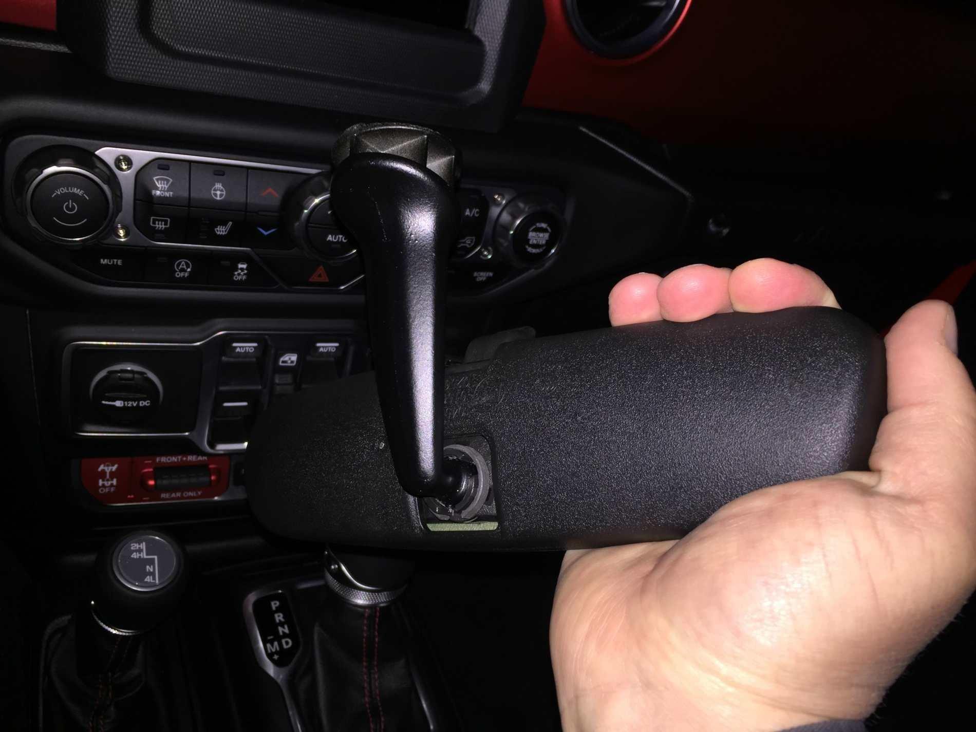

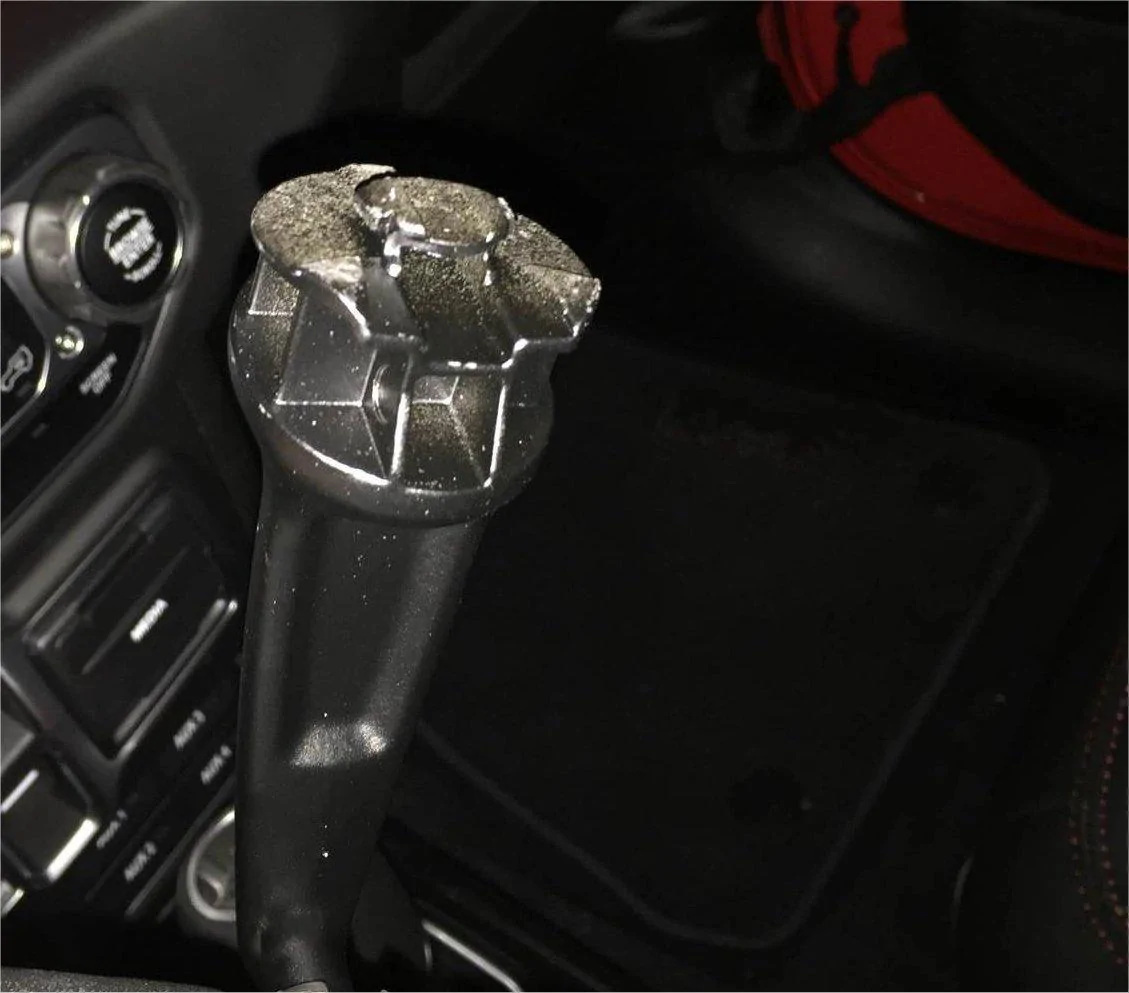

For what it's worth - I didn't have to remove my mount from the ceiling. Just gave it a good push and it spun right upside down. Still don't know why Jeep doesn't just install them this way to begin with!
