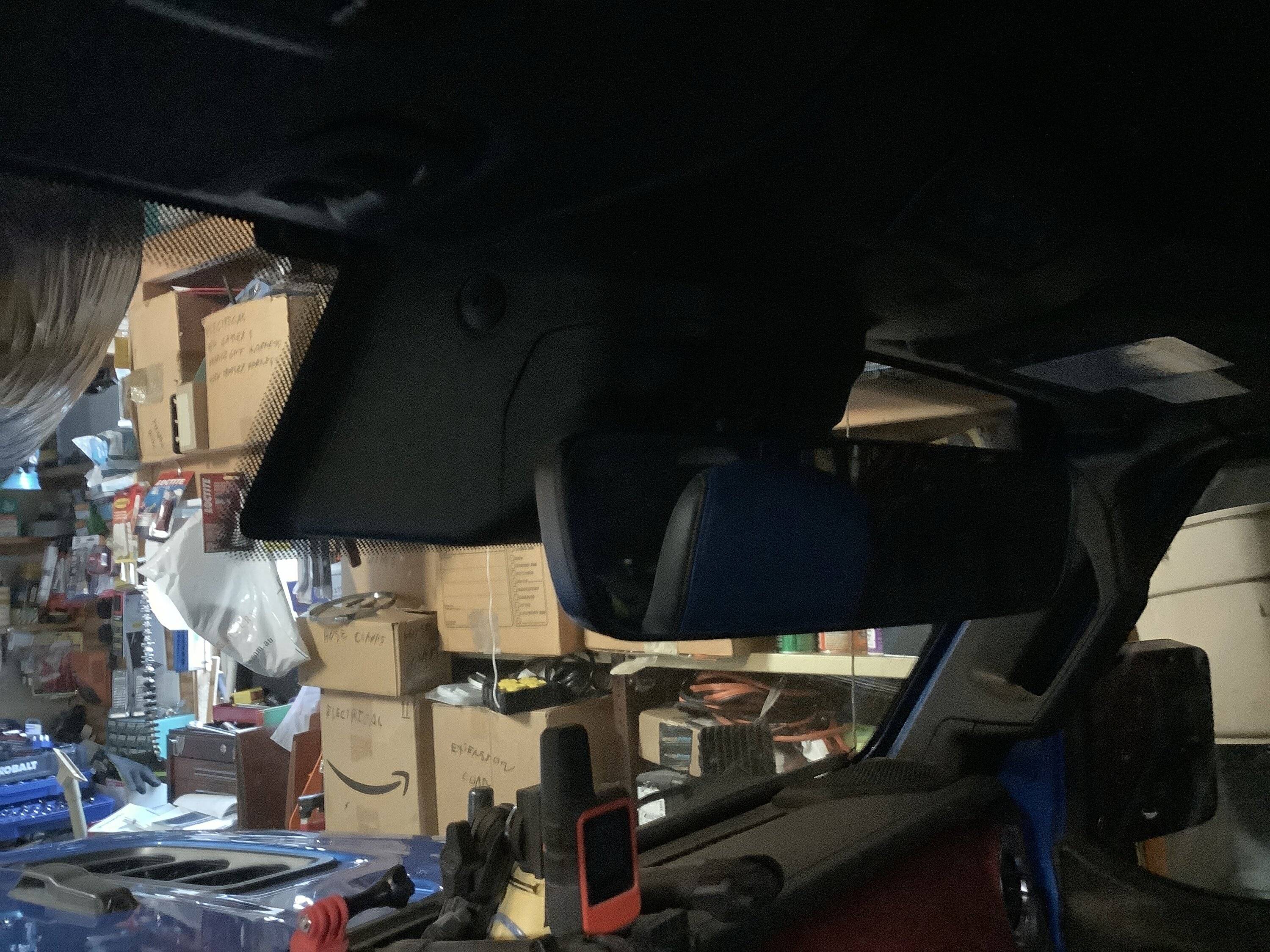

I also have the forward collision and adaptive cruise control so the housing is much bigger. So far no aftermarket replacement mirrors work with it. Also haven’t figured out how to get the mirror out without breaking something.

May have been answered but how do you open or remove the cover over the rear view mirror mount on the black box the is over the ACC stuff on the windshield. I can get he lower part to pop out but the top doesn’t want to come out. Don’t want to do something stupid and break it.
No need to take it completely off, just remove the four plastic screws and let it dangle if needed but once the smaller plastic part is removed you can get access to the three screws to remove the mirror mount.

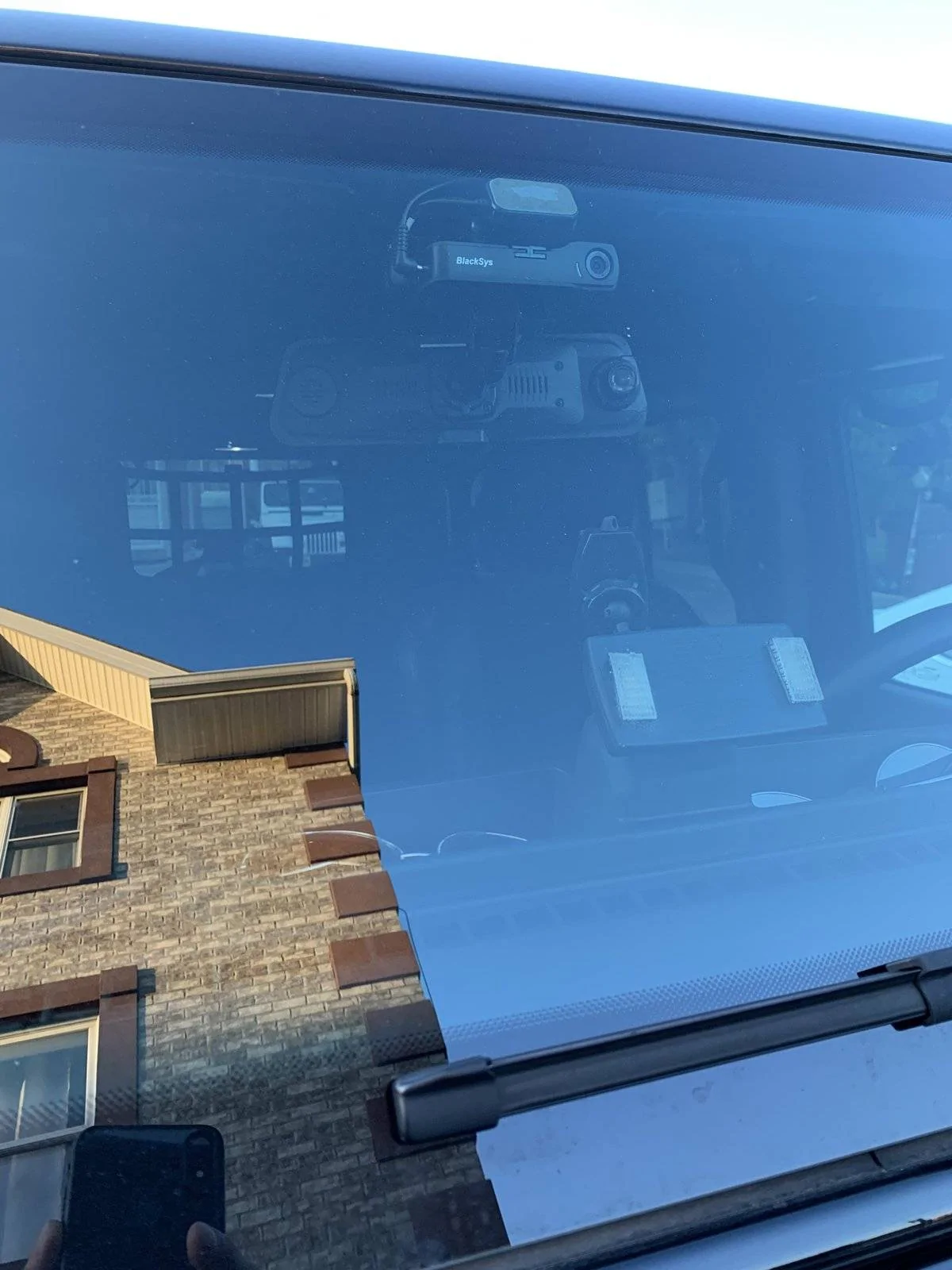

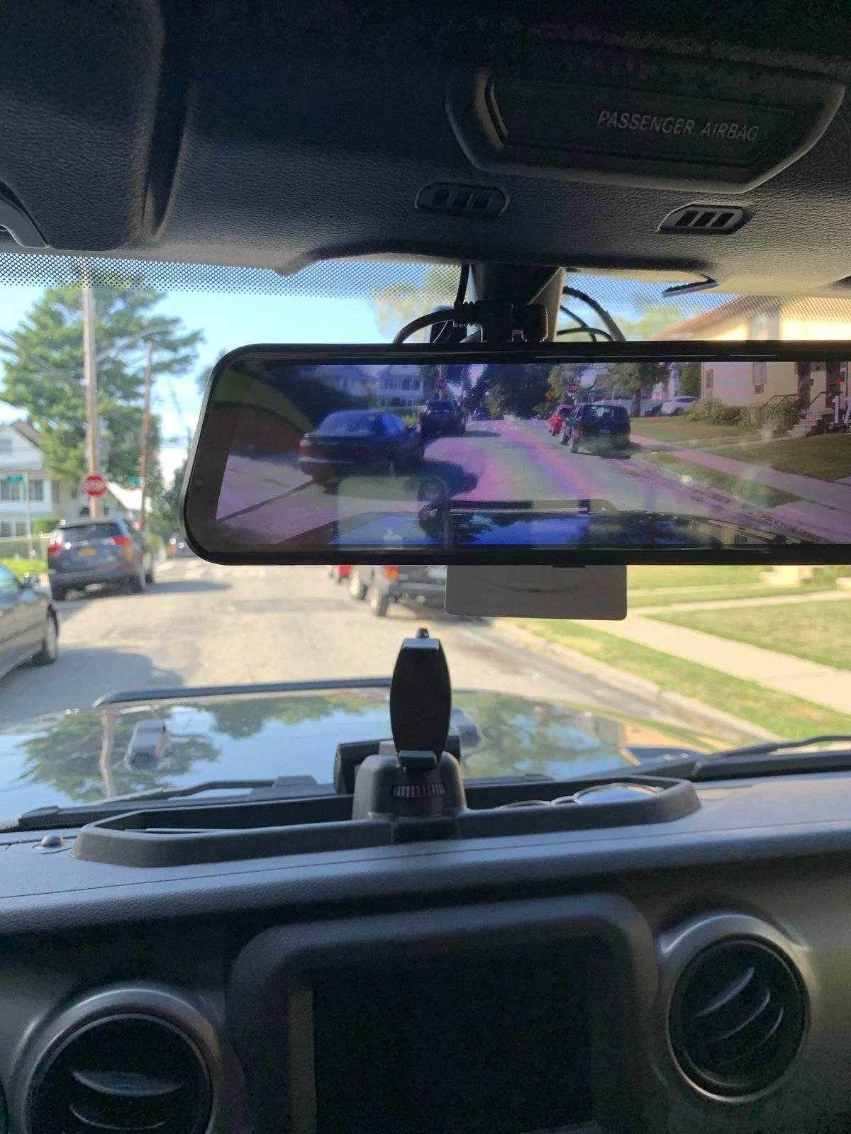

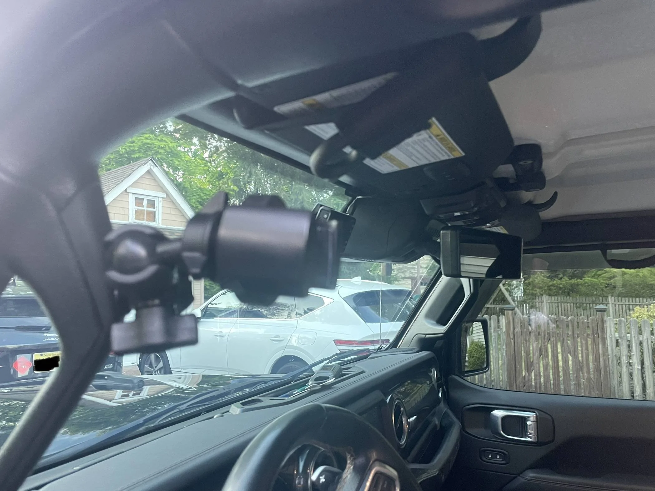

Had a DVR mirror on my ‘18 and it came with its own Jeep bracket so you can swap out the OEM and reuse the hardware to mount. One of the cleanest solutions for dash recording and seeing out the back.
Amazon also sells the mount itself: the
mirror bracket is 22mm if I remember correctly. The rake sweeps forward towards you more so than OEM. You can also sorta build your own mount by buying the mirror delete bracket from CMM and using ram arms/joints.
Many of the digital mirror sellers on Amazon are the same shops you can find on AliExpress. The company I used was called and most mirrors are 10-12” screens. Your sun visor will hit the new mirror if you are still using it/ positioning it normally with the screen turned off. I had mine positioned dead center to avoid this and ran the dvr screen on all the time. I also had my rear camera installed on the rear center of the sports bar to prevent the glare you’d get from installing the camera on the exterior.
For the new Jeep I went w/ a 8” lcd screen mirror w/ 4 inputs but it’s not a dvr so the dash cam is mounted separately ??‍♂
