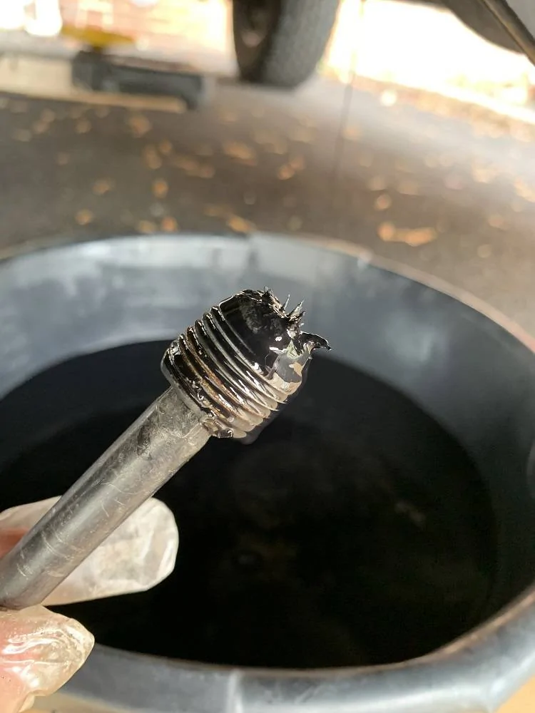

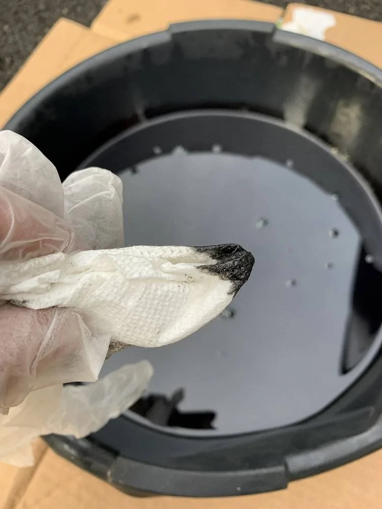

Here's a few shots from today - my JL Sport has the M220 rear with Trac-Lok, 15K miles on it. Glad I did this today!
Jeep Wrangler JL Differential oil change IMG_4344
Jeep Wrangler JL Differential oil change IMG_4347
The oil was black as tar, with a nice little pile of stuff on the magnet as well. I think I will continue servicing the rear on my JL at 15K mile intervals, and the front at 30K. My wife's JLUS has the open M200 rear and we don't take it wheeling so I think I'll just do them both when it hits 30K.

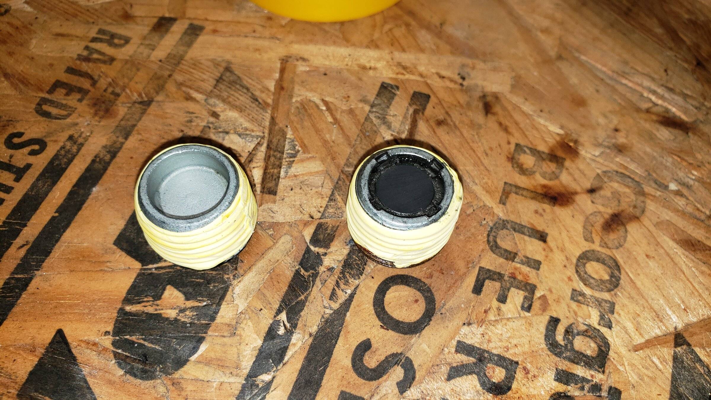

Did my Diff fluid change this weekend @ 28k mi. Using a Fluid Pump for the bottles made this job a walk in the park.
Used Valvoline 75W-90. Added 1oz of LSD additive to the front and 2oz to the rear.
Front Diff took exactly 1 QT of fluid.
Rear DIff took 1 and 3/4 Quarts of fluid.
Thanks to @JAY for the easy to find post with torque specs for the plugs.
No metal chunks and just a light bit of shavings found as normal.
Jeep Wrangler JL Differential oil change Diff 1
Jeep Wrangler JL Differential oil change Diff 2
