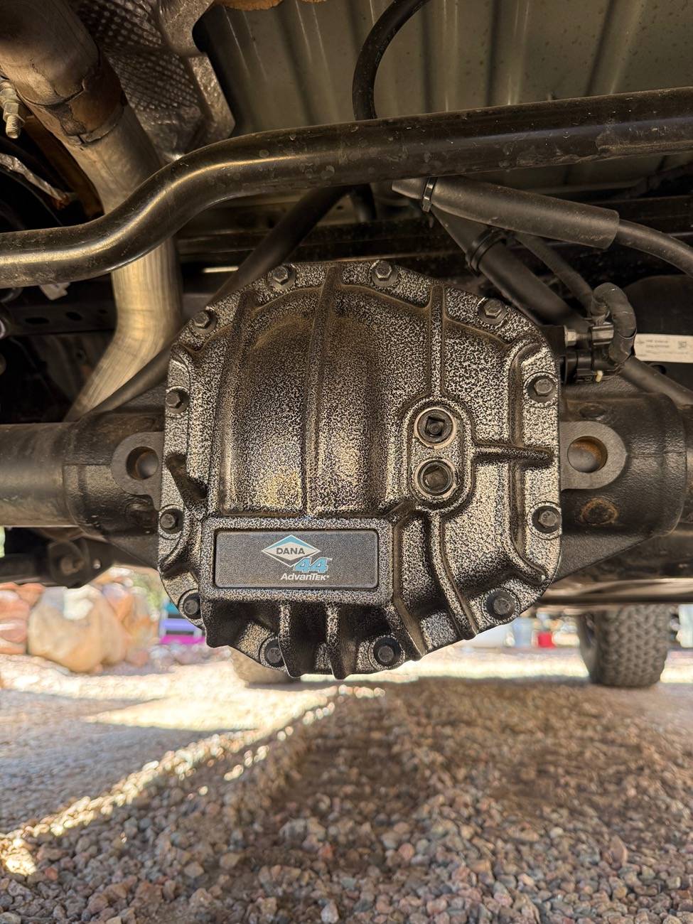

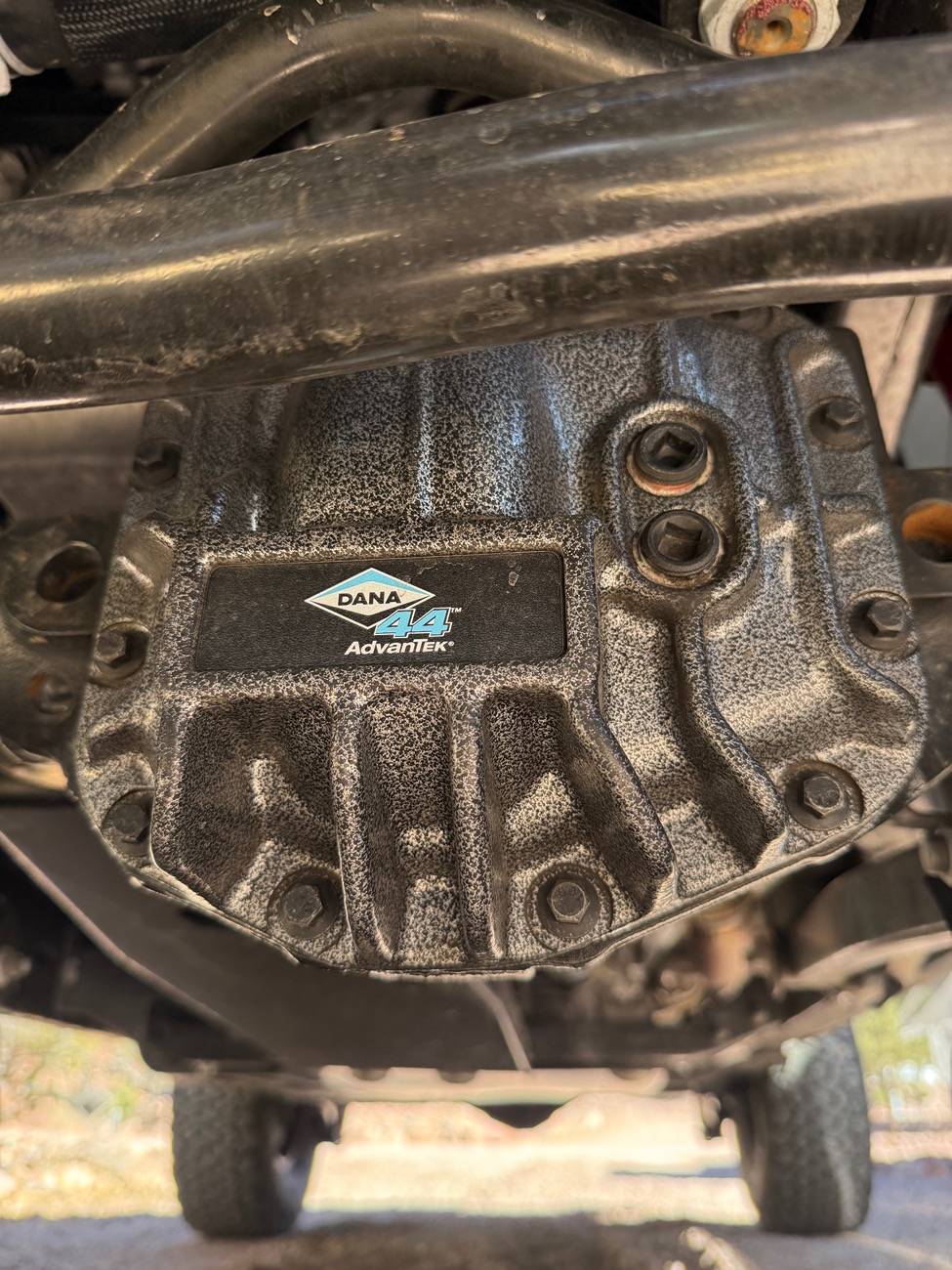

Just installed Dana Spicer AdvanTek front and rear diff covers on my 2025 JLURX. Filled with Valvoline 75W-140 front and rear per Dana Spicers recommended specification.
Do you happen to remember about how much oil you used in total? I’m going to have the gears changed out and replace the stock covers with the Dana AdvanTek covers. They look like they might be a bit bigger in internal volume though I don’t know until the stock covers are removed. Did you get the grey, blue or primed version? I got the primed. Going to paint them black. Also, did you reuse the stock gaskets?
I bought 4 of the 1 quart flex packs but only ended up using 3 total to get both the front and rear refilled. I doubt the covers change the internal volume based off my observations.
I bought the grey version and they look very nice. I did reuse the stock gaskets and the hardware that was provided with the covers. You could reuse the factory bolts as they are the same length and grade. I torqued them to about 22-24 lb. ft.
