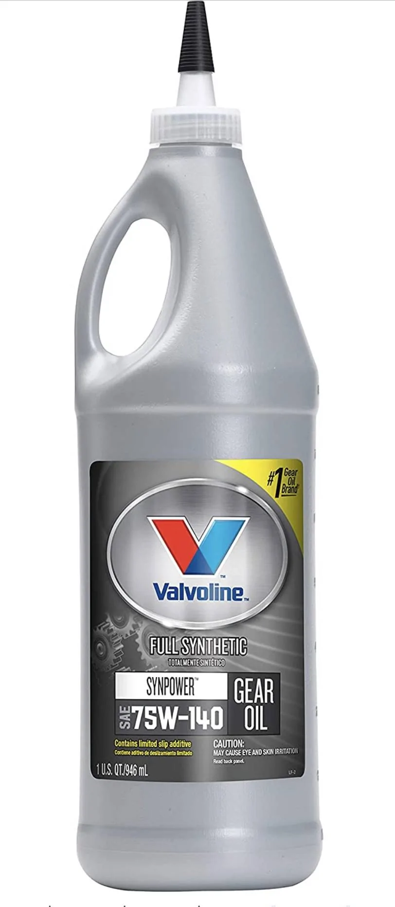

I’ve performed two complete front/rear differential fluid changes on my 2019 JLUR and it sits with a hair under 27K on the clock.
I daily my JLUR about 25 miles round trip each day and try to at least mildly stretch its freeway and off-road legs at least once a month.
I’m running Valvoline Full Synthetic 75w-140 in both the front and rear and have had excellent results with that fluid in my Dana 44s.
Given it’s price point, ready availability, Chrysler MS-8985 certification and for those of you with the limited-slip diffs it also has the friction modifier included, it’s pretty hard to beat.
