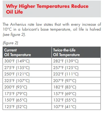

Any data on gear oil life vs temperature? I would think we're ok in the low 200s, but as we get closer to mid 200s life would be exponentially shorter.
Here is a pretty good read on it from Shell - https://www.shell.us/business-custo...filet/effect-of-temperature-on-viscosity.html
There is a PDF in the article (https://www.shell.us/business-custo...ect-of-temperature-on-lubricant-viscosity.pdf) that has this table in it (though their °C to °F conversions appear to be off on the 325°F and 107°C cell)--it should be 225°F and 107°C):
Jeep Wrangler JL Diff fluid - Wrangler JL Oil Temperature vs Oil Lif
