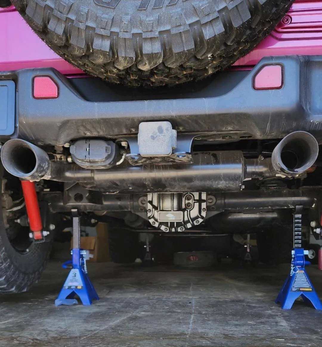

I bought 4 of the 1 quart flex packs but only ended up using 3 total to get both the front and rear refilled. I doubt the covers change the internal volume based off my observations.
I bought the grey version and they look very nice. I did reuse the stock gaskets and the hardware that was provided with the covers. You could reuse the factory bolts as they are the same length and grade. I torqued them to about 22-24 lb. ft.

Just installed Dana Spicer AdvanTek front and rear diff covers on my 2025 JLURX. Filled with Valvoline 75W-140 front and rear per Dana Spicers recommended specification.
