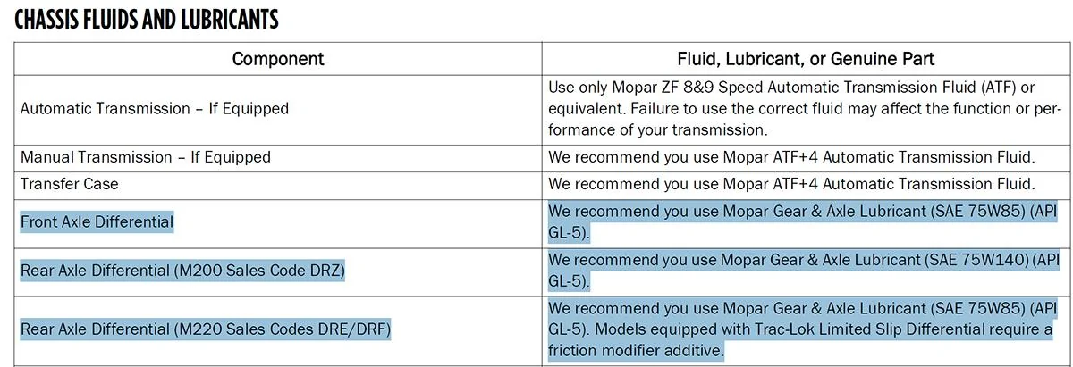

As per the owner's manual
Jeep Wrangler JL Diff fluid question Untitled-1
I would not use 75w-140 in Canada in the winter.
We had some trucks in Alaska that failed axles due to 75w-140 solidifying.
