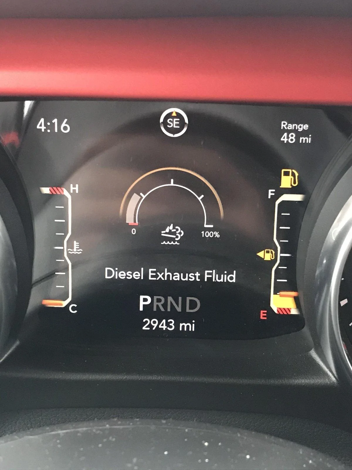

Loving my Diesel Rubicon so far but I don’t believe we will get anywhere near the 10k miles per DEF tank that I heard previously. Mine was almost full when purchased and after about 3k miles I’m less than 1/4 of a tank. I prob have more miles on mine than most people but has anyone else noticed their usage of DEF? Not a big deal but just curious if my rate of DEF usage is typical.

Hi all, new to the Jeep club. Last night I purchased a 2021 JLUR w/ecodiesel. Today, although my DEF indicator was just shy of 3/4 full, I decided to top the DEF off. I was able to put 2.5 gals in and the indicator is still not showing full.
Does anyone believe the DEF indicator is accurate? Curious why it would show almost 3/4 full but I was able to add 2.5 gals. Indicator should have been registering just shy of 1/2 IMO.

The gauge is trash and it seems to be overestimating on most, if not all examples. Hence why anyone claiming terrible DEF range without hand-filling their tank to the neck is reporting inaccurate range.

I’ve read that here on this forum, and maybe you were the one who stated hand filling to the neck; which is why I attempted to fill mine. Was a little taken back when the gauge didn’t change much even though I added a full box of DEF.
