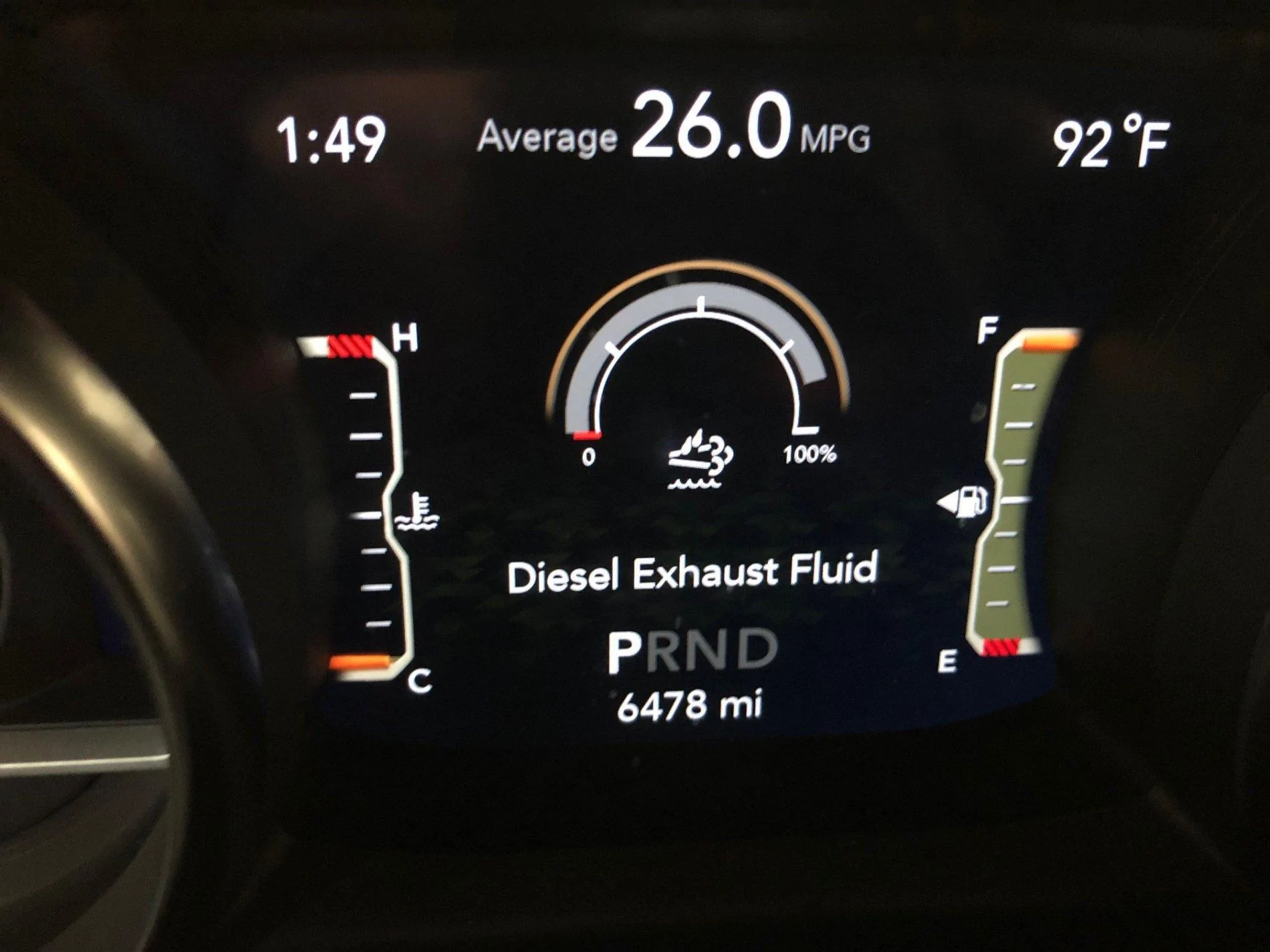

I have filled the DEF tank with 5 gallons of DEF and I am at 6,478 miles, the Def Gauge is at 7/8 full.
75% rural/suburb (avg speed 45 mph) and 25% expressway driving (avg speed 70mph).
I check the mpg every fill up, worst 21 mpg, best 26 mpg.
The Jeep computer calculated MPG is at least 1 mpg off from actual math. I use "The Fast Lane" method of filling the tank: fill until auto shutoff, wait 30 seconds fill up until auto shutoff to get a consistent full tank measurement.
