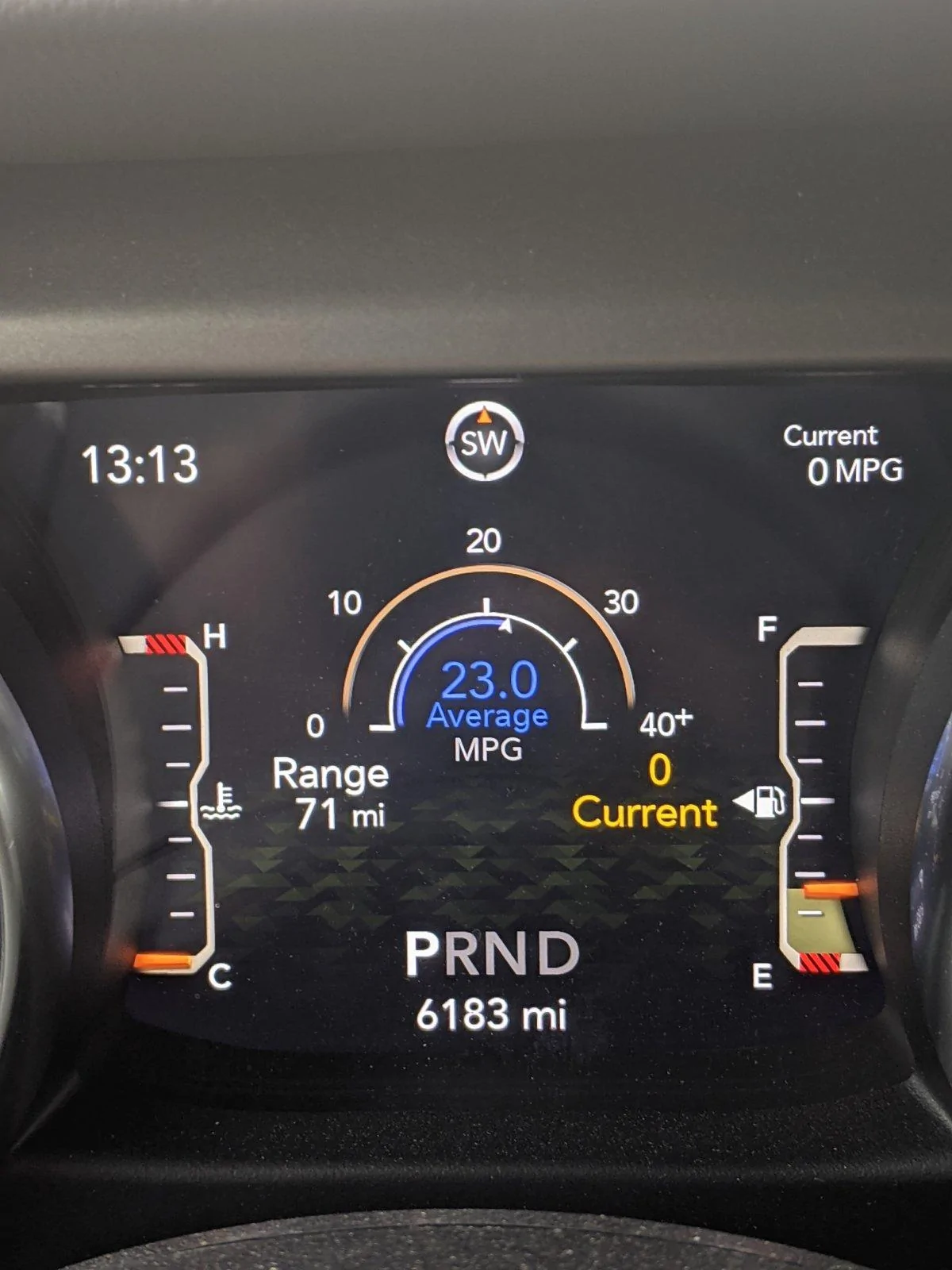

Sorry for the delayed response... Here is my current mpg average. I've never reset this guage, and I've never calculated myself.
Jeep Wrangler JL DEF Usage PXL_20210105_181314177.MP
