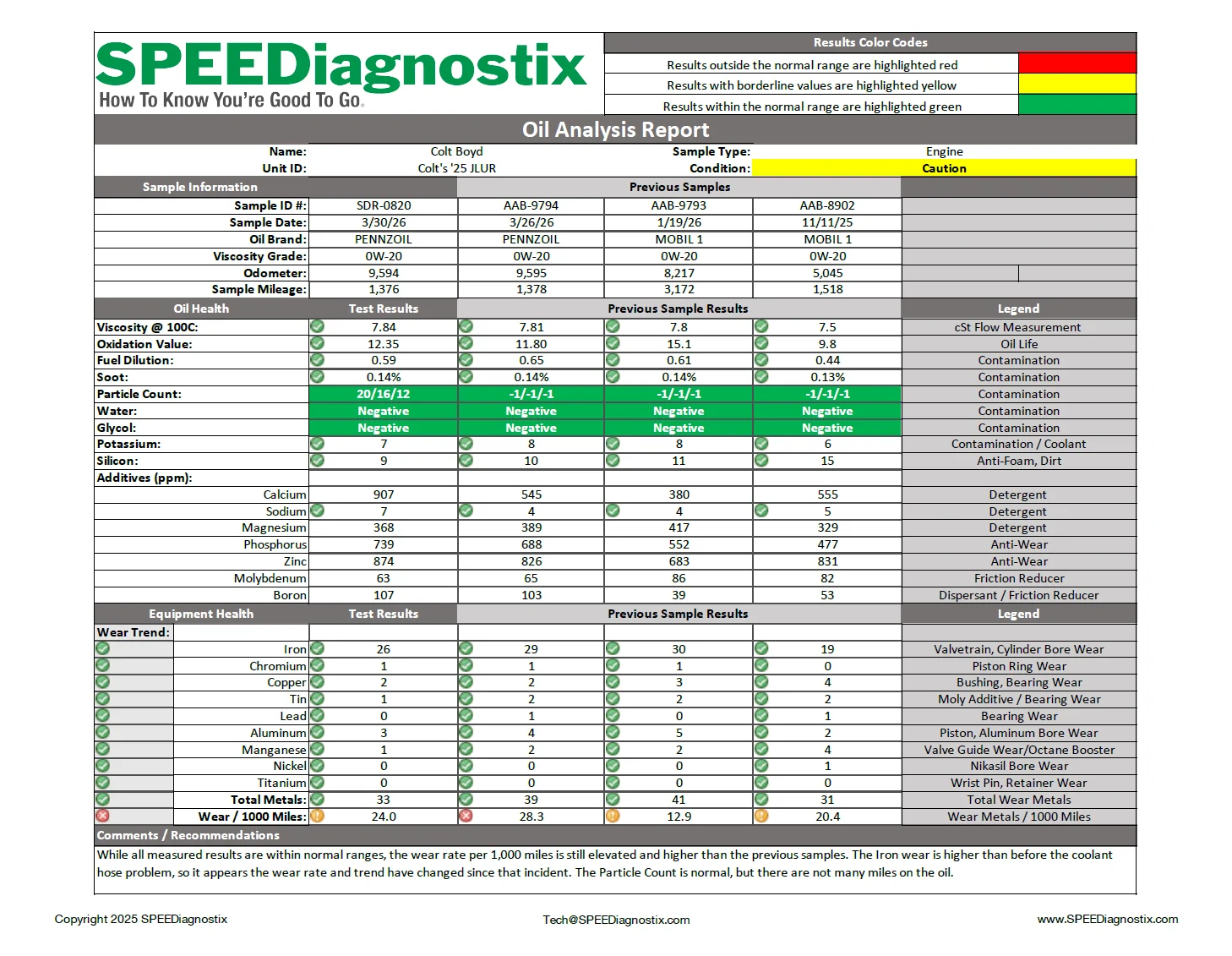

I thought I'd include the UOAs too. Both were taken at the same mileage (1,376 on oil) several days apart.
AAB-9794 is a test kit I had on hand. It was sampled from the drain plug after bringing the engine up to temperature.
SDR-0820 includes particulate sampling and was taken from the dip stick tube a few days later. Again, the Jeep was brought up to temperature.
I attribute the discrepancy to the sampling method (tube vs drain plug). All samples prior to SDR-0820 were taken from the drain plug.
