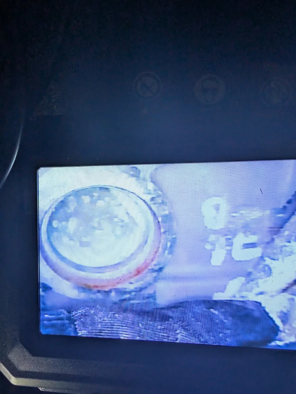

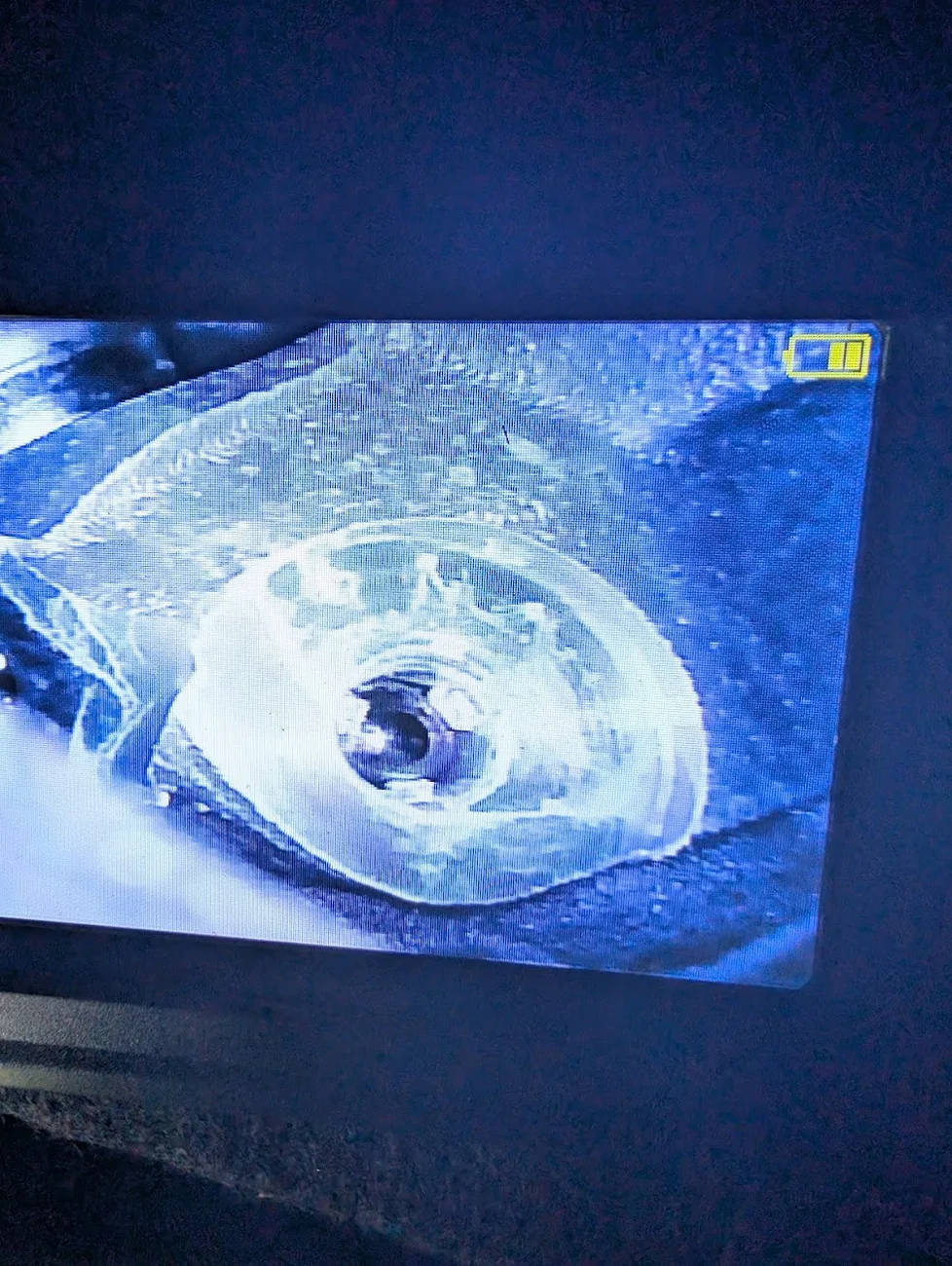

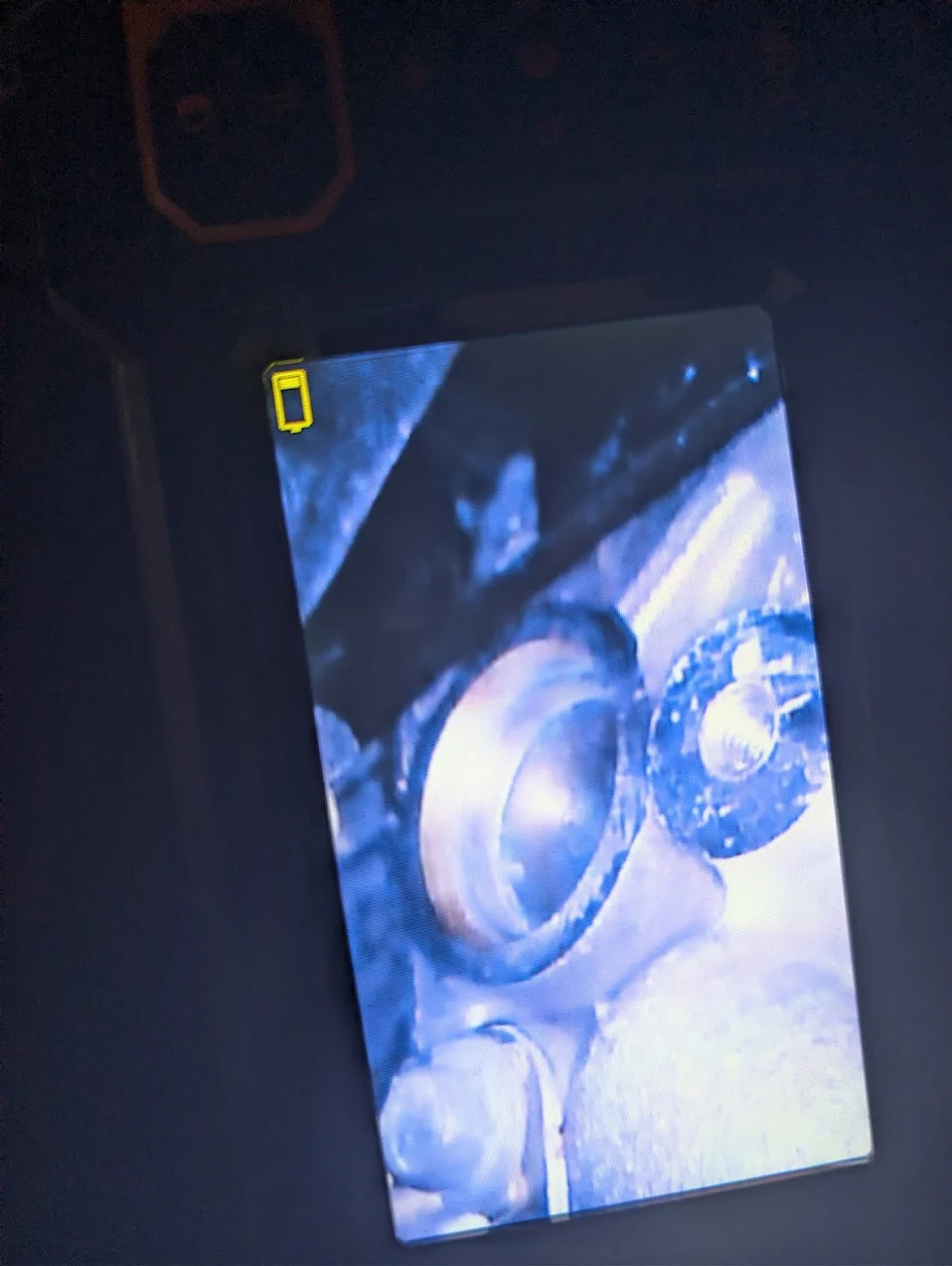

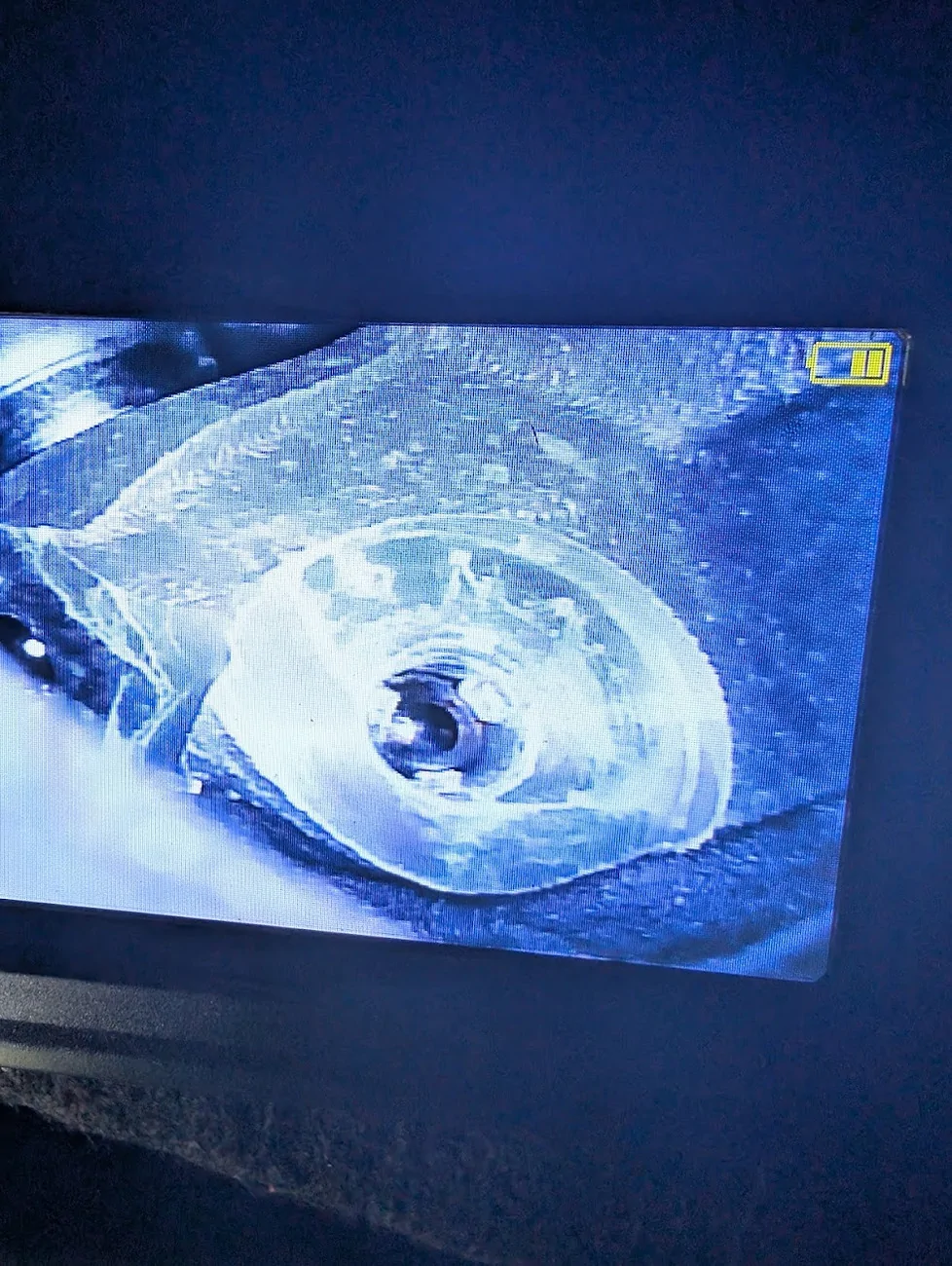

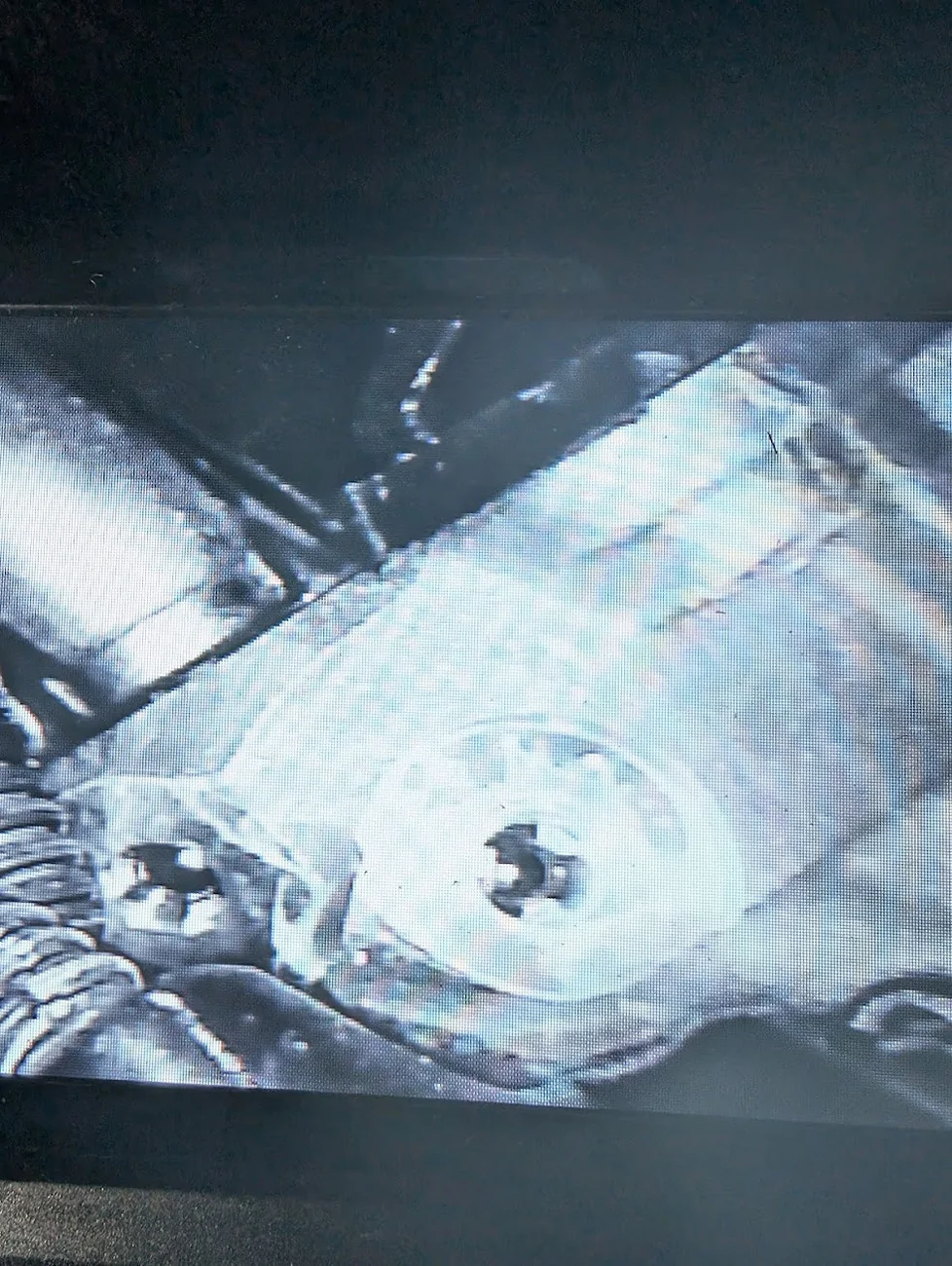

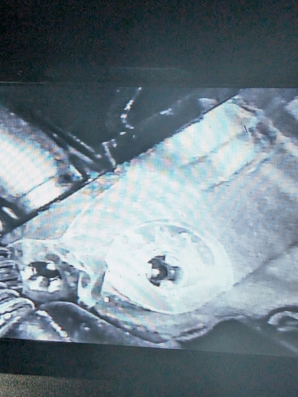

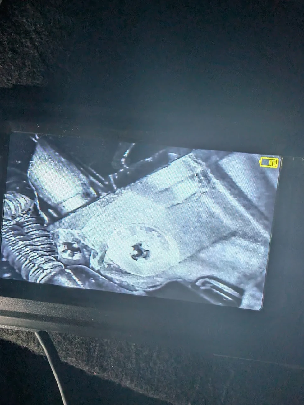

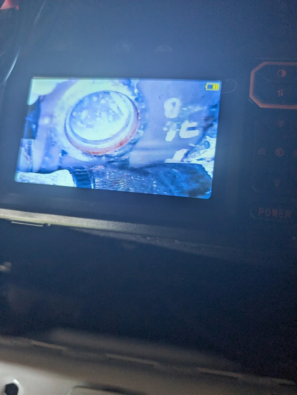

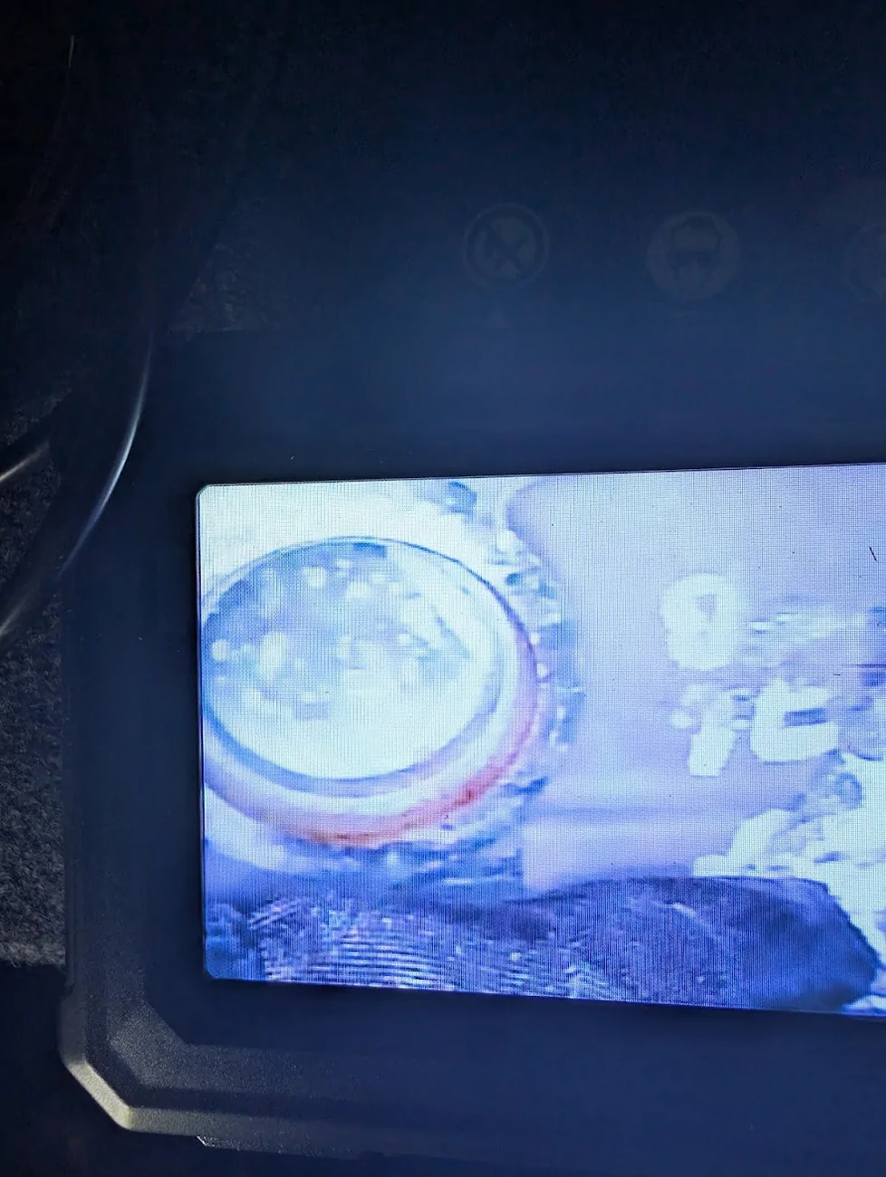

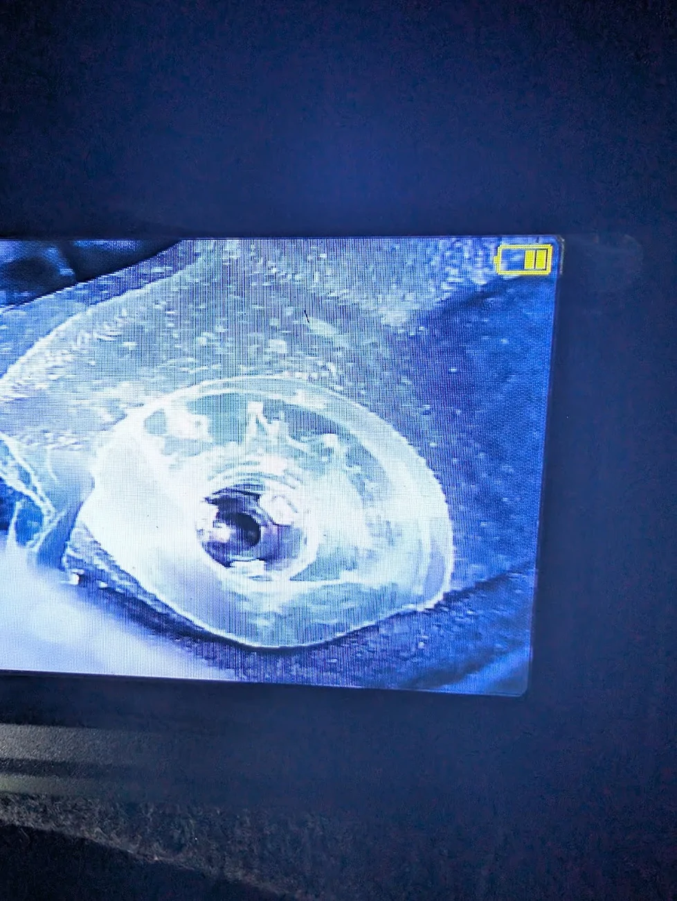

I cant tell, but I don't think this thing has heat tabs. I know the images look like they were taken with a potato.
Passengers side between the firewall and block near the head:
Jeep Wrangler JL Dealership overheated my engine PXL_20260523_191316650
Jeep Wrangler JL Dealership overheated my engine PXL_20260523_191321888
Jeep Wrangler JL Dealership overheated my engine PXL_20260523_191329626
Jeep Wrangler JL Dealership overheated my engine PXL_20260523_191450399
Jeep Wrangler JL Dealership overheated my engine PXL_20260523_191451783
Jeep Wrangler JL Dealership overheated my engine PXL_20260523_191453850
Jeep Wrangler JL Dealership overheated my engine PXL_20260523_194032140
Jeep Wrangler JL Dealership overheated my engine PXL_20260523_194045817
Jeep Wrangler JL Dealership overheated my engine PXL_20260523_194052930
Drivers side between the firewall and block near the head:
