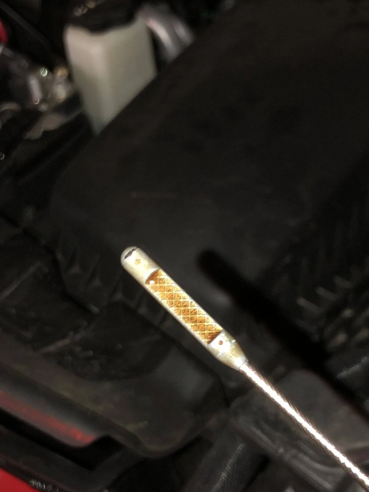

That is exactly the same as mine, I would think if it was an entire quart over it would be higher up.
It there any particular reason why you feel it should be higher if they put a full quart extra? I don’t know where exactly the dip stick enters the engine or whether it’s at an angle to provide more resolution so I’d love to know if there’s something you know lol

Not that you asked me, but from my experience with dealer oil changes that looks about 1 quart overfilled to me. That’s about where mine was after my first dealer 6 quart oil change (checked in the dealer’s driveway).
After they “corrected” it it was right at the junction of the wire and and the rounded part. I think that was still slightly overfilled and I drained about 5-1/2 quarts when I changed it myself. On mine if I put in exactly 5 quarts it will be at the very top of the cross hatched area.

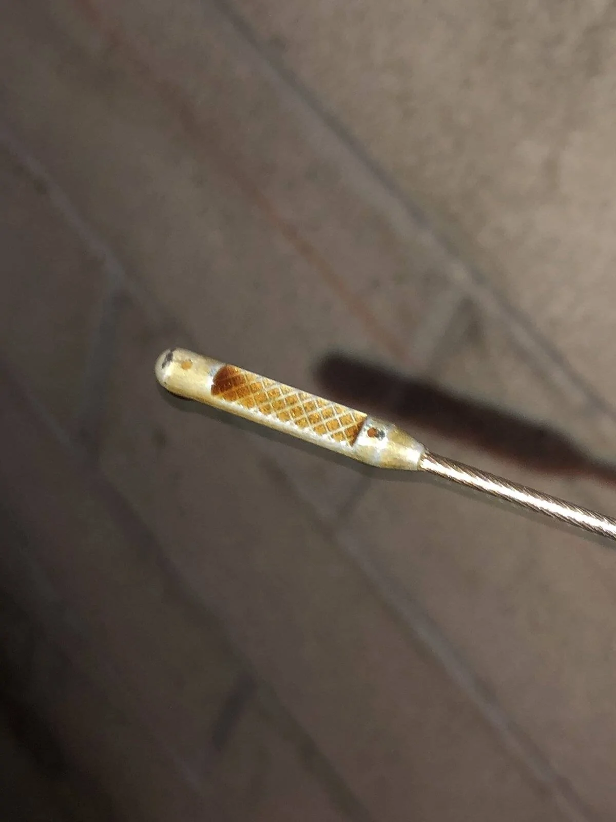

I got my first oil change recently at the dealer and the guy writing the paperwork noted in the paper that the Jeeps takes 5quarts but after the oil change I saw the invoice and the quantity for the oils was 6 and I went up to him and asked him why it’s six when it should be five and he said something about the lines needing to be filled too? That sounded a little odd to me but I didn’t continue it and I left.
Today I was about to leave for a leisurely little road trip and randomly decided to check the level. I had initiated remote start so the engine was warmed up. I checked the oil about one minute after I shut off the engine.
Is my engine severely overfilled or did I check it incorrectly??
I removed the dipstick and fully cleaned it about five times and rechecked and got the same results shown in the photos.

Holy crap. Mine’s already almost half an inch onto the wire, I can’t imagine another inch on top of that!
But after some reading I did recently, it appears that the worst that can happen is the crankshaft starts hitting the puddle of oil on the bottom as it rotates, which can at worst cause some cavitation and bubbling of the oil, which may slightly lower the life of bearings and seals (if that bubbling ever reaches up there).
Someone correct me if I’m wrong, but I’d wager a guess you’d need to be somewhere along the lines of having 50% more oil in ur engine before your crankshaft starts to make contact with the puddle when it rotates. Barring super car engines and whatnot.

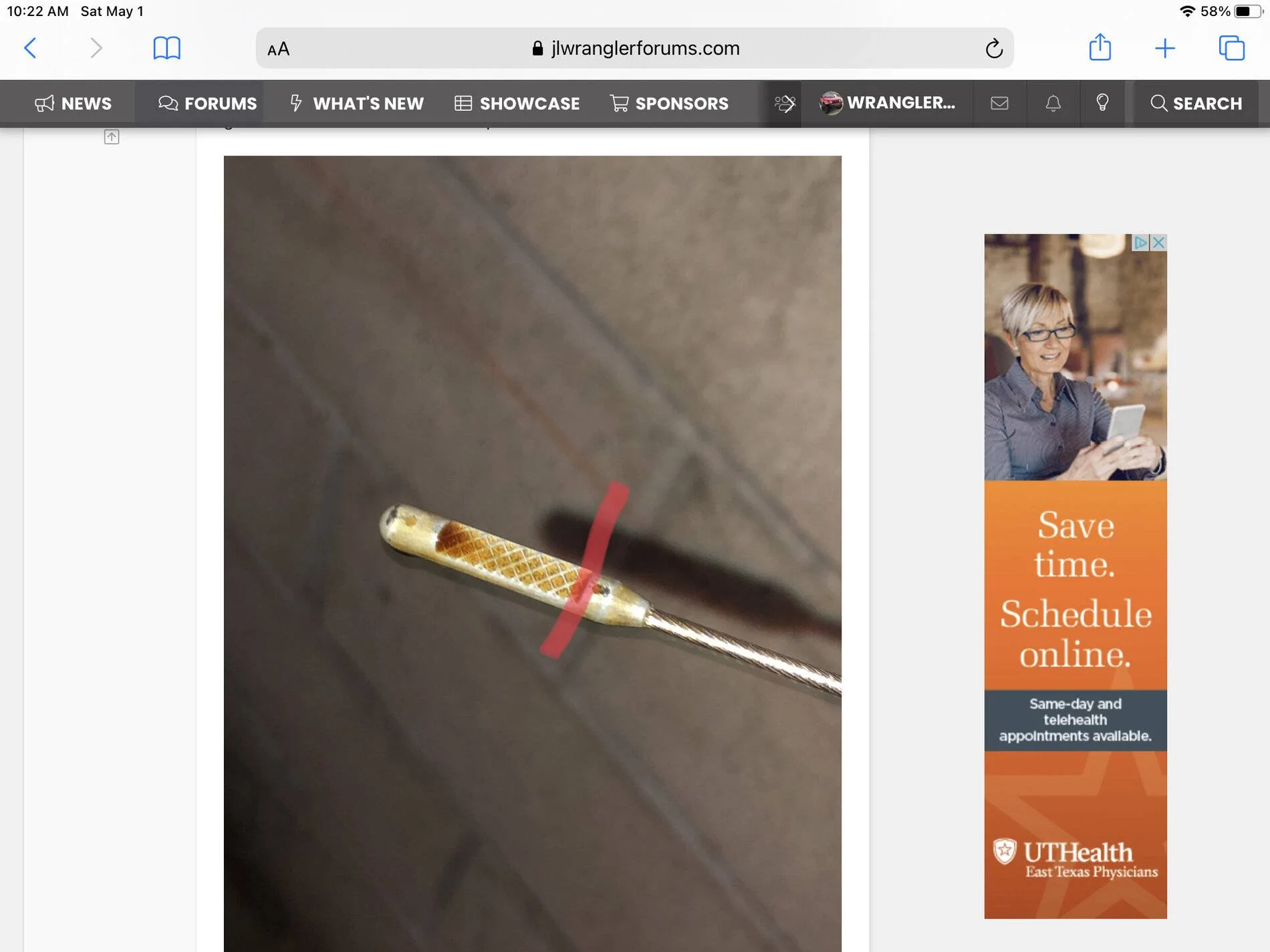

Anything past the red is over filled

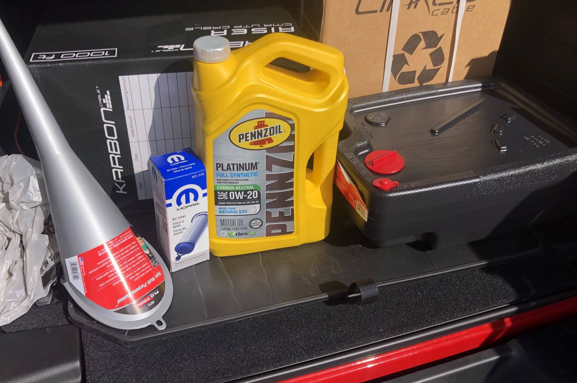

Mine always look like this and I do my own oil changes. 5qts pennzoil jug. I dont think it is that accurate.
I never get over 5qts of oil when draining and I let it drain for a very long time.
