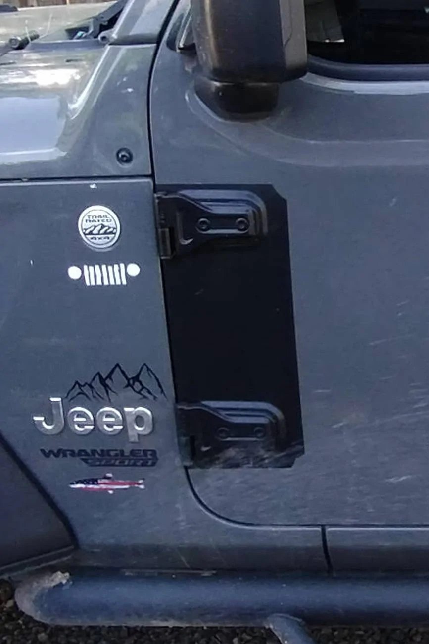

I live on Eastern Plains of Colorado. Local Dealer said to go to local body shop who does their warranty work. Body shop wouldn't do it since dealer hadn't paid them for last couple wrangler jobs.
I decide it is a Wrangler. This was a DIY job. So an afternoon, big wrench to break bolts, some sand paper, gasket material, tape, primer, and a spray can of truck bed liner fixed my 2020 JL just fine. Looks better than picture shows, but I like the way it turned out.
So far so good, anyway! Nice thing about the bed liner, hides imperfections and easy to touch up!
This legit looks good in my opinion. Definitely an option if mine gets into the doors.
