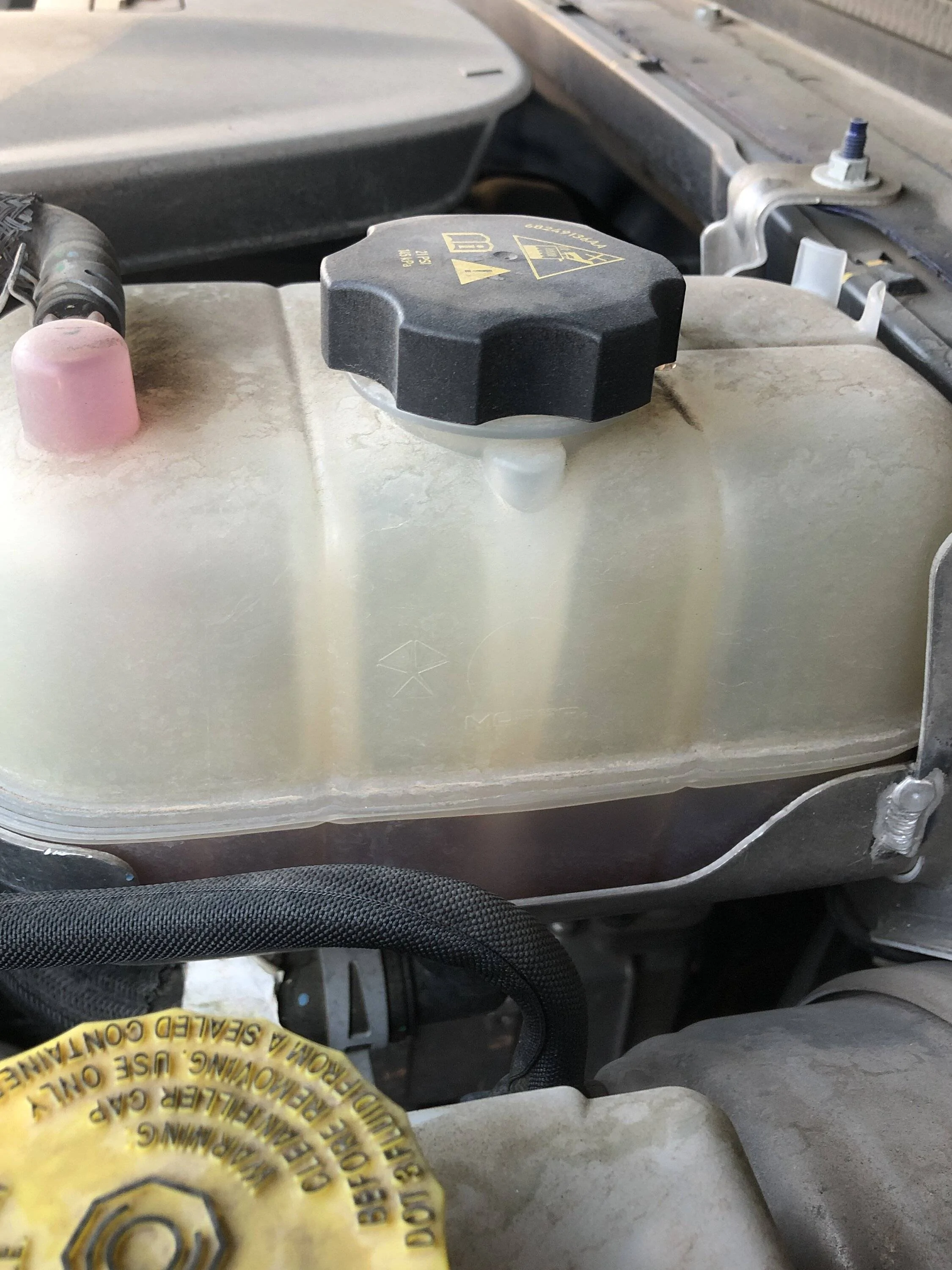

Also, it makes sense that dirt buildup could be the issue considering the amount of mud I've put the vehicle through in the past 4 years - although I think coolant may also be an issue since it looks kind of brown rather than the red I think it is supposed to be.

brown not good

brown not good
well I posted the picture of the overflow reservoir for the coolant, looks brown to me, maybe you can tell me otherwise?

brown not good
Picture is on page 2, it looks okay. No funky residues, just mileage. Drain and refill of coolant when replacing radiator will take care of that, unless the head gasket is blown of course.
