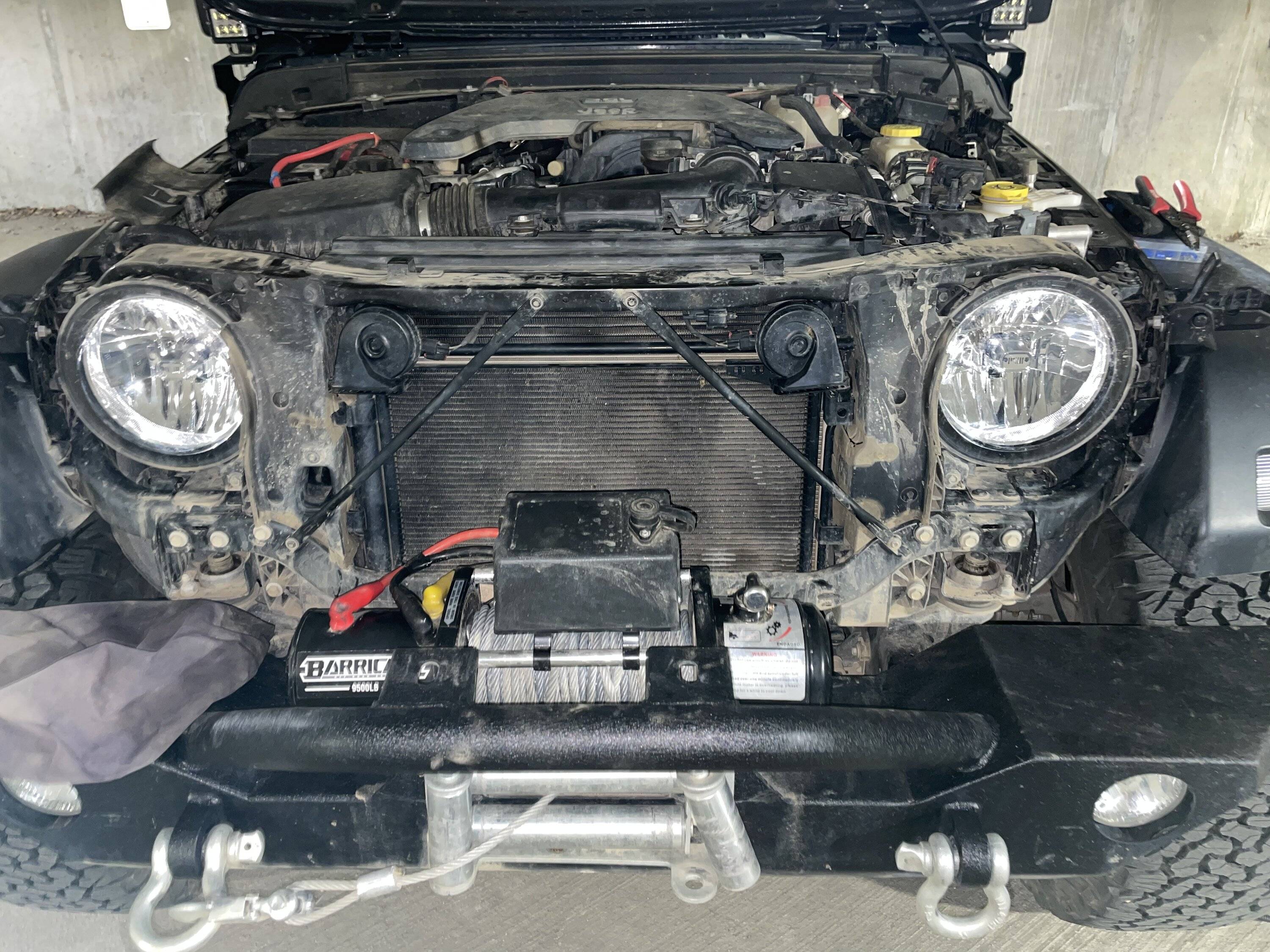

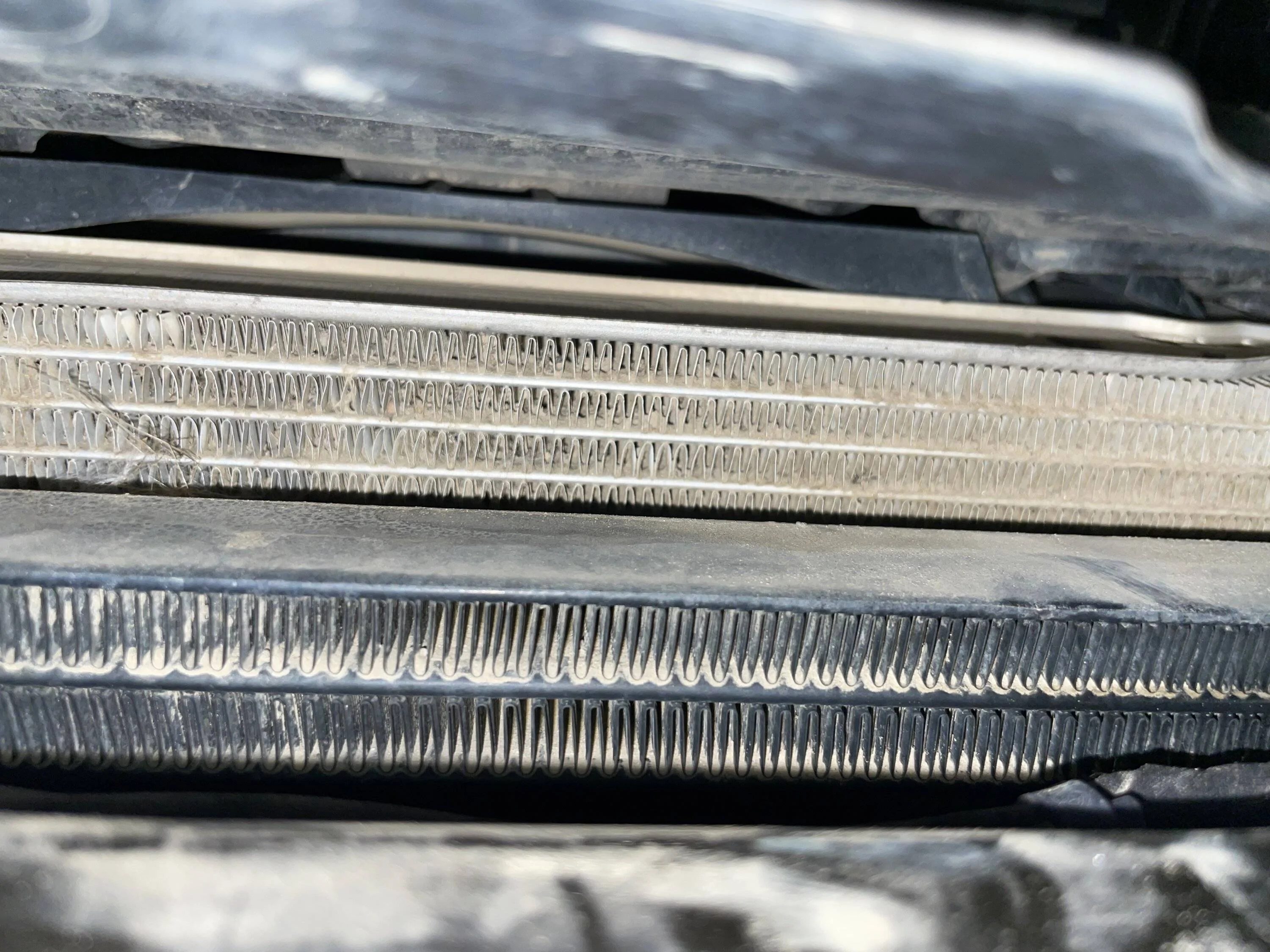

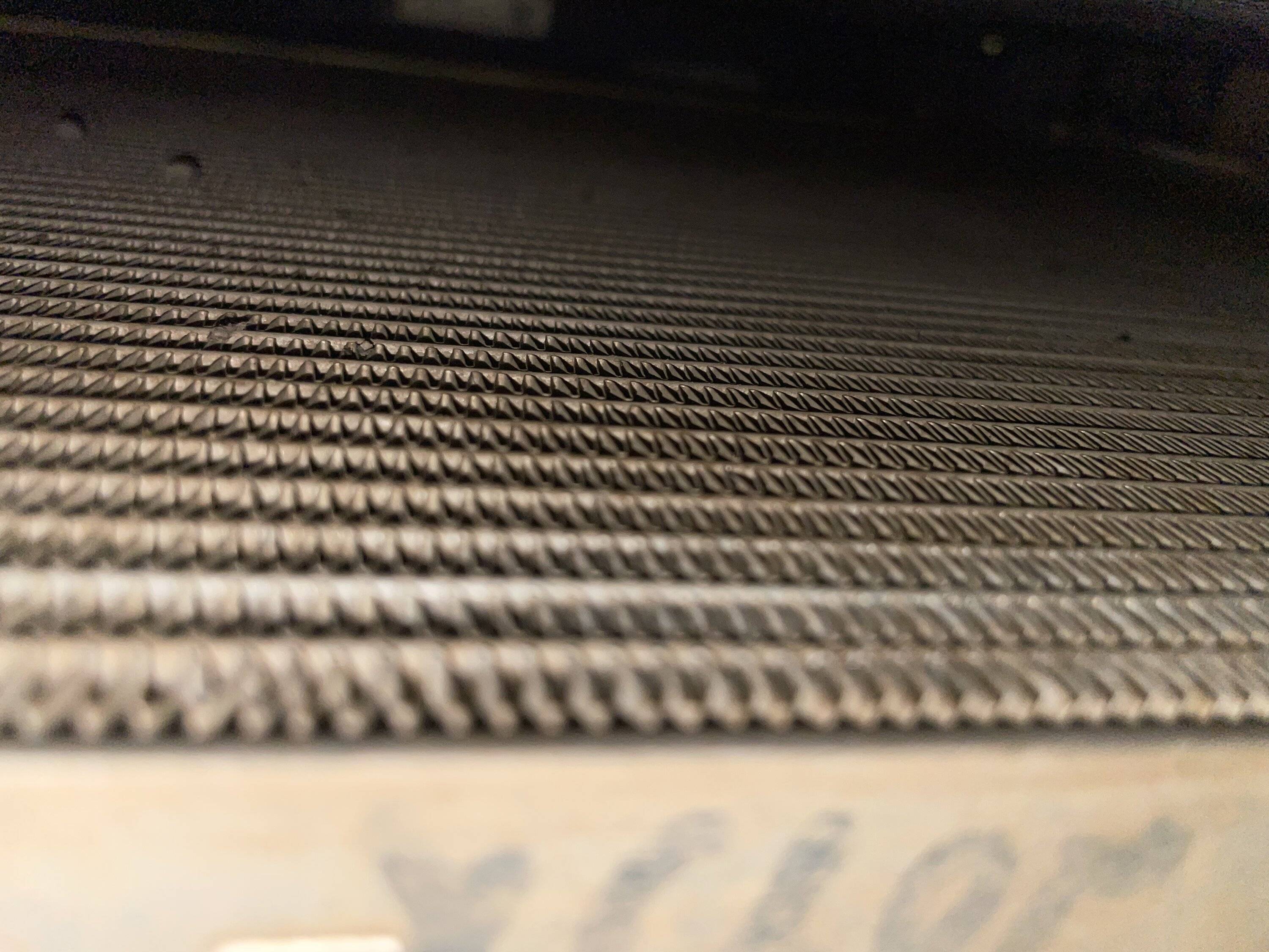

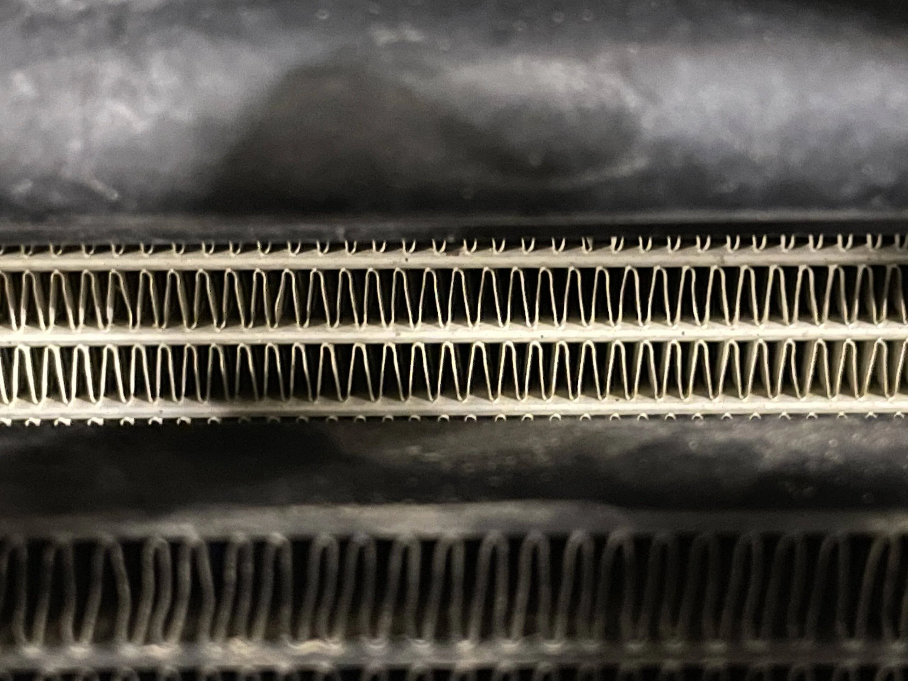

Welp, I got some pics of radiator - top few inches are caked in mud - washing may have helped clean the lower parts out - last pic is top - other pic is middle - then also a pic from the bottom up

yep get er clean ur ac is going work better too!! if ocd compels u get those fins straight .Also get some of ac coil cleaner in there
I'm thinking ill just hose it off as much as I can, and if that doesn't solve the issue I'll replace the flush the coolant & replace the radiator
The big black one in front is the AC correct? and the little black one in front & above is the power steering correct?
Could just the top few inches of it being full of mud cause much higher temps???

the bottom photos look pretty darn nasty .. give it the hose if this helps now u know ...the front is the ac condenser ..it doesnt matter if u dont know which is which ...all should be clean ..make clean everything make clean... its at least part of ur problem to say the least.. u should notice a difference but how much.. only u will find out.

Well, this may be a good sign. Stress the system out, and let us know if cleaning the radiator. Worked.
