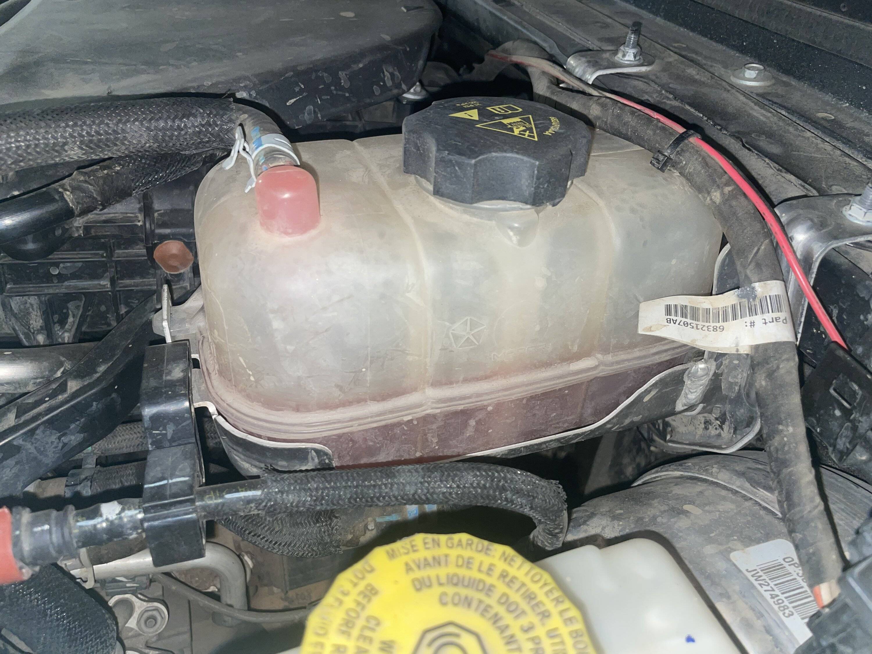

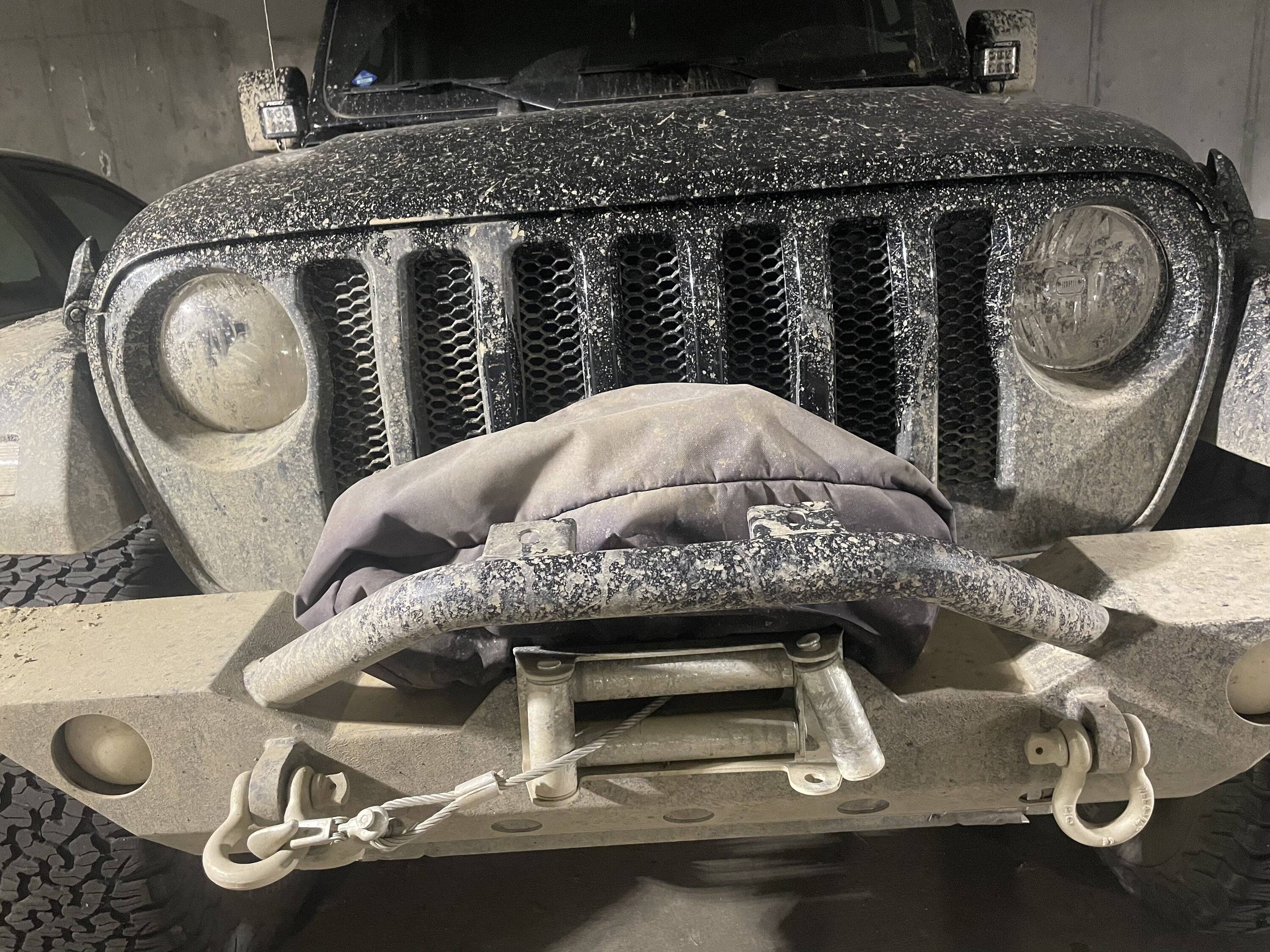

I’ve attached a picture of the coolant reservoir & the front of the grille (yes I know the winch rollers are broken)
